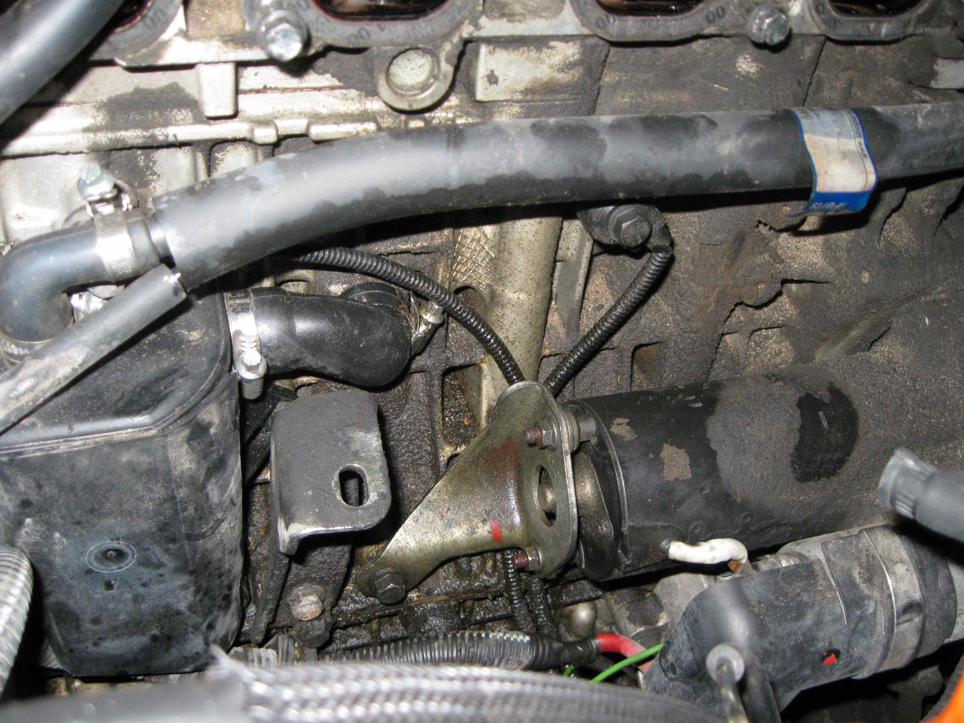

Tonight I set about taking off the intake manifold (just like the PCV fix I did a couple months ago) to get a better look. Even with taking off the manifold there's just oil/gunk everywhere. If I had to guess, i'm thinking something to do with the PCV is leaking, but I can't really tell. Now I get to clean off everything behind the manifold, hook it all back up, run it and let it leak, and then take everything back off to take a look. Ugggh. I'm pretty sure that If I ran the engine with the manifold and everything else taken off I'd damage something pretty good.
Anyway, here's some pictures of what I saw when I took off the manifold. I did wipe off some oil/dirt from the top of the clamp of the short stubby PCV hose. It's kind of hard to see in the picture, but the highest spot with oil are the two wires wrapped in plastic going to two plugs/sensors on the engine. I have no idea what the plugs are for, but where they plug into the engine are more or less clean/dry. I think the wires are getting sprayed with oil somehow, so maybe the leak is low, but I can't tell because the oil is spraying up.
You can see the two wires in a "V" orientation that are the highest thing with oil on them.
Just another view. It is puzzling that the bottom of the long PCV hose (i think it connects to the PTC nipple?) has oil on the bottom. It might just be the degreaser I sprayed in though. It doesn't look as wet as it would be if it was the source of all the oil.
Anyway, I usually work nights but I have tonight off. So I'll report back in an hour or two when I have everything cleaned off (probably with new pictures so I can take a break from working).
If anyone has any requests of pictures (for their reference) of anything that's usually hidden either behind the manifold/fuel rail/ air box let me know, i'll have it open for a while.

Did the leak start right after you did the PCV? The reason I ask is that I'm wondering if the short stubby hose might have a leak where it attaches to the engine block. That seems to be the area where most of the oil is. You might check it for looseness or a crack. Also, was the block opening where that hose goes clean or might it be clogged?

Postby vantassell » Tue Aug 31, 2010 12:07 pm
Got It!!!!
So the moral of the story really should be "Don't over tighten screw type hose clamps"
It was that short stubby PCV hose. I guess I over tightened it when I put it on. Ooops. I guess now I know why Volvo uses those horrible claspy clamps
