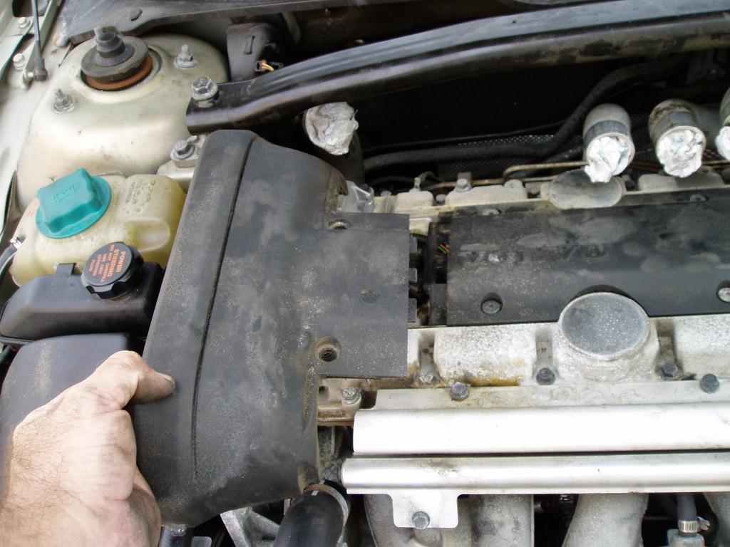

Postby vegasjetskier » 17 Jan 2009, 19:09
Help this site: Amazon.com link, Tirerack.com link, Donate

Postby s80lovenhate » 17 Jan 2009, 19:38
Nope, that is the upper cover. My problem is down by the crank and vibration damper. Do you have pictures of that??
