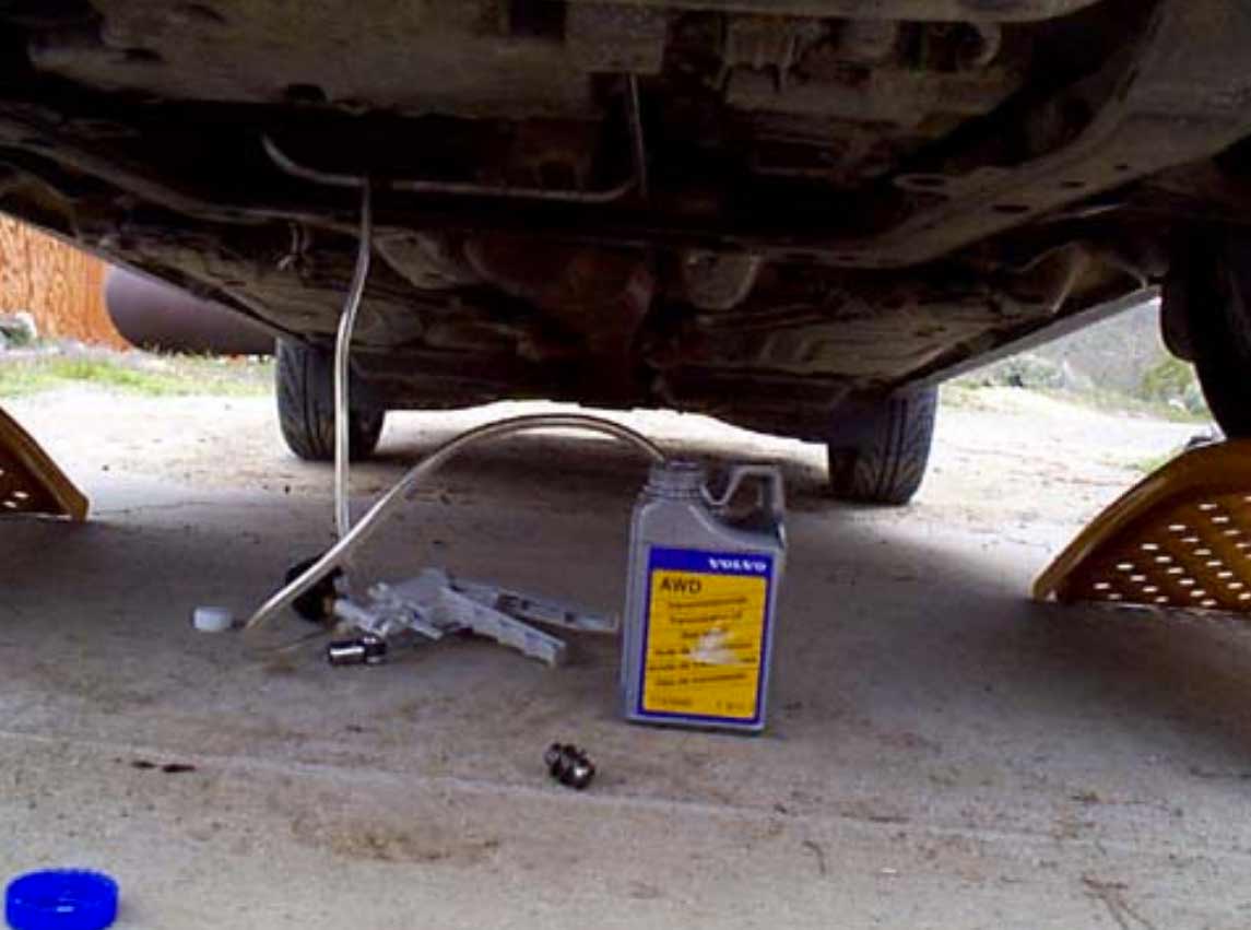

Here’s a downloadable PDF from V70XC.com on how to change bevel (angle) gear fluid on 1997-2002 model Volvo AWD cars. For 2003+, you have a Haldex system, and it’s got an additional fluid to maintain.
Unfortunately, no drain plug is provided! After a conversation with a Volvo service manager, who told me that they always install a drain plug in the housing (by drilling and tapping the aluminum case) at the 60K service (and change oil every 60K thereafter), I decided that it must be done on my car but without the drilling and tapping for a drain plug. What follows is the method I used.
