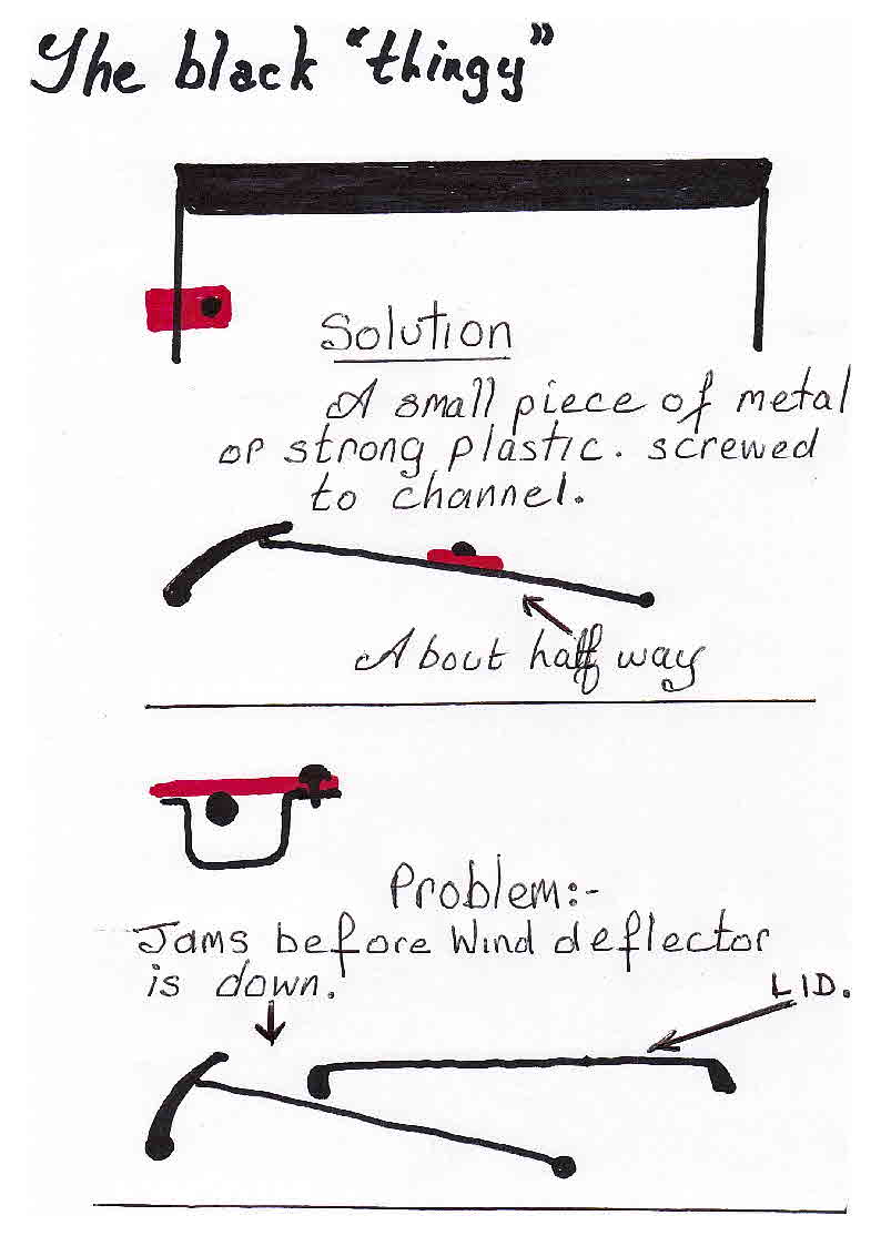

Sometimes you may notice that your sunroof is no longer closing correctly due to the wind deflector not closing before the roof slides into the closed position. It appears to be a common issue with our RWD Volvos, and a couple of different solutions can be used.
Inability to Close Sunroof :
