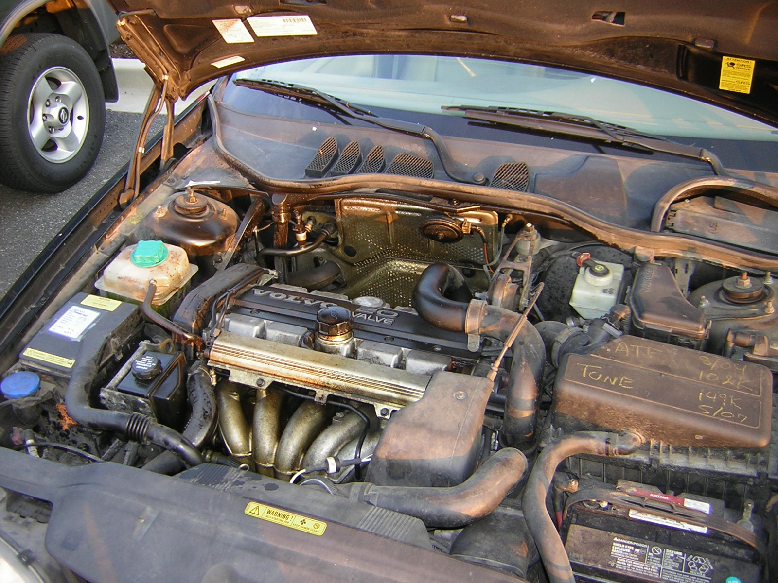

So I got picked up at BWI with the new ride this afternoon, took it back to my parents house. CEL light is on -as was known, put the OBD 2 on it and got a single code: 0410 – have been scouring the forums to find the list of codes posted but either I am not thinking right or a little to excited -still can’t find it, aarrgghhh; did searches and everything…. very frustrating! Anyone???
I had a little mishap already though, the ride from the airport was like 70 miles, couldn’t help myself had to goose it a little (I’ve been driving NA diesels for the past 11 years), do a little “Italian job”.
trading one dipstick for another
Well that was dumb. I think the car decided it didn’t need two dipsticks in it so it ejaculated it’s metallic one and let me keep driving. I thought I smelled a little oil but figured it was me overreacting to an odor from another car in the rush hour traffic. So when I got to a restaurant on the way ‘home’ I popped the hood (picture should be below). I’ll get under the car tomorrow to view the RMS, but I am holding out hope the dipstick was a relief. So gotta get a new dipstick tomorrow to make sure the oil level is OK. I don’t have time for a PCV replacement (I know that is what I NEED to do…) so I have a plan I will reveal in detail in my next post. First thing though I am gonna put Seafoam in the oil trap a la:

The P0410 is the secondary injection system fault…in other words, your secondary air pump is having trouble. It might be seized up or a blown hose on it…you’ll have to take a look. The SAS valve connected to it might also be bad. This shouldn’t have any effect on the driveability….just emissions and the car running with the wrong gas/air mixture when it first starts up. You really ought to deal with the PCV before you’re trip, even if you just clean the PCT Valve at the accordion hose and possibly even route that hose off to a catch can. With your dipstick blowing out, that’s a true warning sign. By the way, dipsticks were redesigned so you might have trouble getting an actual fit (the dealer will try to sell you the tube it goes in to). Best bet, if you have the old one, take it in and match it up with all of the 850 dipsticks the parts dept. should have laying around.
