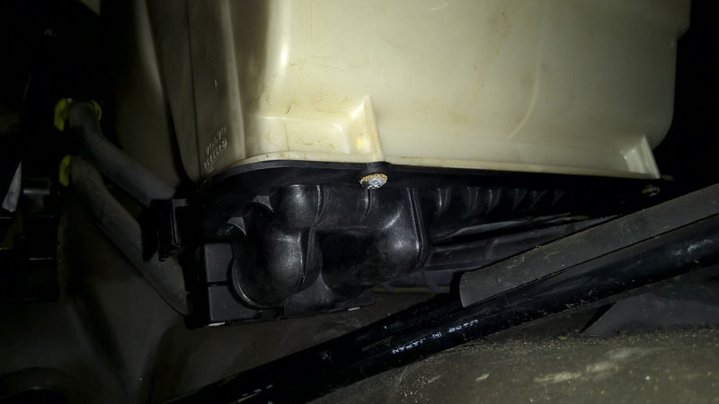

One question though, didn’t get around to the heater core swap. I had forgotten my Dremel and bought the wrong size hose clamps for the job. I opened up my cabin and saw this heater core. This is not OEM, correct?
Rockauto sells an ALLPRO heater core with a black plastic bottom  for $29.79. (So you know it’s gotta be good… sigh…)

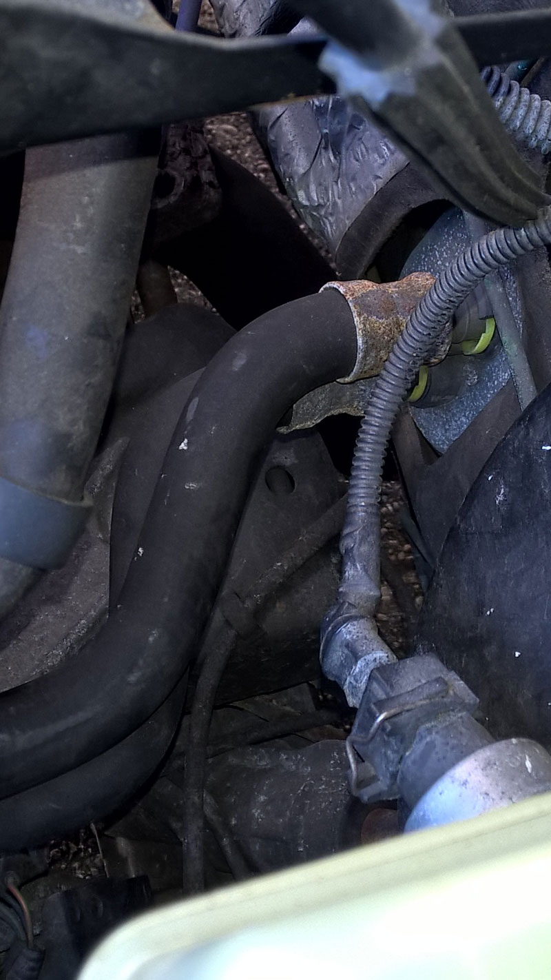

Also, my heater core hoses do not say Volvo on them anywhere… I’m thinking they’re probably URO right? Man, they feel so wimpy compared to every other hose on the car… I have to replace this one day. But my wife wanted her car back already… I’ll keep an eye on the heater core.
