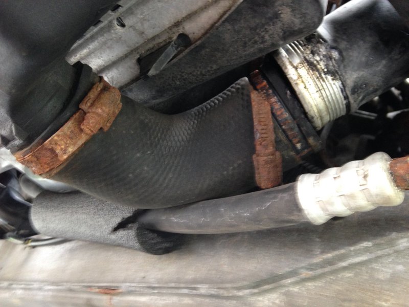

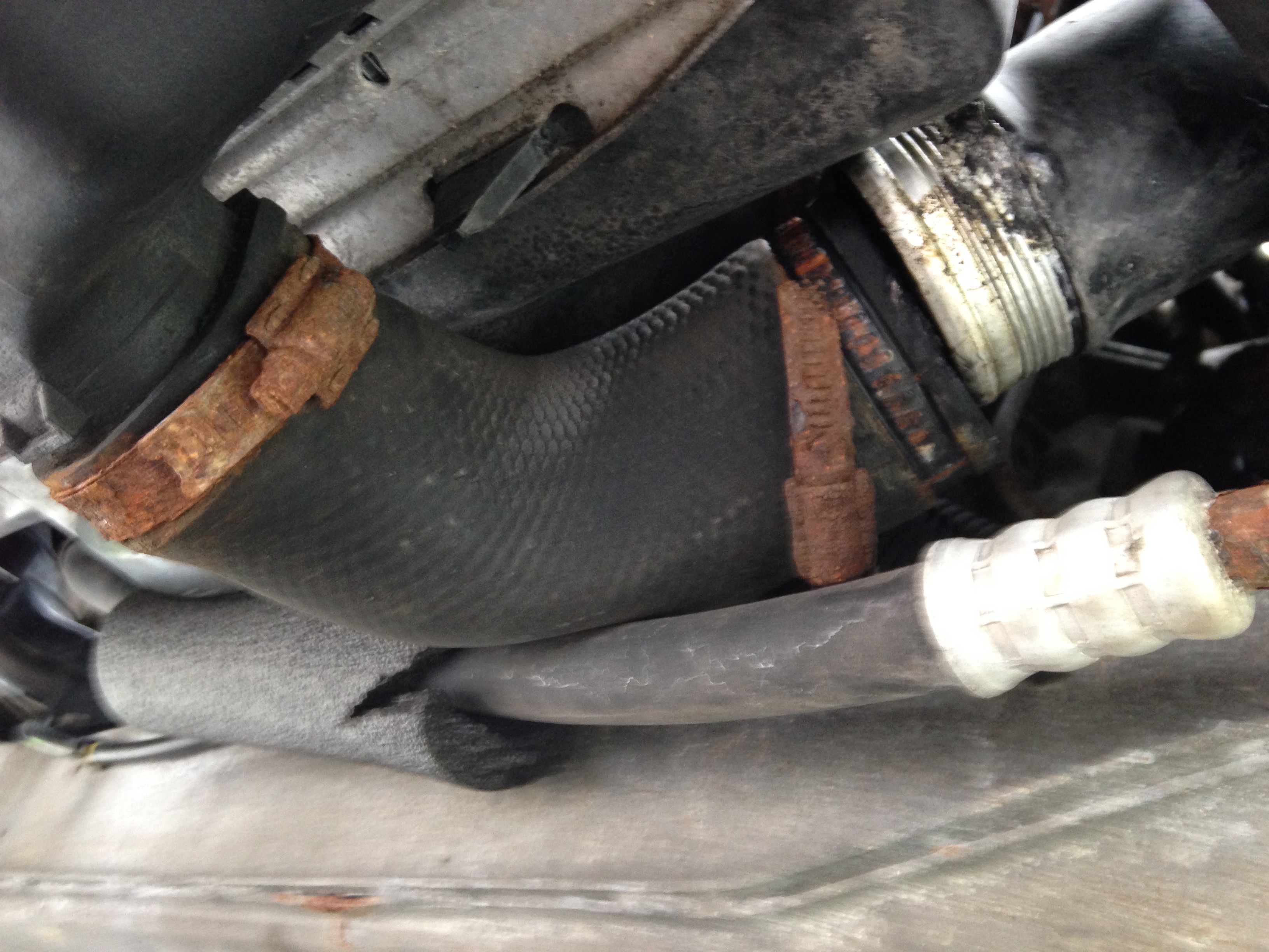

Well - using the new turbo whistle as a guide to check the induction, before replacing the MAF led me to..
Induction intercooler connection T5 1999
Reusing original clamp >> Rust through >> induction hose popped off >> MAF no longer reports accurate air inflow >> horrible running and CEL.
Disconnecting MAF hooks up ECU to rpm mapped fuel flow which works well.
Fix was 30 minutes labor and 5 bucks of SS hose clamps nice and tight.
