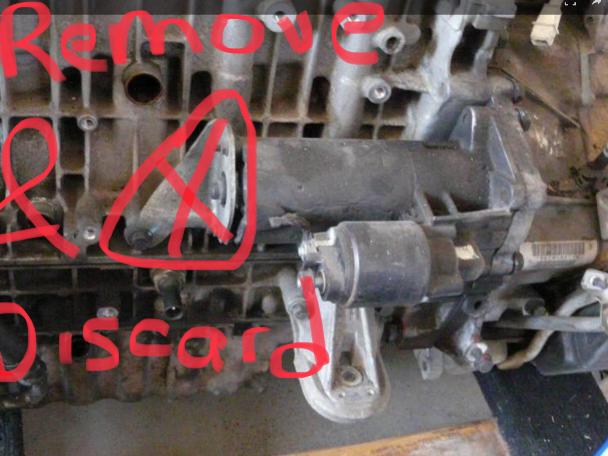

Hello, I recently changed the starter on my 2000 Volvo s70. In order to get the old starter out I had to take out a bracket mounting the back of the starter to the engine block. After putting in the new starter I realized I had to get these two nuts out of the old starter holding he bracket onto it. Long story short the nuts were frozen on and there’s no way I can get them out and i can’t get the bracket off the old starter without taking them out. Is the bracket even necessary? Some people says it gives it ground or whatever but I sharted it 3 times already no problems so can I go without it? Does the bracket help vibration? Help!

In 2002, apparently they either changed the starter/mounts/bell housing as....
(From Alldata)
Remove the front screw for the starter motor bracket.
Starter motor bracket withdrawn during model year 2002.
Disconnect the connector and cable for the solenoid.
Remove the screws (2 pcs) that hold the starter motor to the transmission.
Remove the starter motor.
(From Alldata)

Update
My volvo starter on my parts 1999 was brand new, and had no provision for the starter bracket.
I couldn't find a part number for this in Lisle or on my old crusted part. If anyone has one, please post here so I can title reference the thread

Found it in the Volvo Parts Catalog. Part Number: 9442201 and you can still get new ones for $8.70.abscate wrote: 16 Jan 2019, 04:11 I couldn't find a part number for this in Lisle or on my old crusted part. If anyone has one, please post here so I can title reference the thread

My tested one, covered with used engine oil to prevent corrosion, is only $18.70
Thanks Rick - added part numbers of obsolete and new part to thread title
