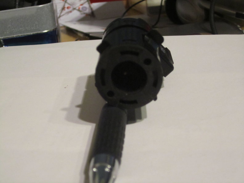

2) The cabin temperature sensor in the dash. It sits behind the little grille to the left of the ECC controller. To access it, pull the radio ( having code available), pull the ECC (you already know how to do that also). Now to the left of the ECC 'hole' sits a little fan assembly that sucks cabin air past a little temp. bead that adjusts the cabin temp appropriately to that set in auto mode. The little fan assembly clogs up with airborne 'stuff' and the fan stops drawing the air through. These units also fail. Removing it a swine if you haven't done it before. There are 2 compression clips on the body of it that need to be compressed to remove it from behind the dash and an electrical connector. I had one of these start to fail and this is the exact problem it caused.
If you are lucky, gentle cleaning with cotton buds and some IPA, and then a light spray of light oil can sometimes help if it is not too far gone.
In the 2nd picture (sorry they are a little blurred, no alcohol consumed in the taking), you can see one of the 2 compression clips. The 2nd is 180 degrees from there. Be patient and wear long sleeves as the ECC hole can be rough.
1) Fan motor varying, but as you would probably notice this it is most likely:

Steve, Neil, both you guys gave excellent advice. the clutch had indeed tossed a clip and was running (or sometimes not) on two. I'll fix this tomorrow--holiday stuff going on today.
I did remove the temp sensor and it had a whole lot of lint in there. I brushed it out with a little 1/8" tapered bottle-type brush. Afterwards the motor seemed to rotate more freely. I attempted to take the motor apart (5 tiny clips) to lubricate it. Not possible, since the temp sensor wires are threaded through the fan housing and then crimped and fused together, so not advisable to try that lest damage ensue to sensor.
Afterwards, the A/C was working and when I turned it off and set the blower fan speed to zero, I could hear the sensor fan running by getting my ear close to the grill. With a flashlight, I could observe it start and stop when the engine was started and turned off.
So as soon as I replace that lost clip, I fully expect everything to be copacetic once again. Many thanks for the expert guidance--and happy 4th of July!
