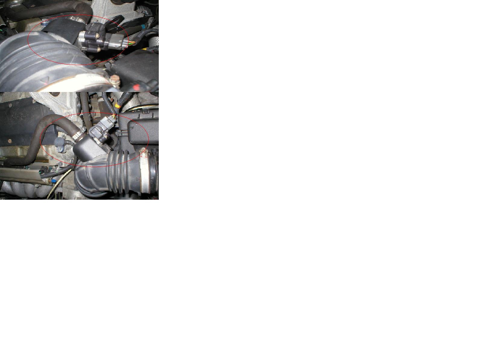

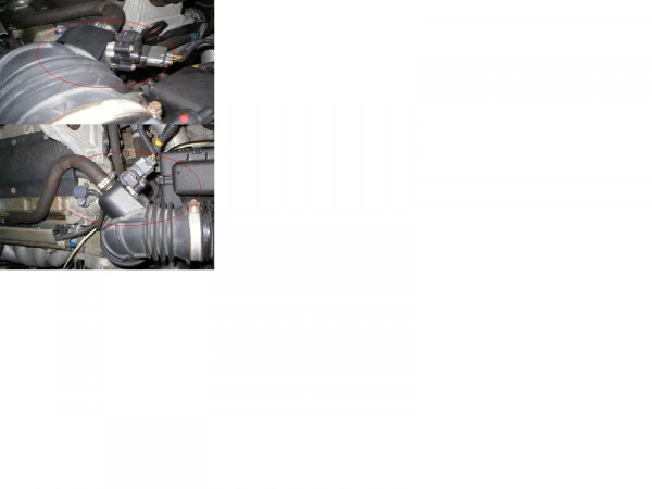

Yes there is fuel pressure each time we have checked it and the i believe the temp is normal. Though we havent been able to scan for codes yet the sms light is the only one on. It seems it has something to do with whatever the part is that is connected to the hose that goes into the engine(thats where the strange vibration is coming from). It seems like whatever is causing that vibration is stopping the fuel pump from working. Ive attached a photo showing where i'm talking about. As soon as we unplug that part or wait the vibration stops and the fuel pump will work on startup once more.

That's the idle control valve it looks like. Looks a LOT different than mine, but upon a closer look at your picture, that's what it is. It is supposed to make a buzzing noise with the key turned on, that's normal. But it shouldn't stop the fuel pump from running.
What kind of fuel pressure are you getting WHILE CRANKING?
Are your plugs sparking? Just pull out one...with the direct ignition you have that should be enough. Lay it on top of the engine and look for a spark while it's being cranked. If it doesn't fire, you may actually have a bad crank or cam position sensor.
