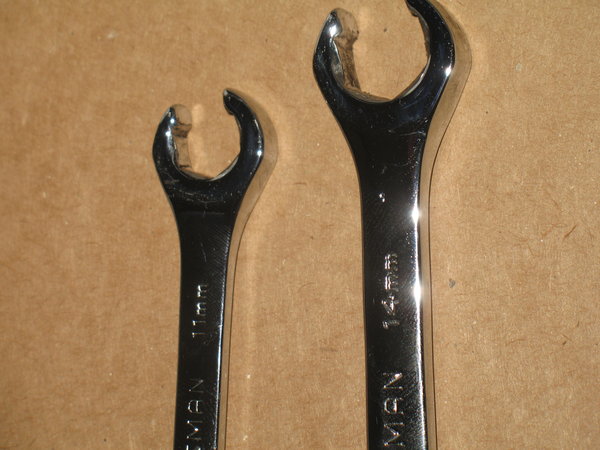

Flare Wrenches: I was surprised that I used so many sizes. I used 11 and 14 mm for the hard line to flex hose connection, 14 mm on the old flex hose at the caliper, and 10 mm for the bleeder valve on the passenger-side caliper which I did not replace. For the new drivers-side caliper, the bleeder valve was 8mm. The new flex hose itself used 15 mm at the caliper and 14 mm at the hard line connection.
These are Flare Wrenches

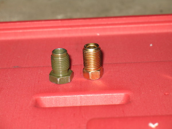

Nut information: Pay careful attention to the nut you purchase. There are (at least) two nuts that have the same threading but are slightly different:
“3/16 in. tube size to M10 - 1.0 thread inverted flare Japanese steel tube nut”
“3/16 in. tube size to M10 - 1.0 thread bubble flare European steel tube nut”
European (left) and Janapese (right) Nuts
I took my SS lines to the store and asked for nuts that would fit. I got the Japanese type, without knowing there’s a difference. The Japanese version is slightly longer than the European version, and the tip under the flare is shaped different.

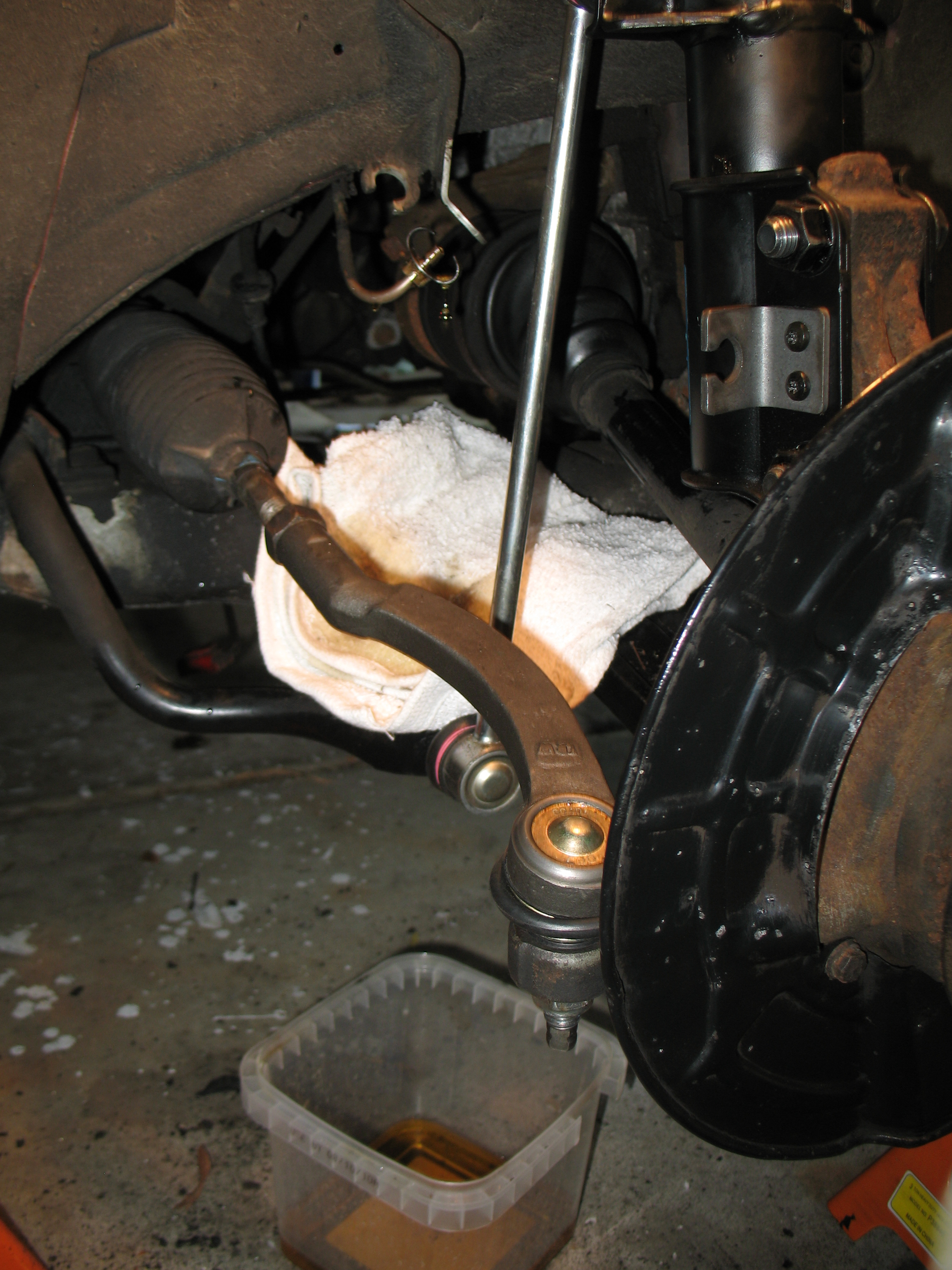

Place a rag under the brake line where you’ll cut, and place the small bucket under that. This will help to catch the fluid that drips out, with the rag acting as a funnel.
Rag & Bucket to catch the dripping fluid

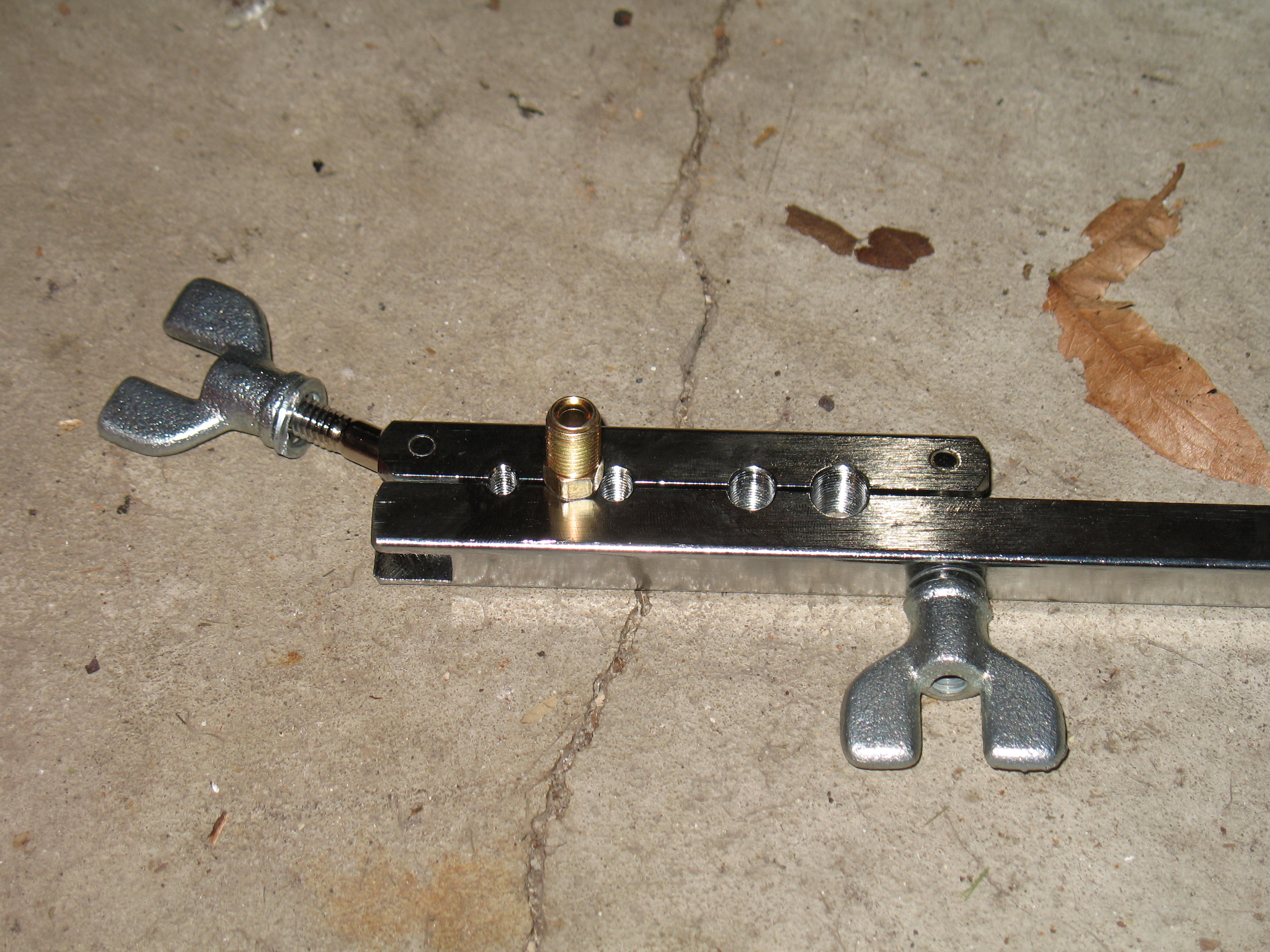

I STRONGLY SUGGEST placing the nut on top of the flaring clamp, just to make sure you don’t forget to put it on the line before you start the flare.
Nut is on the clamp for a good reason!

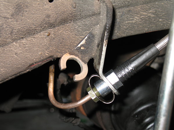

First, begin cutting the line. Using the small hacksaw blade, begin cutting the line inside the spring, as opposed to cutting the line on the back side of the nut. Cutting on the inside of the spring will help improve the flatness of the cut as well as provide a little extra length of the pipe. Using a gentle pressure will allow the spring to help guide the blade in a straighter line as well as preventing the blade from binding as you cut. Once you cut the inside of the hose, fluid will start to leak out. Things will get slippery very quickly. Once you cut through the hose completely, the hose will spring apart and fling fluid around. This is where the safety glasses are important – you do not want that stuff in your eyes!
Cutting the line on the inside of the spring clip
Hard line has been cut

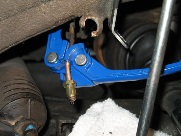

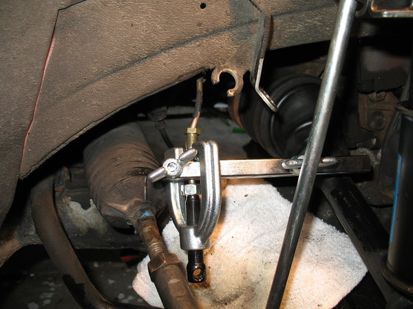

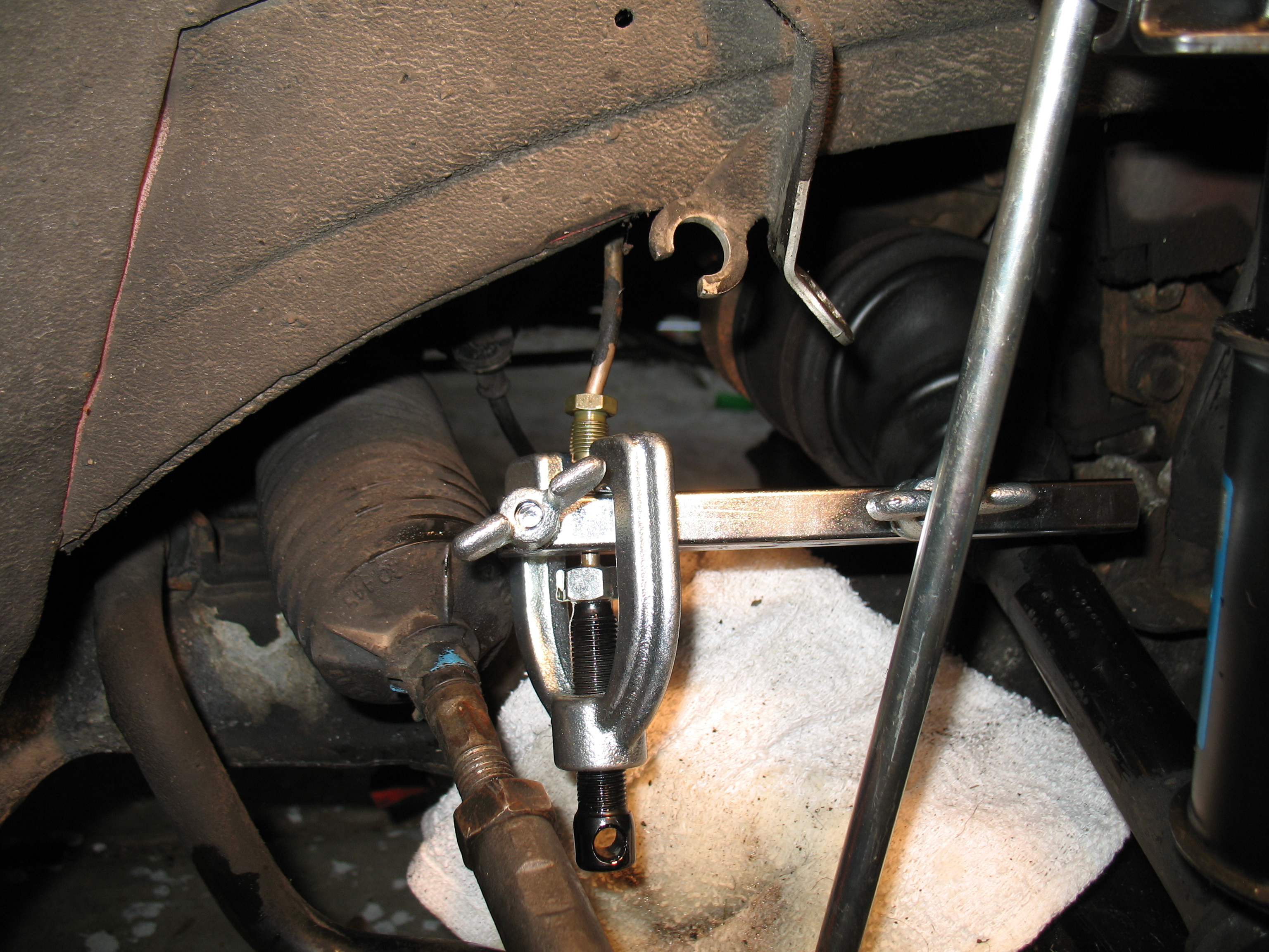

Place the clamp on the hose and check the gap for the proper distance from the end for the flare. When clamping the hose, start by tightening the nut closest to the hose, and then clamp down the far nut. This tightening doesn’t have to be painfully tight because of the clamp I used. It has small teeth inside the hole and will grip the hose very well. Use the twisting handle on the nuts and it should be fine. Tighten it too much and you’ll screw up your washers – which I did during my practice time.
Place the flare bolt on the clamp and tighten it, making sure to hold the clamp very still, otherwise you’ll place tension on the hose and possibly kink it. Take your time to make sure you’re applying steady pressure. When the flaring nut has stopped moving, you’re done.
Flaring the hose
Flaring the hose
Once the flare has been made, do not remove the tool just yet. Since the fluid is not leaking out right now, check the level in the fluid reservoir and refill as necessary. Make sure you do not touch your paint or lean on your car as the brake fluid will eat paint. You can also take a moment to clean any mess if you wish. Remember, you’re only half done but you’re done with the hardest part.

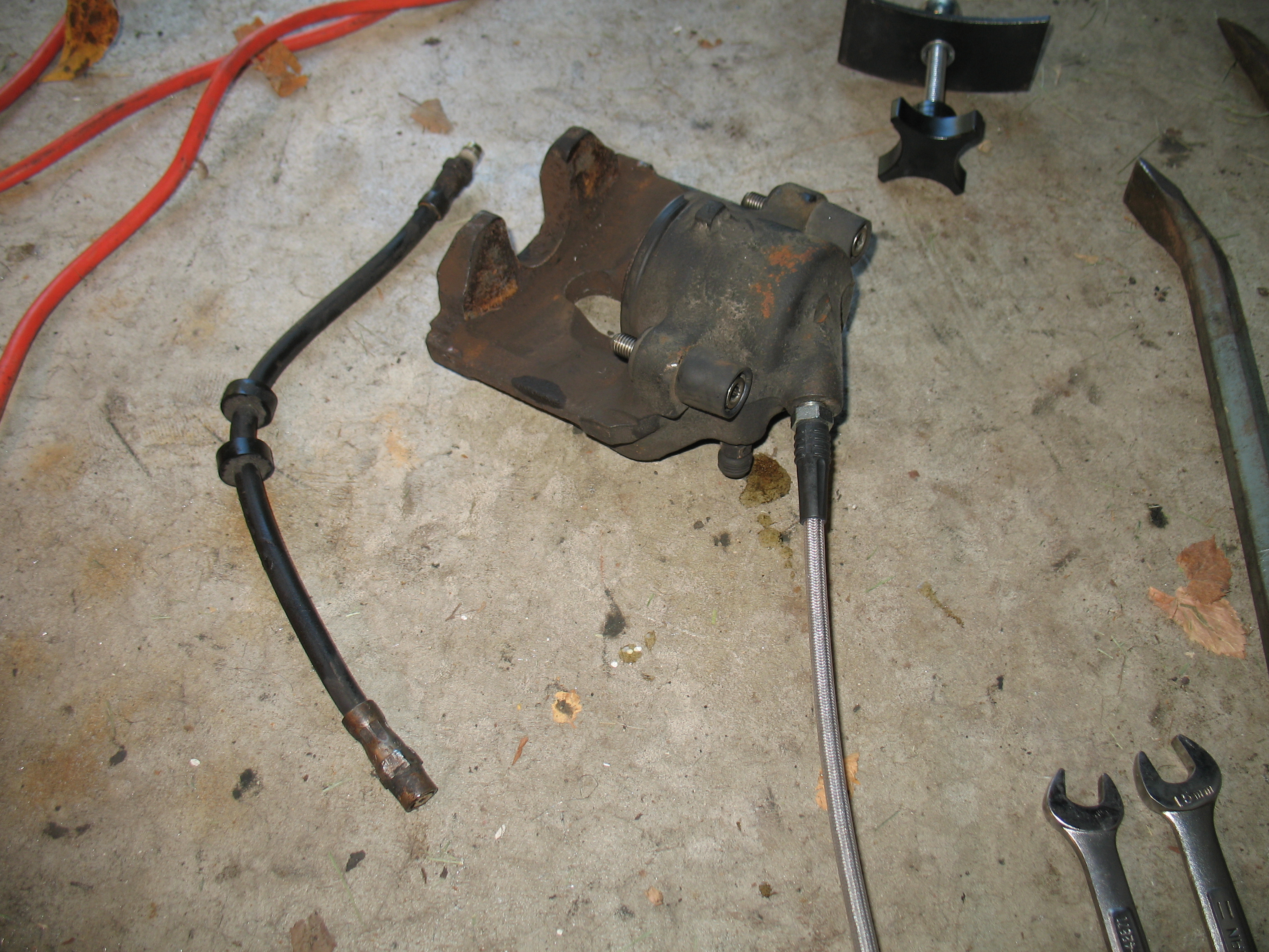

Also make sure your caliper is within reach. Install the flex hose onto the caliper and place the caliper in its normal operating position. This is important so you can install the hose properly.
Attach the Flex Hose to the Caliper First

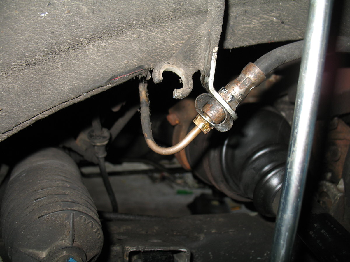

There isn’t much twist available in the flex hose, so you need to place the end that connects to the hard line into the star bracket and screw the new nut into the flex hose.
Time to remove the flaring tool and bend the hose back into place. Take your time so as not to kink it.
Carefully bend the hose back into place
Place the spring clip in position.
Spring Clip in place and ready for connection
Insert the flex hose into the bracket.
Groved Bracket for Flex Hose

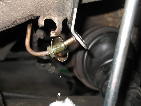

Remember; when you put the 14-mm flare wrench onto the end of the flex hose, it’s not to twist it, it’s just to keep it from moving. You will only be moving the nut you just installed.
Begin by holding the flex hose in position and pushing the new nut into it. Becase the spring clip is in place, it may take a bit of effort to get everything aligned and connected.
Hoses connected - no more dripping fluid!

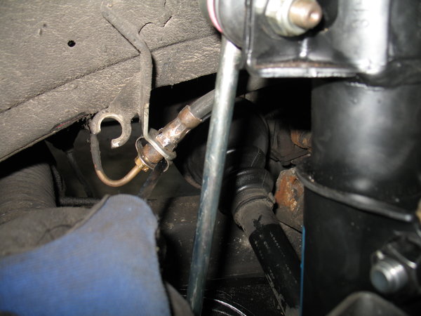

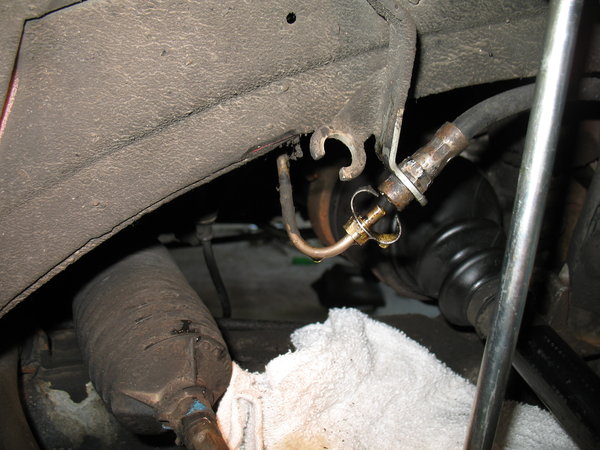

Just wanted to say thanks to Vjaneczko for this beautiful post -- I know it was originally done up a few years ago and the thread is older but the information is timeless and the photographs and descriptions are great.
I was searching for information on ISO bubble flare nuts, flaring tools, copper nickel hard brake lines, flex brake lines and everything I could find about brake lines in general for the Volvo because the front rubber flex brake lines on my '97 855 GLT have finally reached the point where they must be replaced:
Cracks in the rubber outer casing of the brake line
Brake Line 01.jpg (106.77 KiB) Viewed 17911 times
I've got the parts on order from DW Volvo in TN and will post later as I get into the repair. For now, I have cleaned up the lines with a brass wire brush and judicious use of brake cleaner spray on the metal fittings only, applied a little P'Blaster, and used 11 and 14mm flare nut wrenches to see if I could loosen the flare nuts. So far, so good! I was able to loosen them without binding.

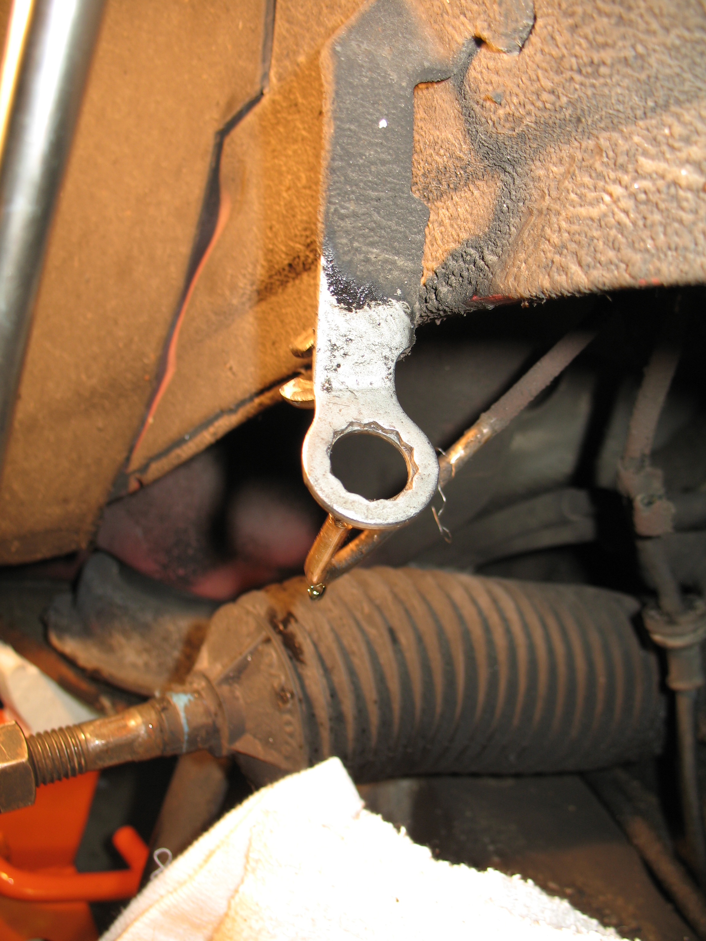

Counterholding with the 14mm flare nut wrench while twisting with the 11mm.
Brake Line 02.jpg (135.93 KiB) Viewed 17911 times
I only loosened up the flare nuts slightly at both ends to see if they were stuck, then I tightened them back up until I get the new lines in.
