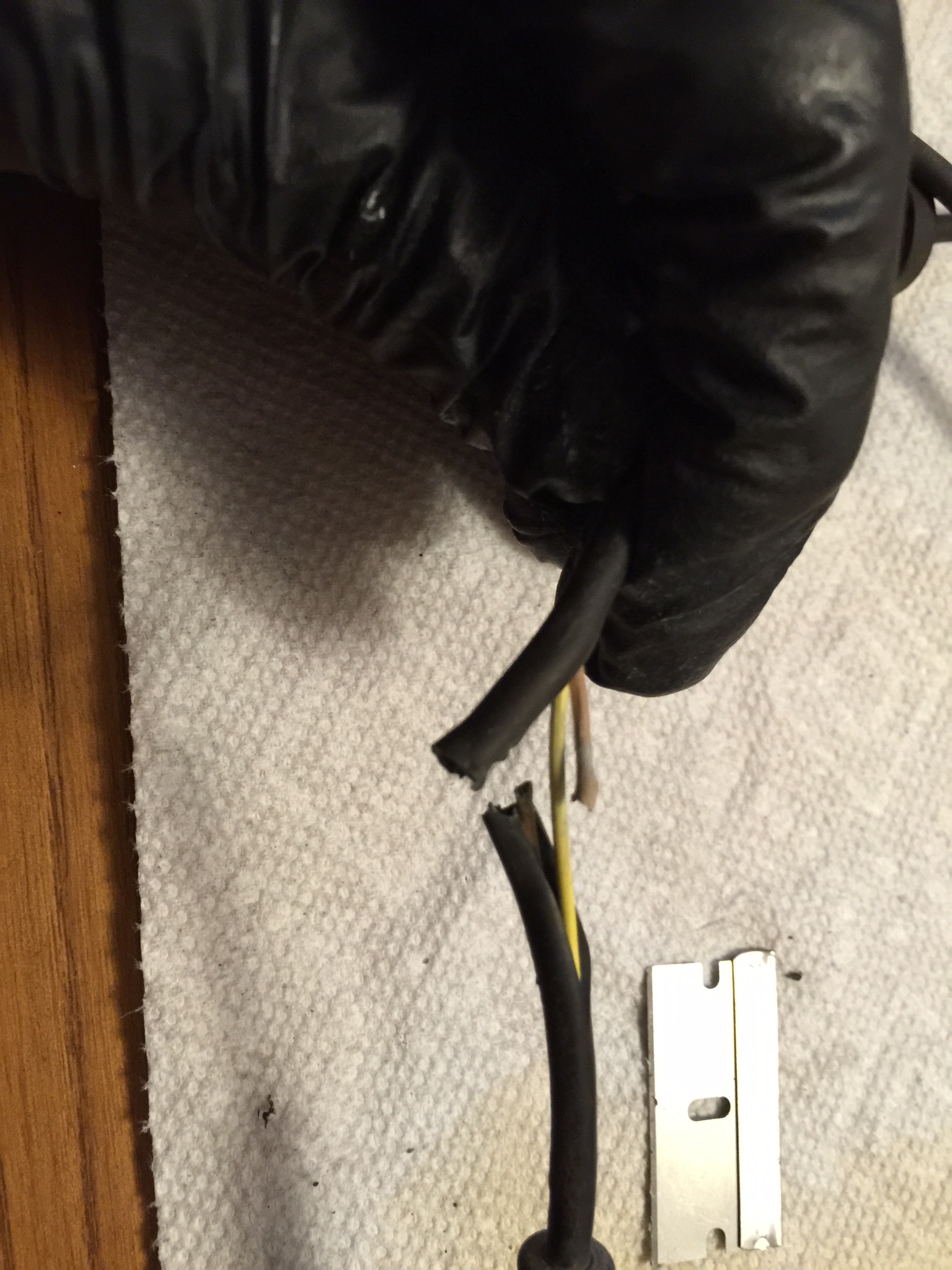

It's really easy to break those sensor wires when you work on the hubs Russ. I just pulled mine a bit too much and separated the wire inside the sheath, no visual.

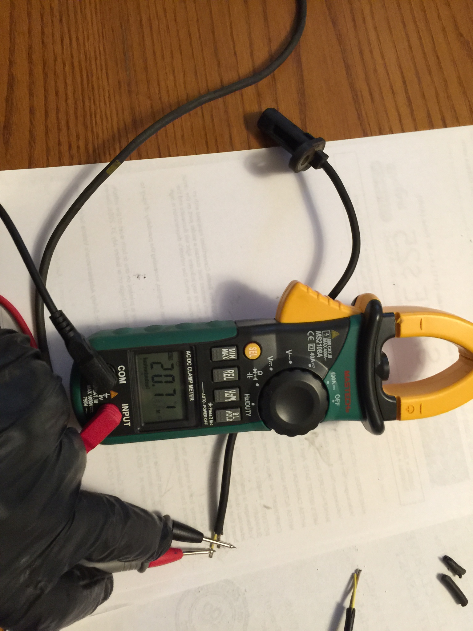

Easy to check continuity on the connector as it's nicely next to the shock towers...you don't even have to go underneath? 2000 ohms +_ 10% for an ABS sensor I think?

Damn, just checked resistance with my meter, one measures in the meg-ohm scale.
EDIT: did some more investigating. The actual sensor for one wheel is bad. The wiring checks out OK

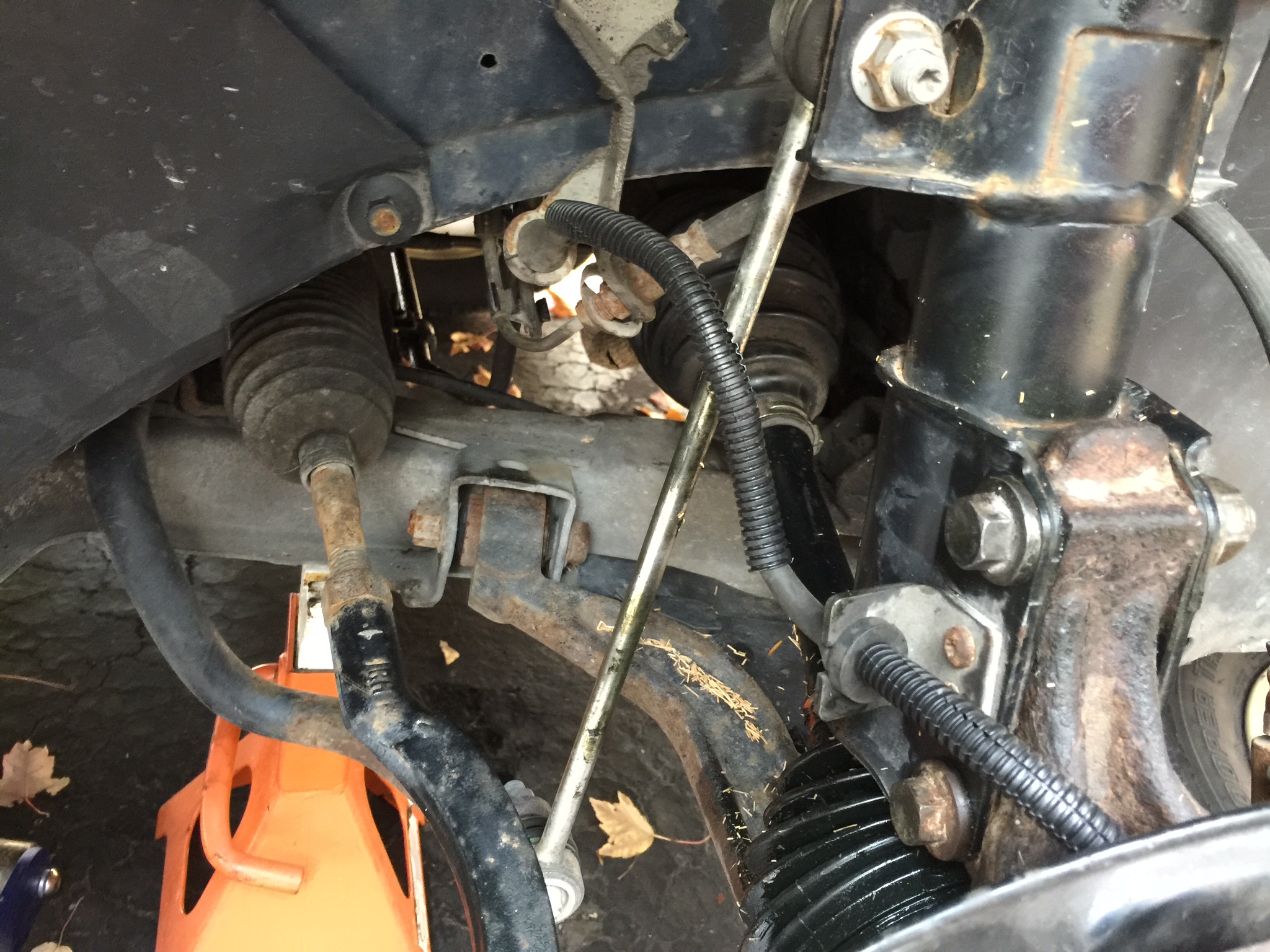

The front sensor's are relatively easy to replace. The rear is a bit tricky but I used a piece of string tied to the old sensor to route it properly. Ebay has some amazing deals, which I used for the rear sensor. 1yr in, and so far so good as the sensors are relatively simple.

I already pulled both sensors. One was fine, the other had a connectivity problem right where the wire enters the sensor. I peeled the insulation off the wire about 3" back from the sensor, and re-soldered the wiring harness to it. As long as the wires from the sensor are vertical, it seems to work. This a very temporary fix, the new one has been ordered
