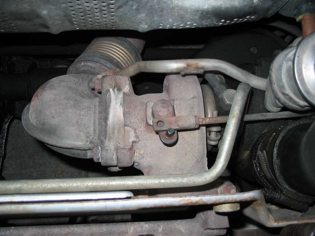

While removing the turbo heat shield, I noticed the lower, pass-side retaining bolt was bent. Odd that as I've owned this car since 11,000mi, nearly 17 years, and have never removed the heat shield. Removal was straightforward however, and soon I was looking at the top side of the turbocharger. I unclipped the actuator rod from the WG arm, moved it off to one side and saw this:

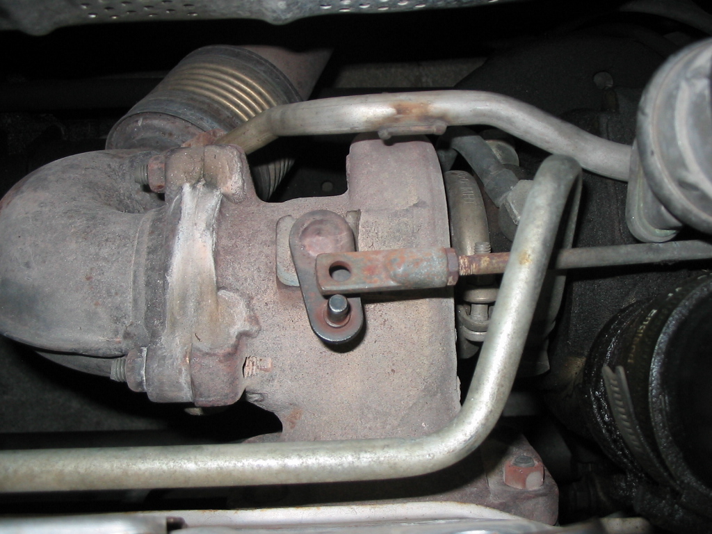

According to a dial indicator, I have to pull out the rod about 0.07" (2mm) in order to slide the hole over the pin.

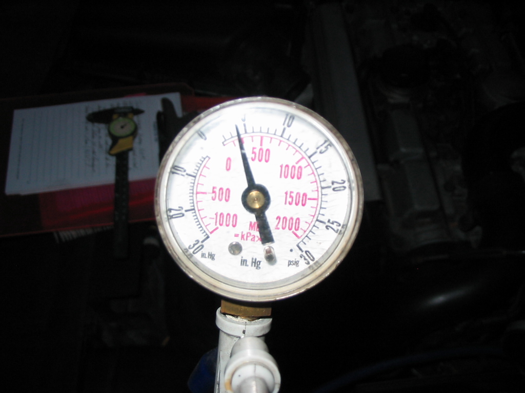

Next, I applied 4psi, made sure the WG was fully closed, and saw this:
In order to slide the hole over the pin, the arm needs to be shortened 0.285" (7mm)! That's quite a lot! We're way beyond 2 turns here! I marked the top of the jamb nut and began turning it CW, following up with the flattened end tab as I went, checking to see when I could easily drop it over the pin. It took 7 turns. However the inner tab threads bottomed out and I was unable to fully turn it all the way so it snugged up tight to the nut. So I had to turn the jamb nut about 1-1/2 turns CCW to "jamb" it tight against the tab. Point is the adjustment rod is STILL too long...not by much but the fact remains.
I checked everything two more times: The pressure regulator, gauge, etc. to triple-check my work. It still came up the same. And I was using 4psi, not 4.4psi.

I think you will be lucky if that gauge reads +_ 5% full scale or 1.5 psi error.

So what "turbo gauge" did you use that's more accurate? Does it have a calibration certificate?
Didn't have time to build a water manometer big enough nor do I have Hg to build a smaller one. 1 psi = 27.7 IWC so 4.4 psi is 122 IWC. Half that is 61", so that's a rather tall water manometer. It would be very, very accurate though......

I had a brain fart - a Class B gauge is typically 3% full scale.
I use the IPD gauge which is 15 psi full scale, so error of roughly 0.3 psi in the area of measurement needed.

Did some reading up on this and you make a good point. Researched low-pressure gauges and noticed several mentions of "Class B" and higher specs.abscate wrote:... a Class B gauge is typically 3% full scale. I use the IPD gauge which is 15 psi full scale, so error of roughly 0.3 psi in the area of measurement needed.
