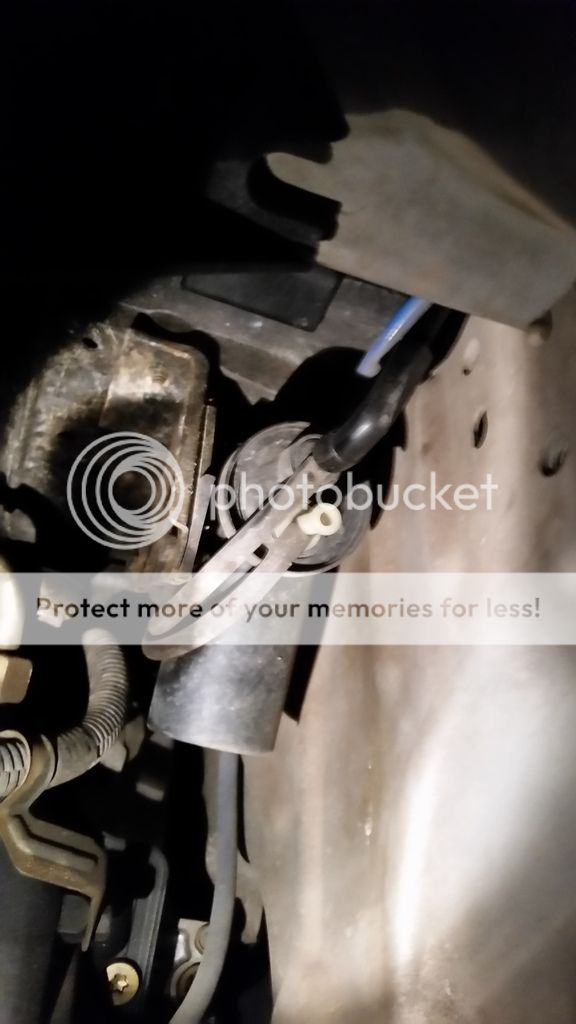

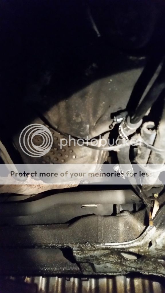

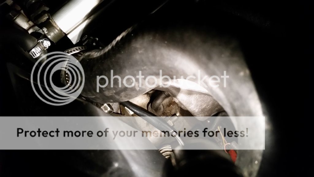

I have been thinking of attempting a home made smoke test. When my car stalled out coming to a stop it happened to be the first drive after I filled up my gas tank this led me to believe it was EVAP related. I forgot to mention that. Upon inspection of the system the rubber joint before purge valve was cracked on both ends and probably had a significant leak. A hard black vacuum line that was zip tied to the fuel line a little north of the fuel filter was completley disconnected at a joint in the middle of the car. The third major leak (which I may actually have pulled loose at some point) was whatever that odd thing under the battery tray is where one line goes in and has some lines that go from and back into itself and it looks like it has a valve or vent on it was disconnected too.abscate wrote: ↑24 May 2017, 04:00 Pull the plugs and look at them for a diagnostic of running. Thhen compression test to check valves and rings.

This is that thing I was trying to explain under the battery box. That is what was disconnected.
This was the old line I was talking about by the fuel filter that was completely disconnected too. You can see the old one to the right that was sitting like that with only one side even in.
And.... Oh, yes...... That connector is in tact too before anyone says it.
