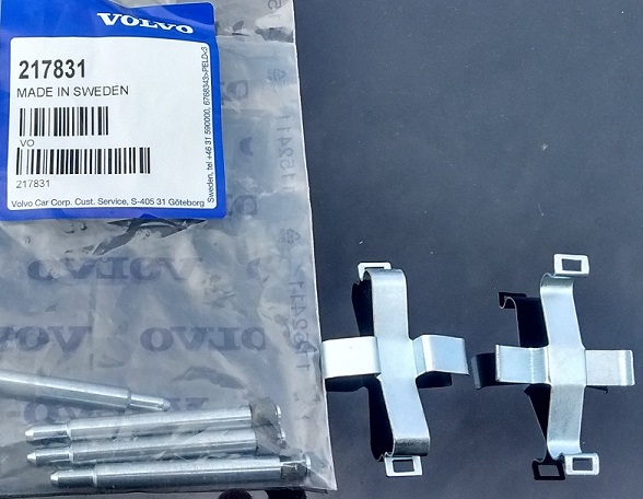

7 months have gone by, another winter, and I took a look at the rear pads - amazing
hardly any wear at all, maybe 1/16" gone with all 4 pads about the same. These are
NAPA premium and I think that they have a bit more clearance so that they don't drag.
These had factory rear hardware that we reused the last time we worked on the rears,
since I couldn't find an exact match after trying a few auto parts stores. I decided to buy
Volvo hardware and see what it looked like, not inexpensive at around $40. I was in such
a rush to put these in today that I forgot to see if they work like the older original Volvo
hardware. I'll look at the contact points next time the car is here for more work:
