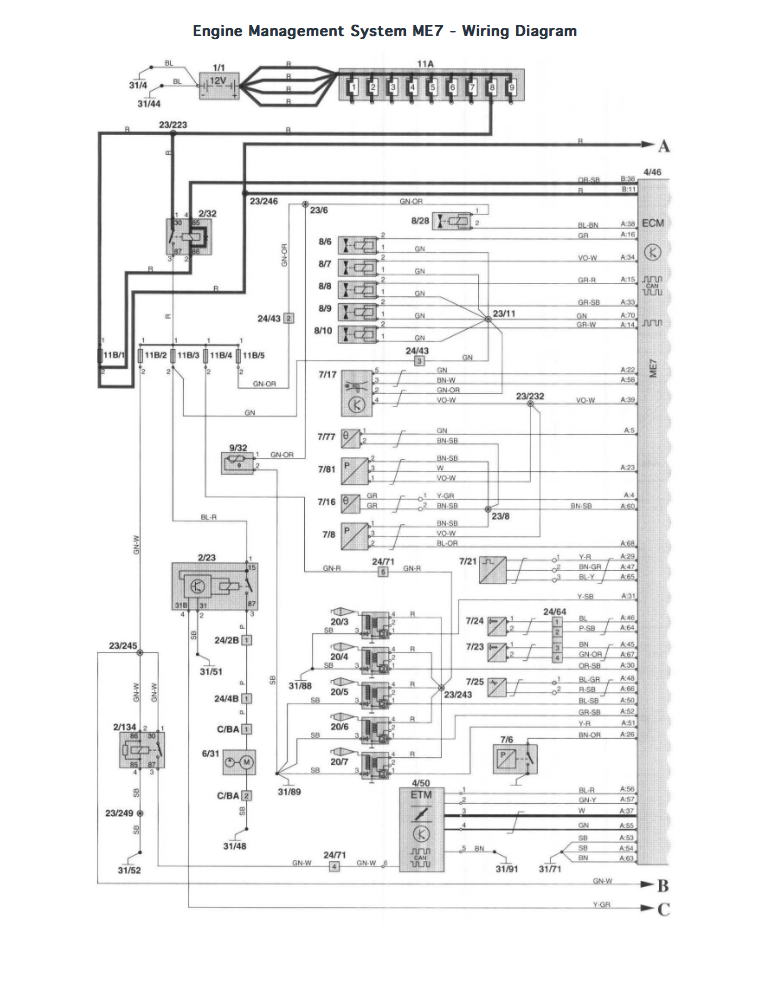

YEah, thats why I think it is not that sensor. What about coil voltage - can you monitor the 12V to the coils and FIJ? Those are supposed to be on 12V all the time, and are fired by grounding by the ECU
Check the relays in this diagram...
