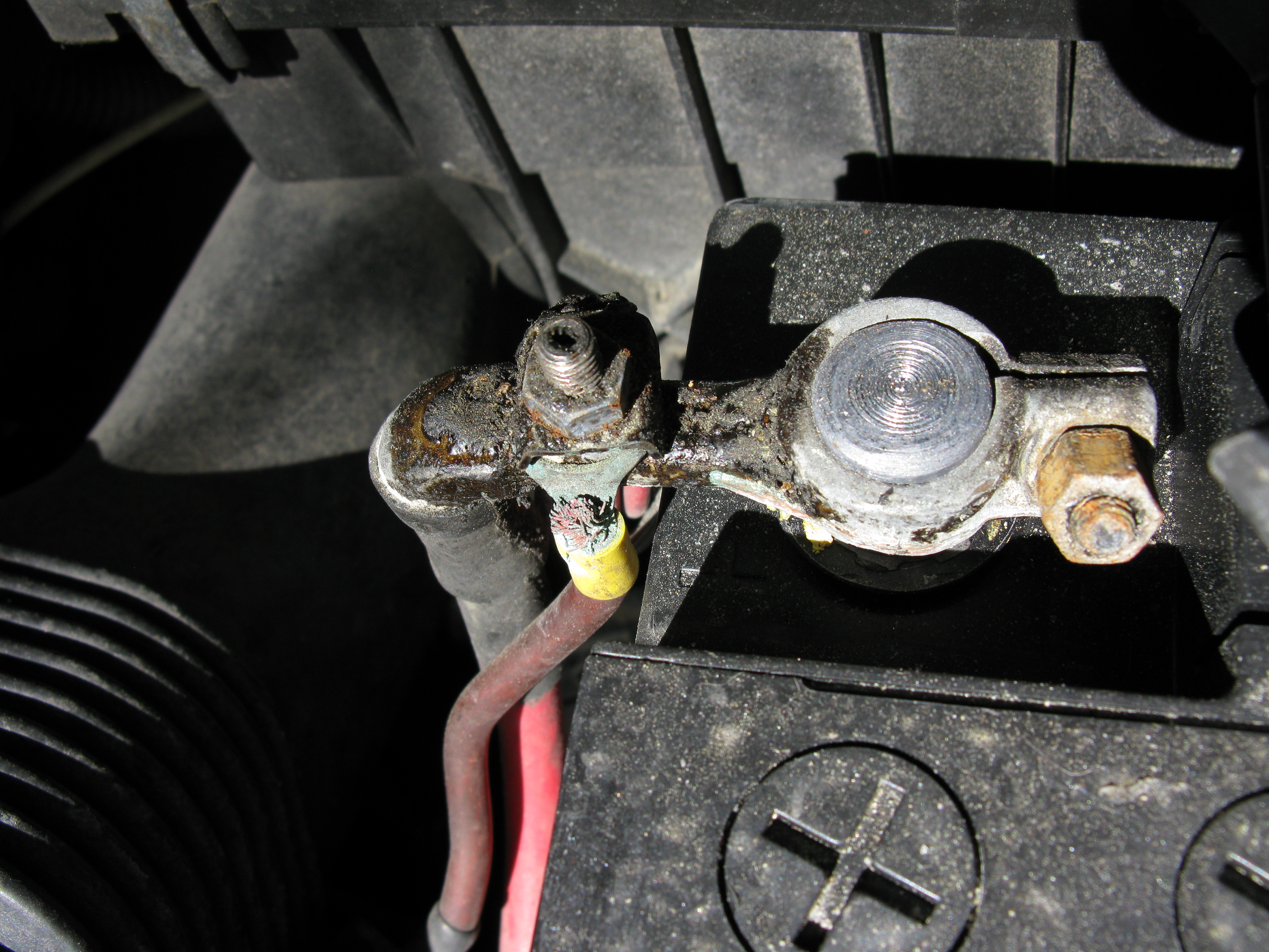

Since another thread warned about "arc welding" when trying this remote start, I bought a remote starter switch from the local auto parts store. I added pictures to the remote start thread linked above.
I was not able to start the car in any of the many configurations that I tried. The Acton brand remote starter has nice alligator clips, but they're almost too big to fit on the white terminal and on the starter's terminal with the red/green wire. I tried them in both of those spots with the other clip on the positive battery post. I had the key in the ignition set to off, I, and II. None of these worked.

Another thread blamed a loose nut on their positive battery cable for serious intermittent problems. My positive cable has been covered in black goop for seven years but has always worked. I may try to clean it.

If it isn't cranking with 12VDC on the remote terminal, your starter is bad. It could be the battery to starter cable, which does look bad in Your picture.
Either way, starter should come out
