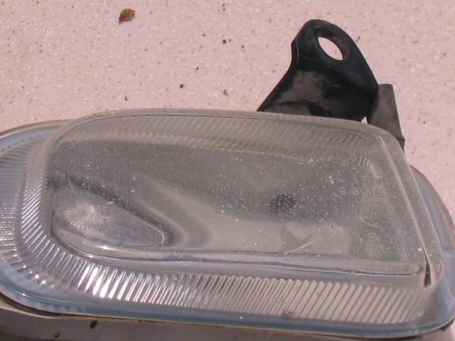

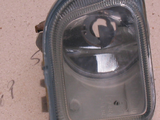

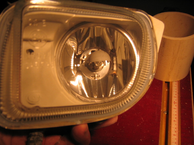

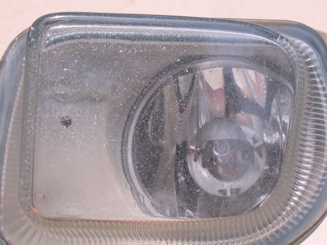

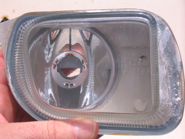

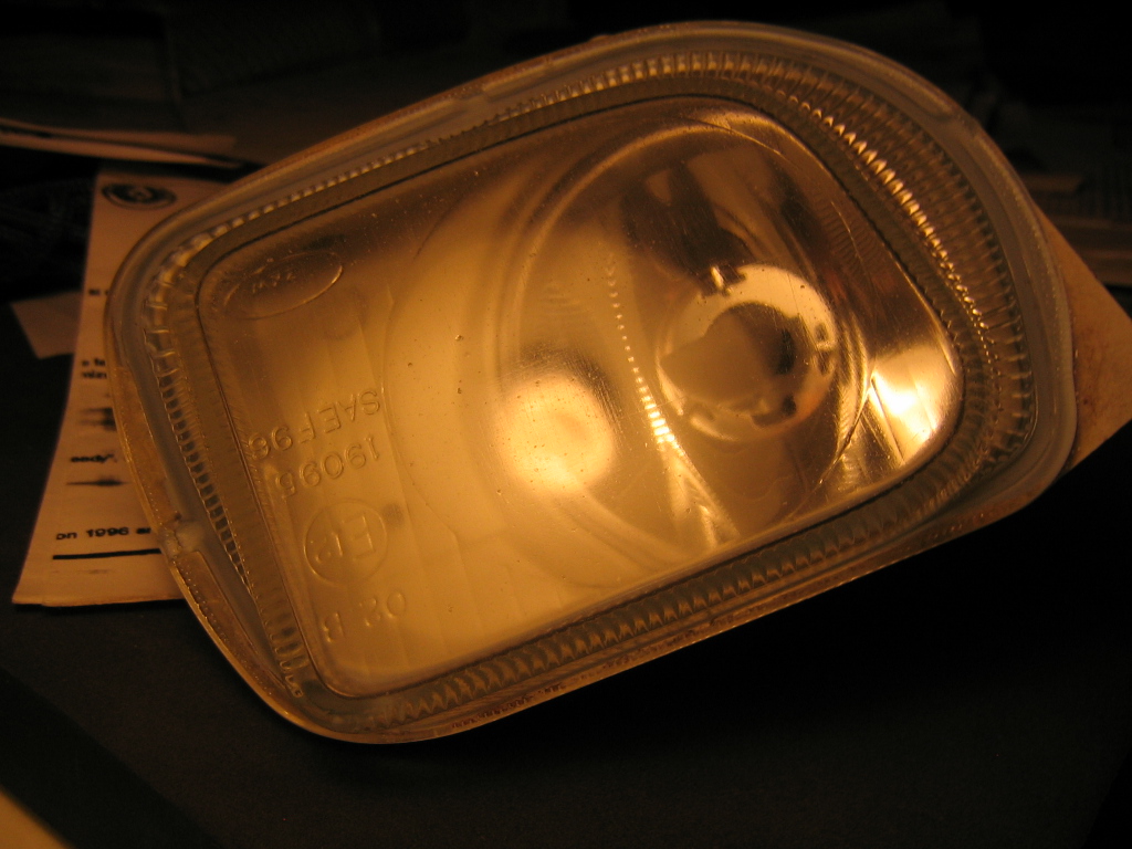

The glass lenses were badly pitted so I wanted to try polishing them before adding a protective film.
Volvo_Fog Light Lenses 001.JPG (160.21 KiB) Viewed 1905 times
Volvo_Fog Light Lenses 005.JPG (180.38 KiB) Viewed 1905 times
I started off with a RO 6" sander. This proved frustrating however because the pad isn't directly driven. However, it's what I had on hand + quite a range of assorted grit hook-n-loop paper to use with it. My goal wasn't to grind down to perfect glass, rather to remove the thousands of small tiny ones that pot-marked the surface as shown above.

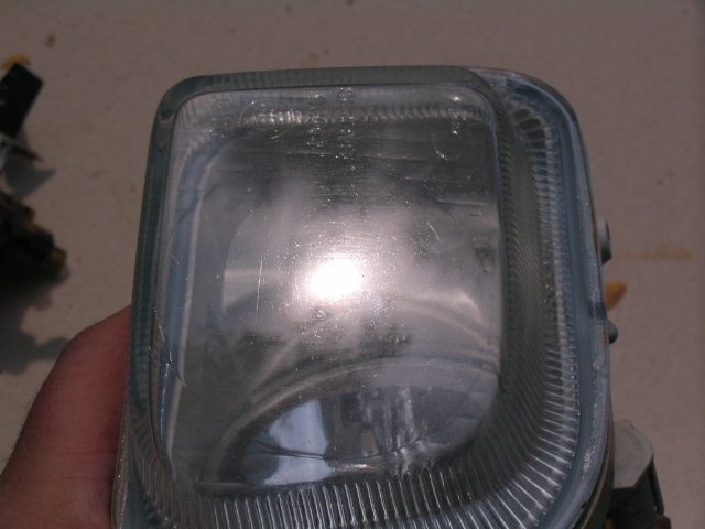

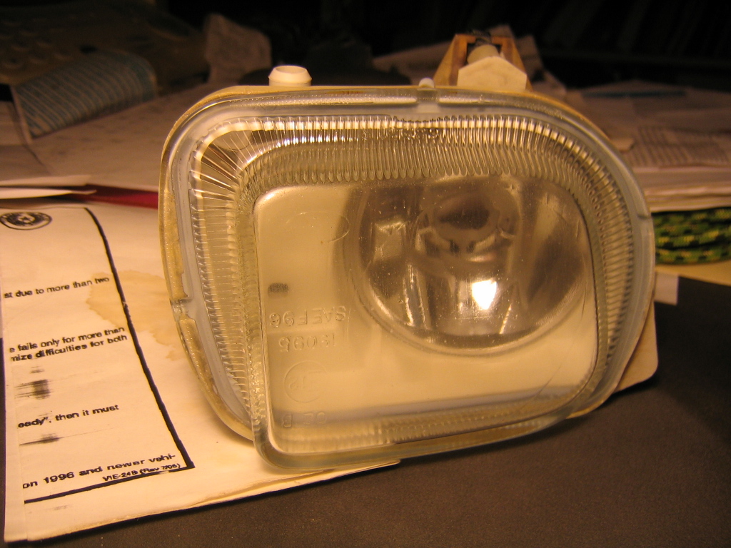

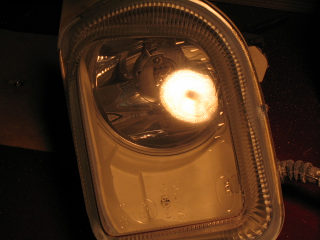

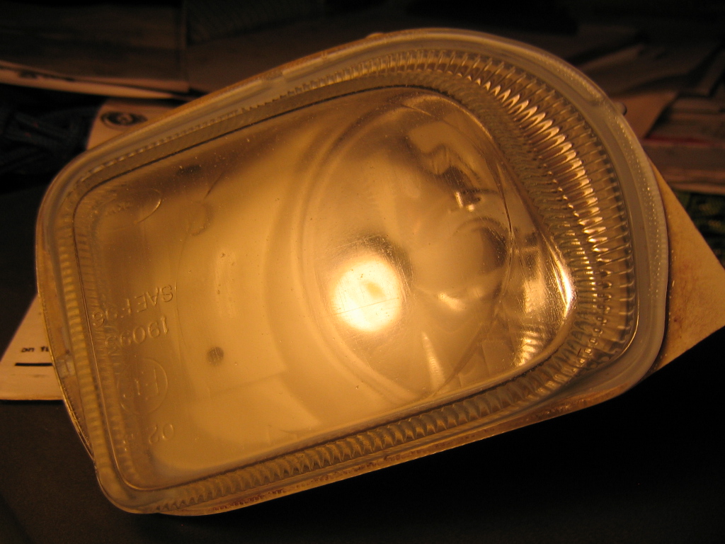

After considerable trial & effort and experimentation, I had removed all the tiny ones and began the path back to clarity. However, this is where progress stalled. The glass surface was still hazy and not capable of producing a sharp light reflection. You can see the deep scratches and blurry light bulb reflection:
Volvo_Fog Light 001.JPG (362.53 KiB) Viewed 1905 times
Volvo_Fog Light 002.JPG (305.34 KiB) Viewed 1905 times
Volvo_Fog Light 003.JPG (324.04 KiB) Viewed 1905 times

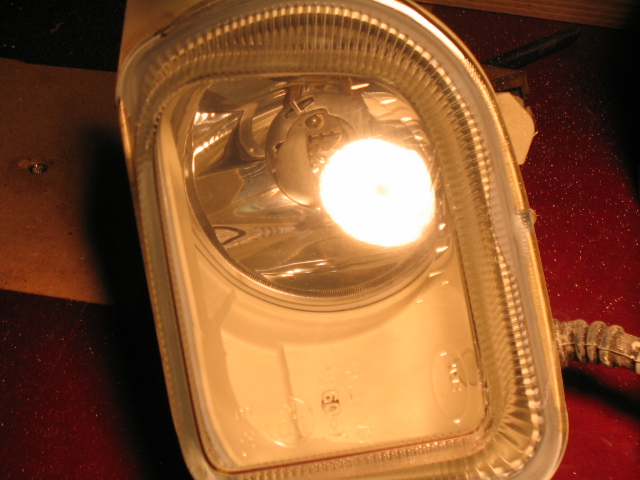

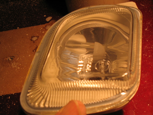

It turns out the foam pad plus CO powder did the trick:
Volvo_Fog Light Lenses 006.JPG (170.95 KiB) Viewed 1905 times
Volvo_Fog Light Lenses 007.JPG (137.67 KiB) Viewed 1905 times
Volvo_Fog Light Lenses 009.JPG (152.27 KiB) Viewed 1905 times
Not perfect, but MUCH BETTER!
I'll continue refining it, then tackle the remaining pitted lens. Except this time, I'll try the drill press with a faster spindle speed to reduce time. Sometimes it's easier & more effective to hold the work rather than the tool.

I began with the lens that was badly pitted, as shown above. Using the drill press, I moved through 100, 150, 180, 220, 320 and 400 grit. With each grit change, I rotated the lens 90° so I could be sure the scratches from the previous rougher grit were all removed. I didn't have 600 nor 800 H&L paper, so I temporarily tacked some w/d 600 grit to another backing pad using 3M Spray 70 contact cement. The results to this point looked much clearer than the work on the other lens. The light reflection was much sharper, the haze was much lighter plus it only took about 30min to get to the same point vs. hours previously.

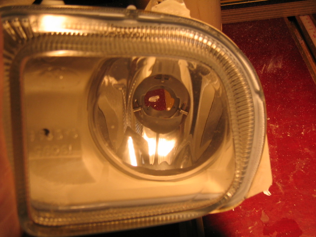

At this point, I decided to go straight to the white cerium oxide paste using the 3" foam pad. I mixed it to a consistency of yogurt. The higher spindle RPM of the drill press made a noticeable difference in effectiveness and within a few minutes, I had achieved water-clear glass!
Volvo_Fog Lights 001.JPG (158.62 KiB) Viewed 1872 times
Volvo_Fog Lights 002.JPG (139.5 KiB) Viewed 1872 times
Volvo_Fog Lights 005.JPG (157.08 KiB) Viewed 1872 times
That's quite a difference compared to the first two photos!

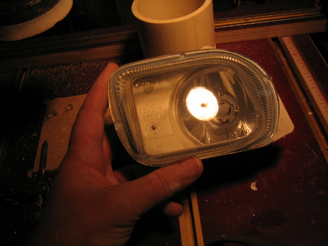

Enthused, I re-worked the other one. I started with 320, then 400 & 600. After cerium oxide, it shined as bright as the other:
Volvo_Fog Lights 006.JPG (152.79 KiB) Viewed 1872 times
Volvo_Fog Lights 007.JPG (173.47 KiB) Viewed 1872 times
Volvo_Fog Lights 008.JPG (156.72 KiB) Viewed 1872 times
YES!!
Tonight, I'll apply the XPEL film, let it cure, then install the fog lights tomorrow! So pleased to have finally achieved these results after such initial frustration! Looking forward to finally having FOG LIGHTS on the sled + new HDLT reflectors!
