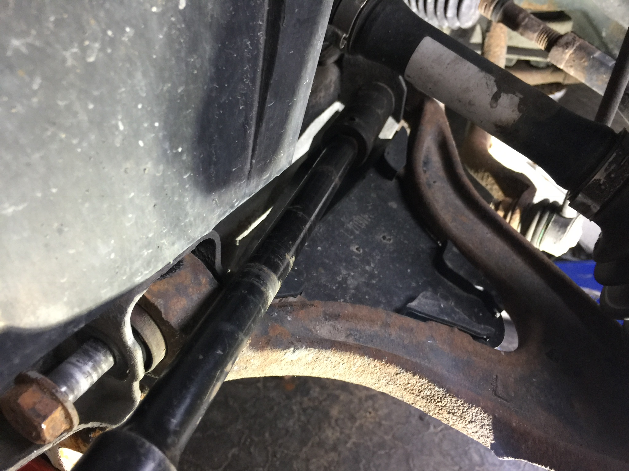

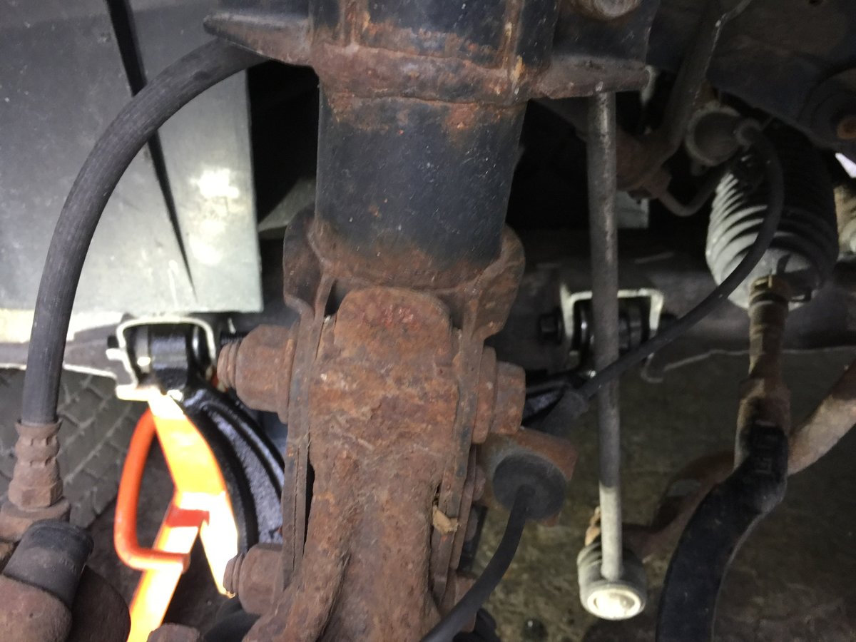

Left side. I zipped off the ball joint and two control arm nuts with an electric impact. You need an extension, about 6 inch , to get the gun clear of the suspension. The ball joint popped clear of the spindle easily, I did a suspension refresh about 2 years ago. New LCA slipped in, I matched the loaded strut center axle height to fender clearance to 18 inches to correct;y position the bushings before tightening, using my jack under the brake rotor to lift the strut in place.
Right side. Much tougher to pry the Lca out. Alldata reports I have to clear engine mount but I did not need to do that

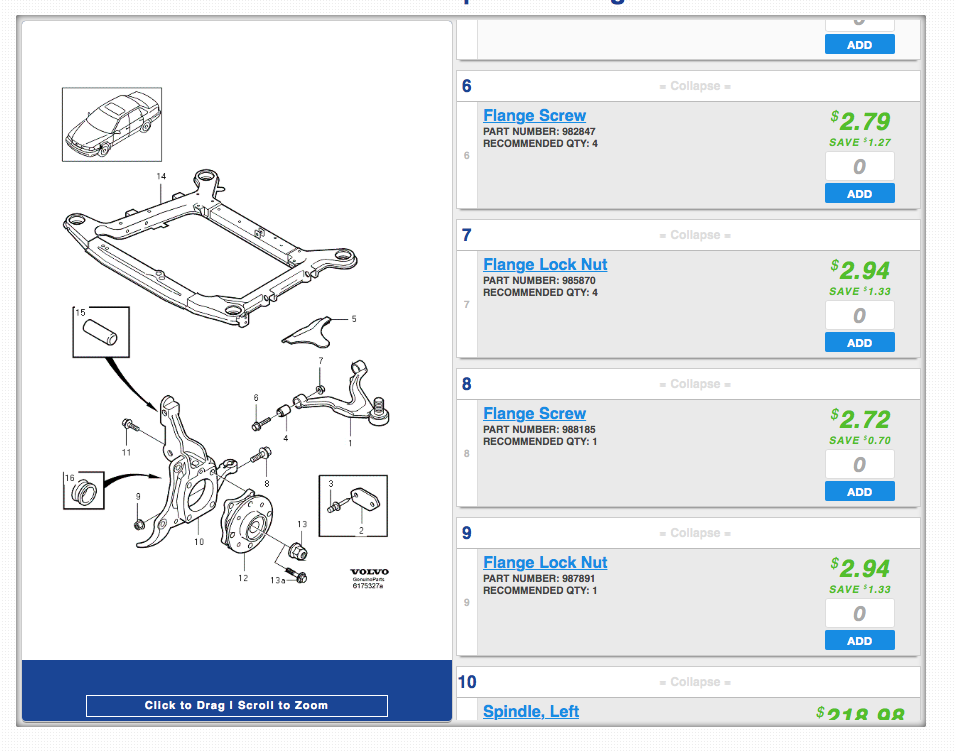

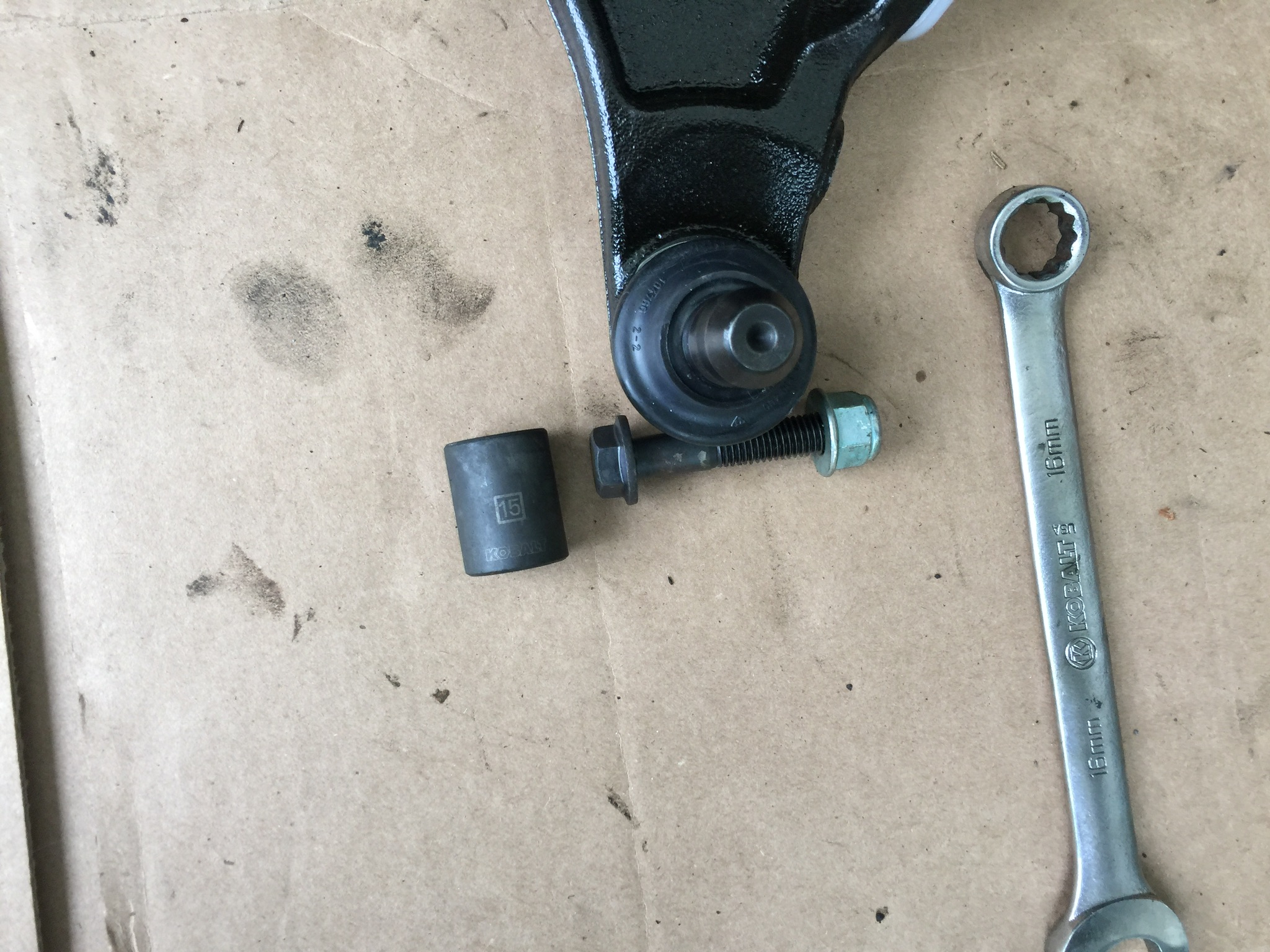

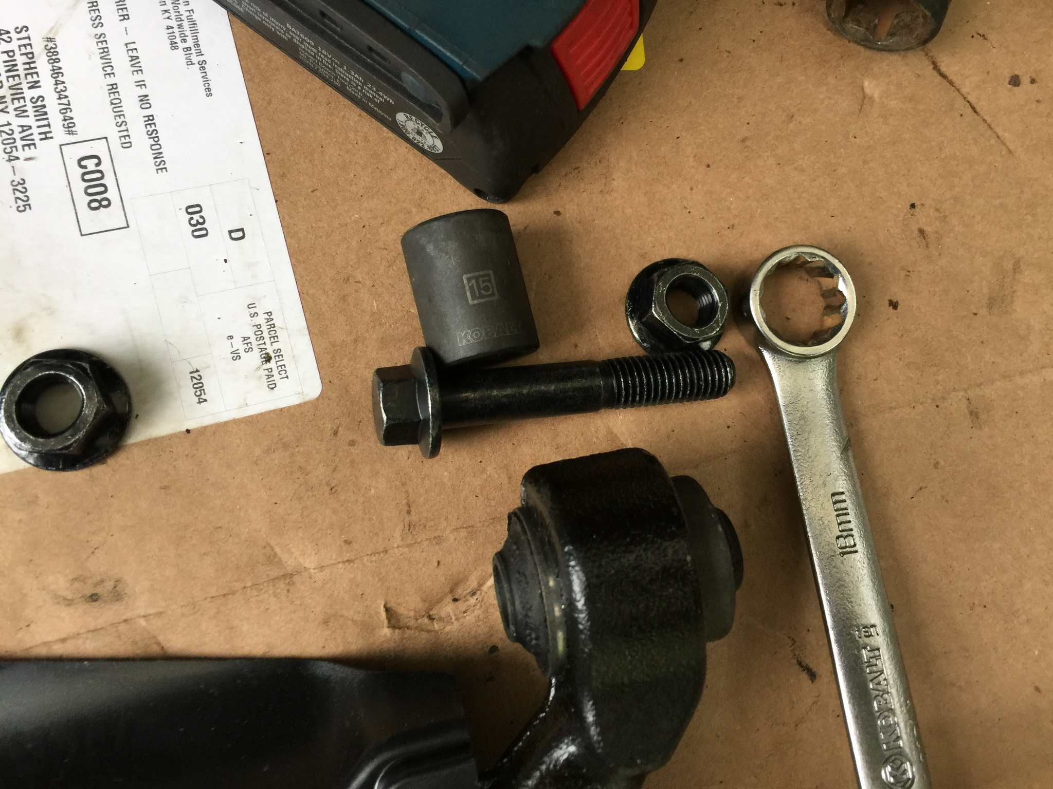

New bolts were slightly different head size than my old LCAs, documented below.

Torques
LCA bolts - 65 Nm plus 90 degree turn, no lube
Ball joint nut. 50 Nm

Screen shot of control arm and ball joint hardware - replace this stuff with OEM only. Notice your nuts go in front of your ball joints, thats for added speed.

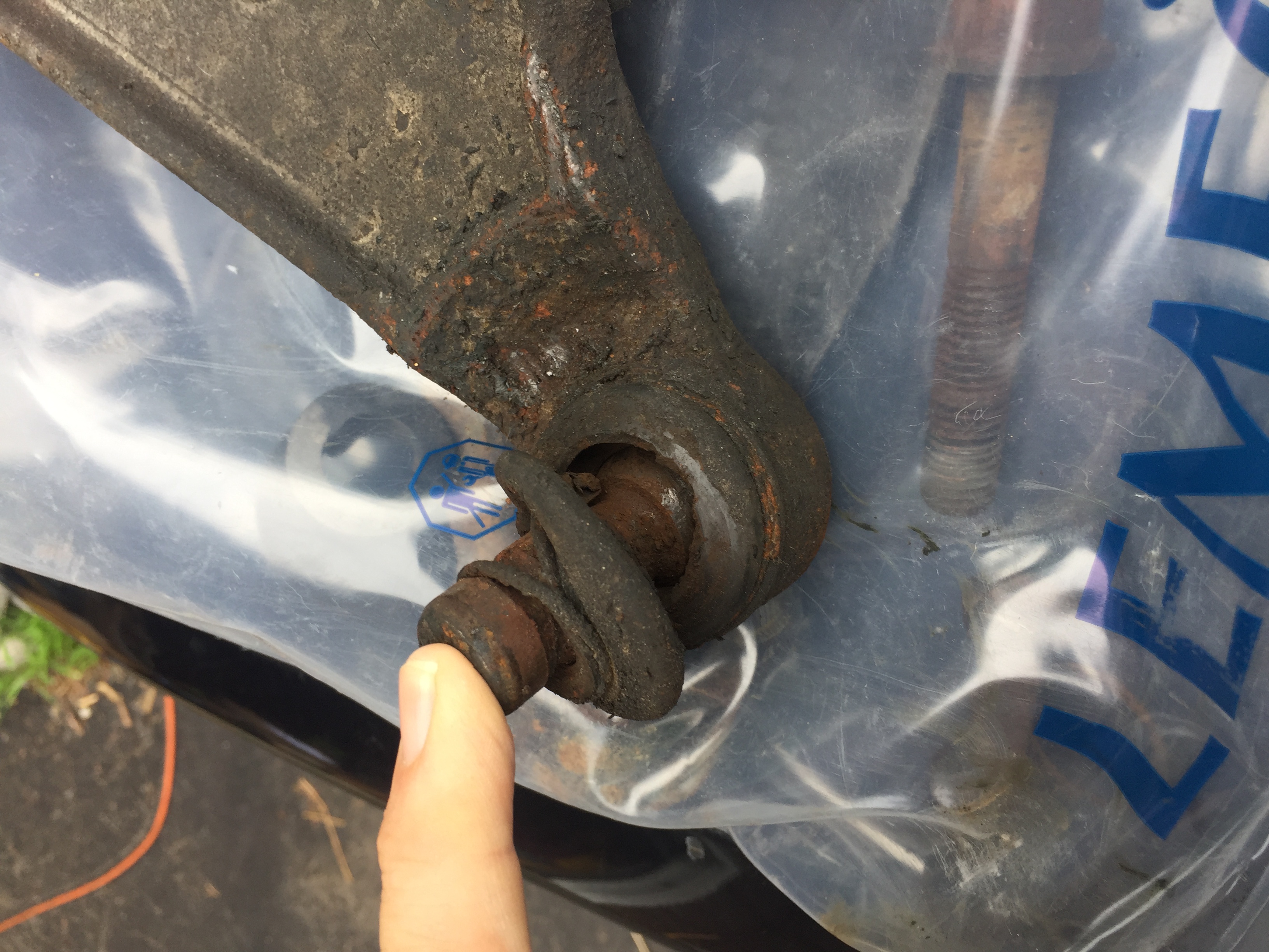

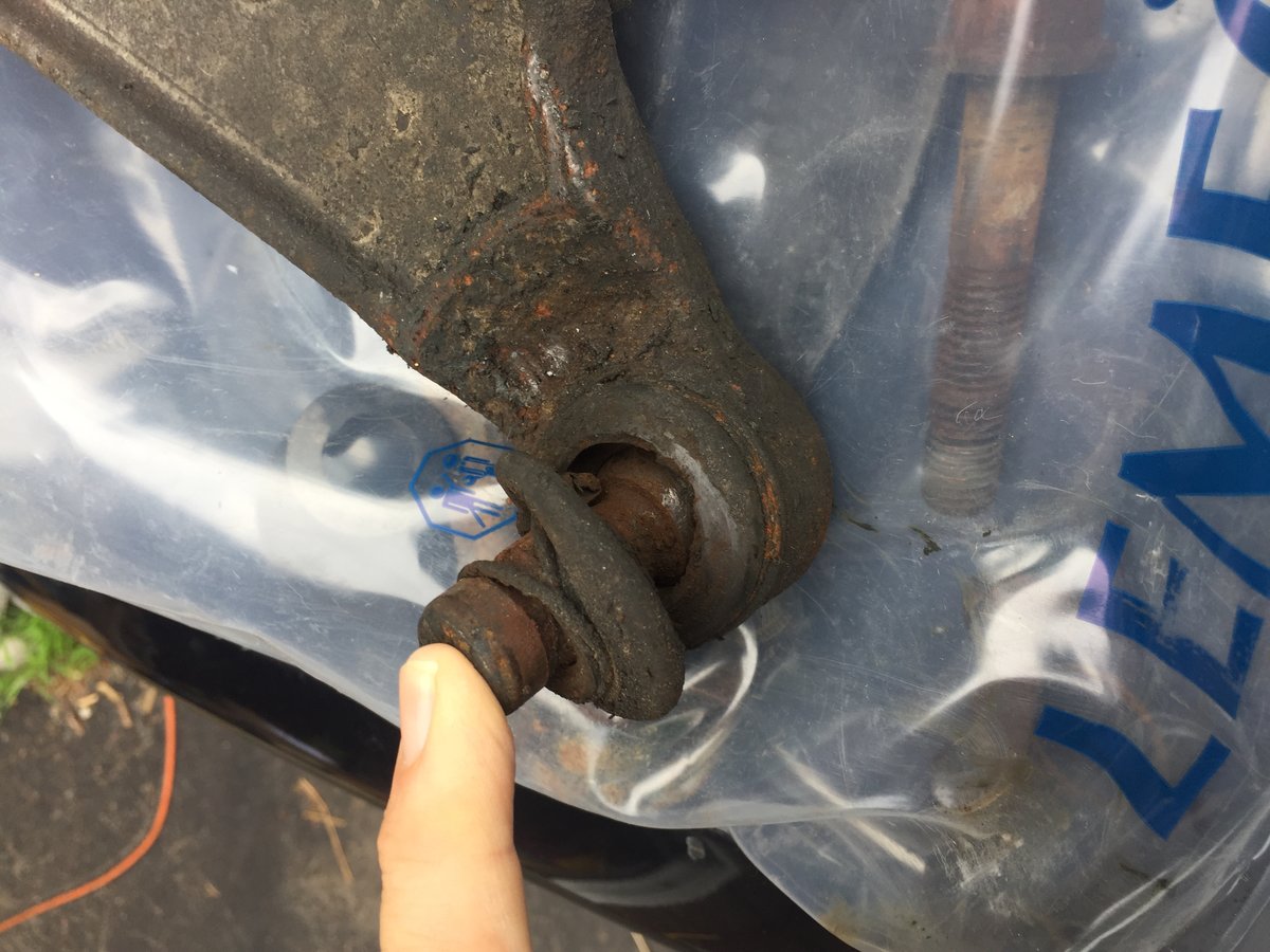

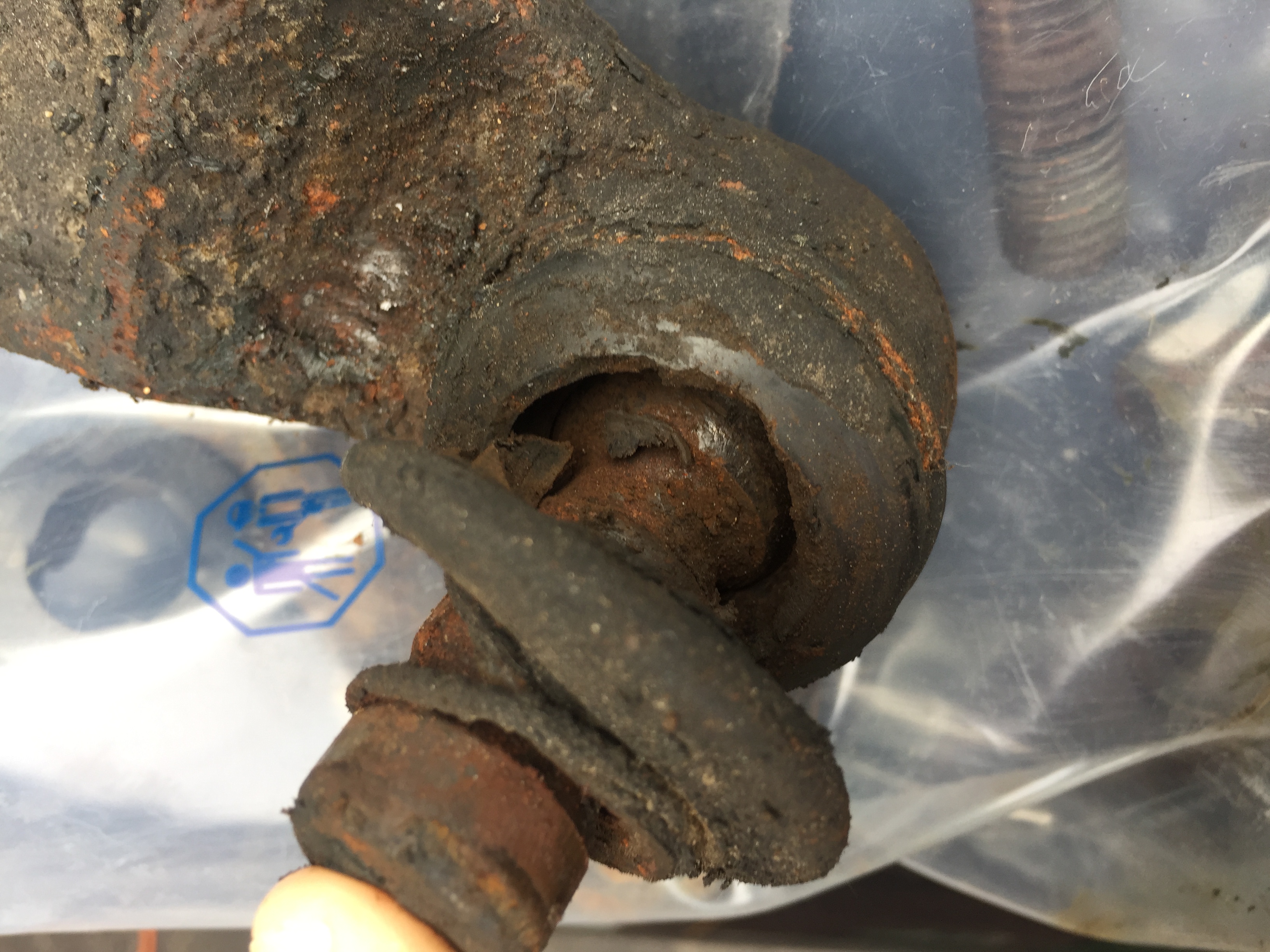

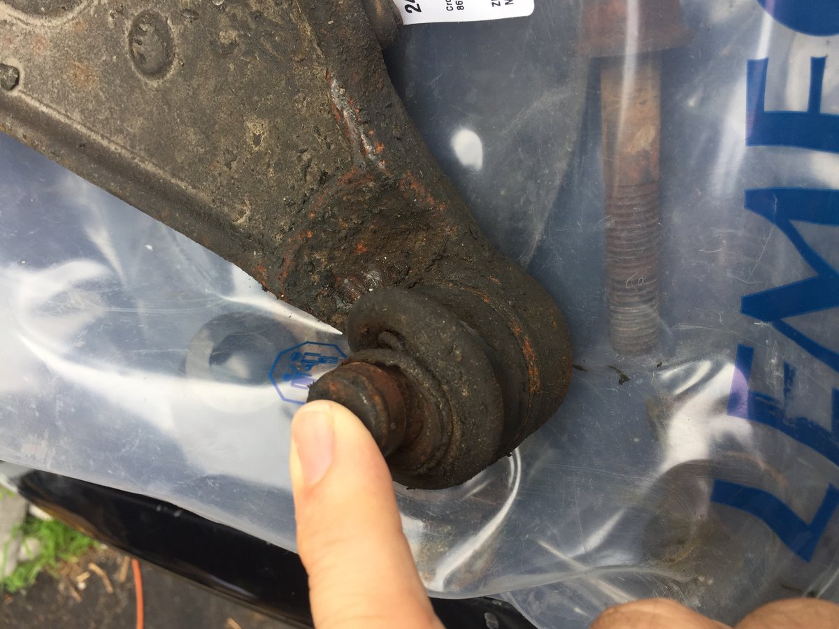

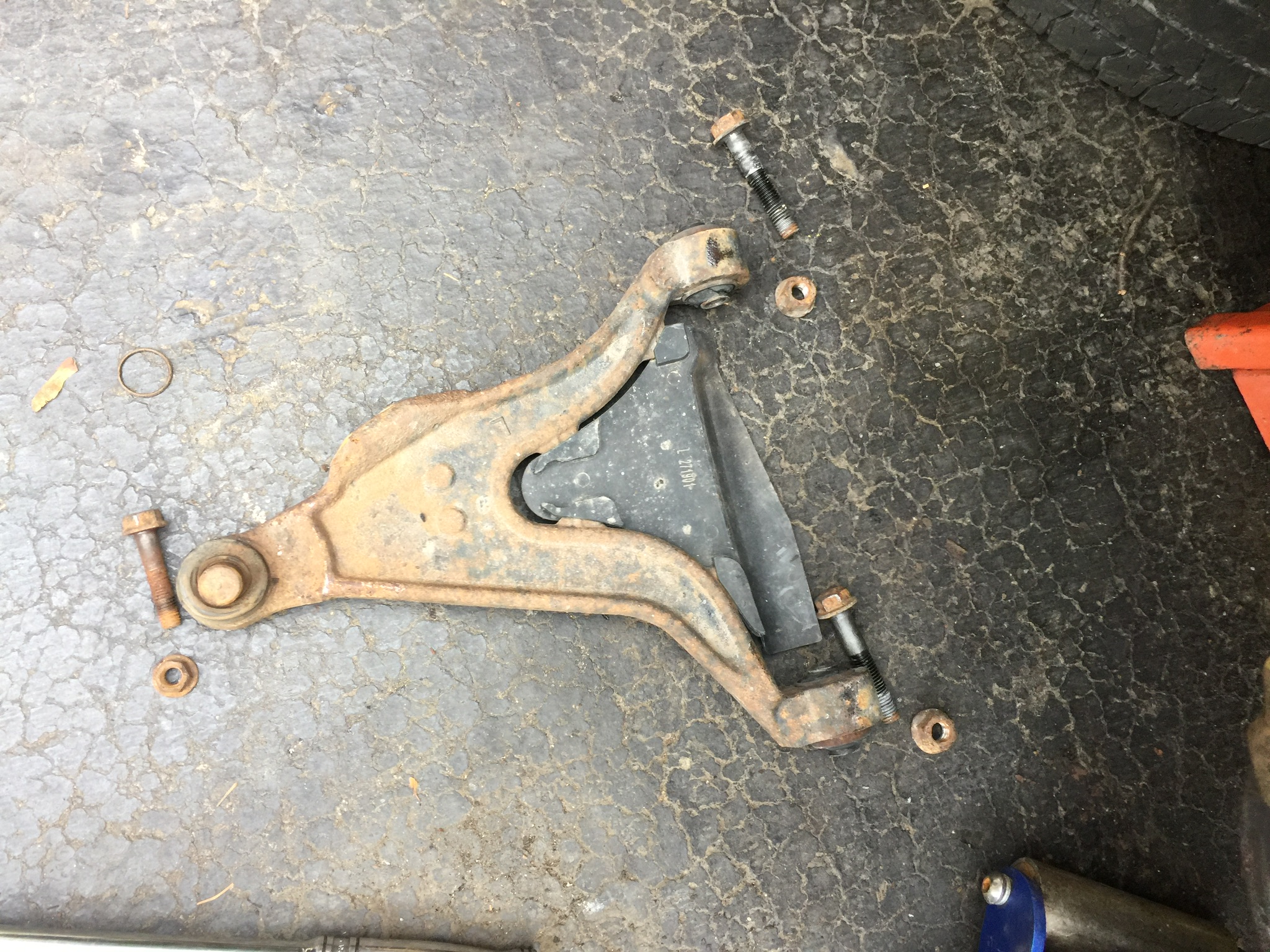

POst Mortem on parts, both LCA were replaced at about 120 134k miles?
The ball joint on the left side was still firm, but the right was so loose that pinky pressure, a high;y technical engineering term of ounces of force, moved the ball joint in the LCA socket.
Click, the ball joint moves over way to easily. Note the bright metal where the ball is machining out the socket..eventually it gets too big and then big trouble happens. This is really not just worn out, it’s dangerous and is not road worthy. The loading of a loose ball joint also makes it prone to shear failure which means the bottom of your strut comes loose from the frame and then life gets interesting

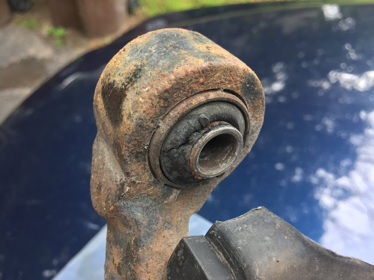

Rubber bushings on the LCA mount are cracked and are toast. This allows a lot of strut motion and bad strut geometry when cornering...right when you need it to be right

Those knuckles have a thick northeast protective coating on them. Both of my southern P80s are still metal colored. Get a wire brush on those before they disintegrate!
