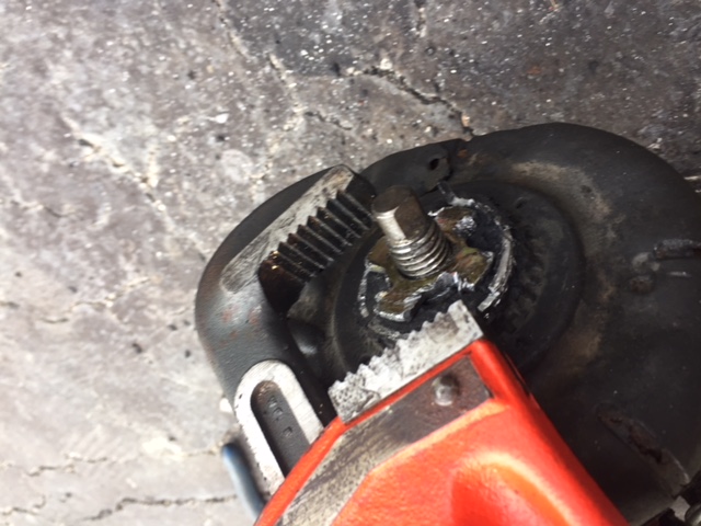

The job was going relatively smooth until I encounter the star nut, what a royal pain in the butt. Took me 1.5 hrs to remove it.
It looks like it sunk into the rubber seat and I had to use a angle grinder, pipe wrench, hacksaw and eventually I was able to turn it and destroy it. I have to buy new start nuts, dealer only according to my parts guy, $13 each LOL
Any tips to make that part of the job easier. Note to self, don't wait until the spring seat is completely fubar in the future.

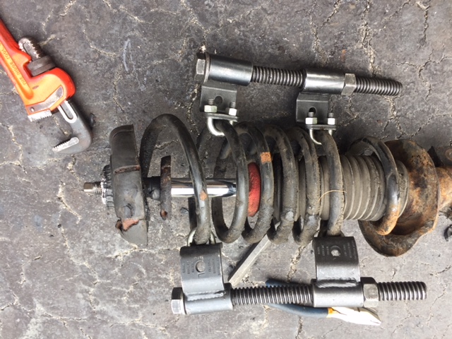

I really like that positive attach point spring compressor. When my cheap one (JCW?) popped off my spring and went 3 meters into the air, I almost caught it in the trash can on the way down.

Yeah its great, it takes a little more time to add the u bolts but I like that it locks. Its Made in Canada which is how things were 10-15 yrs ago, a relic at that!

That has to be camera pincushion in that pic, the spring can’t be bending those 19mm bolts as shown?

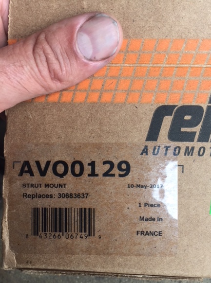

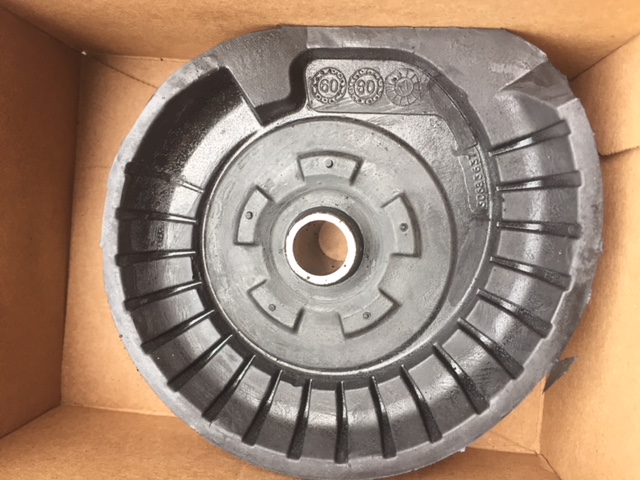

I confirmed that the dealer spring seats are
Rein. The dealer let me compare them, the Rein parts have Volvo scratched off them, you can see it in the picture. No more rumour, 100% true. Hopefully they hold up, it was a bit of a nightmare working in the humidity.
Yes abscate, the 3/4” bolts are flexing. I’m glad metal is ductile and they are probably grade 5. The sprang back straight when I was done. The springs have a lot of tension in them. Note to those doing this, make sure your attach the compressor stretched as far apart as possible or you will be screwed, ask me how I know. I had to rent a 2nd spring compressor.

Ugh. Definitely bad news Volvo has indeed changed manufacturers, but very good to be aware of. Thanks for posting that.mecheng wrote: ↑25 Jul 2018, 10:56 I confirmed that the dealer spring seats are
Rein. The dealer let me compare them, the Rein parts have Volvo scratched off them, you can see it in the picture. No more rumour, 100% true. Hopefully they hold up, it was a bit of a nightmare working in the humidity. ...

The passenger side motor mount is also made by Rein. Lower transmission torque rod I believe is Hutchinson. Volvo is scratched off on both of themerikv11 wrote: ↑25 Jul 2018, 12:24Ugh. Definitely bad news Volvo has indeed changed manufacturers, but very good to be aware of. Thanks for posting that.mecheng wrote: ↑25 Jul 2018, 10:56 I confirmed that the dealer spring seats are
