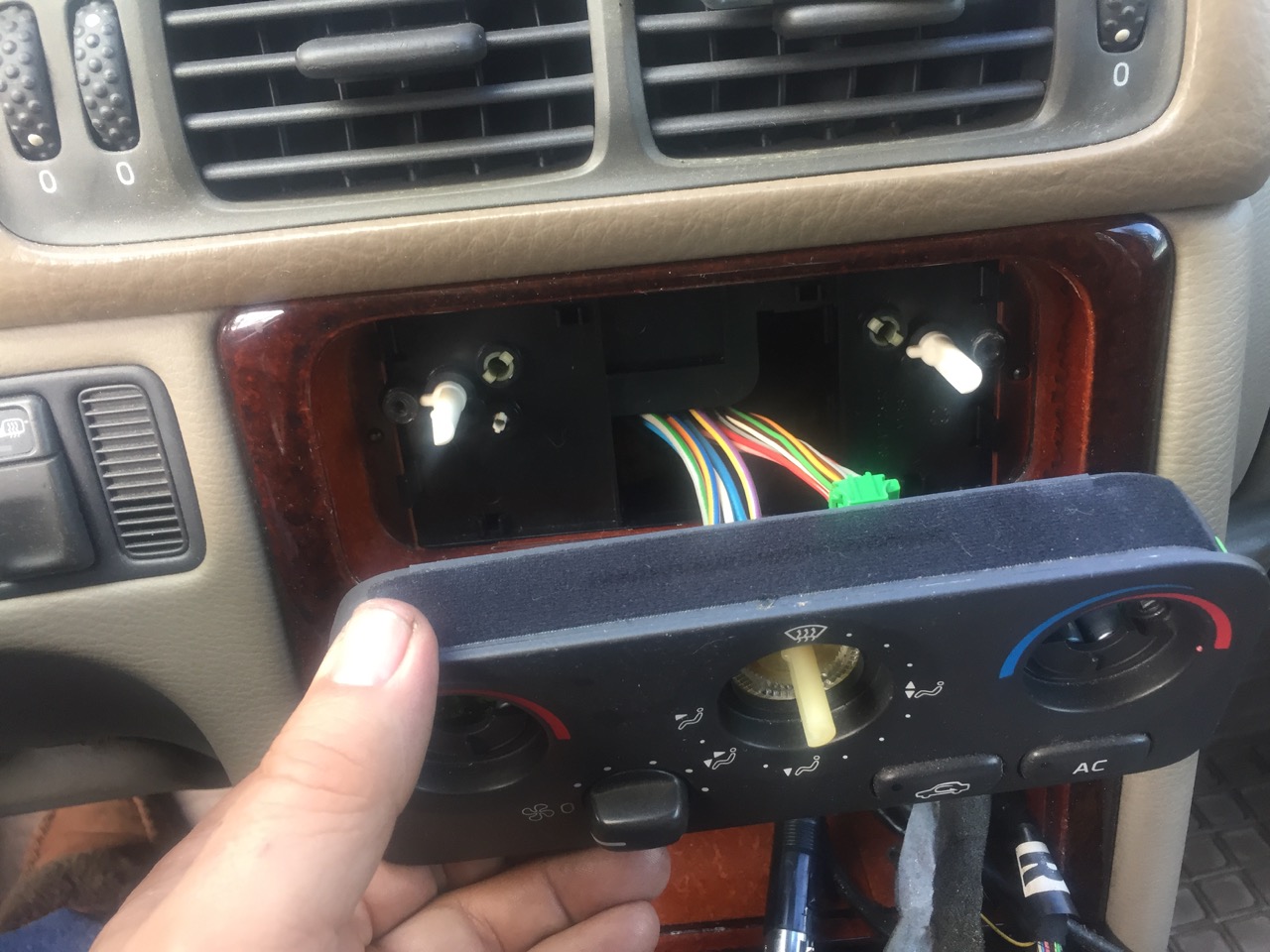

My passenger temp control was not regulating, reaching around the dash, I could feel the cable had popped off the MCC gudgeon, so I went to work
Unlike an ECC controller, the MCC controller is removed by unscrewing the rear part (the part you see) from the console frame, then unclipping the FRONT part (hidden in dash)
From there, you can manipulate it enough to reattach the cables with some tricks
Unclip the cable from the frame (snap in) so that it is free
The eye on the cable goes on the gudgeon, the wire gets retained by the C clip built into the plastic gudgeon
Put the eye on the shaft, then turn the temp knob hot to use the frame to retain it.
Tools
Torx T15 for screws
SPudger to release plastics frame and clips
Put a shot of silicone spray into top of each wire to make things move smoothly
Elapsed time 25 minutes
*** Be careful with that MCC - its a $450 part and eBay is no help - hard to find in PnP.

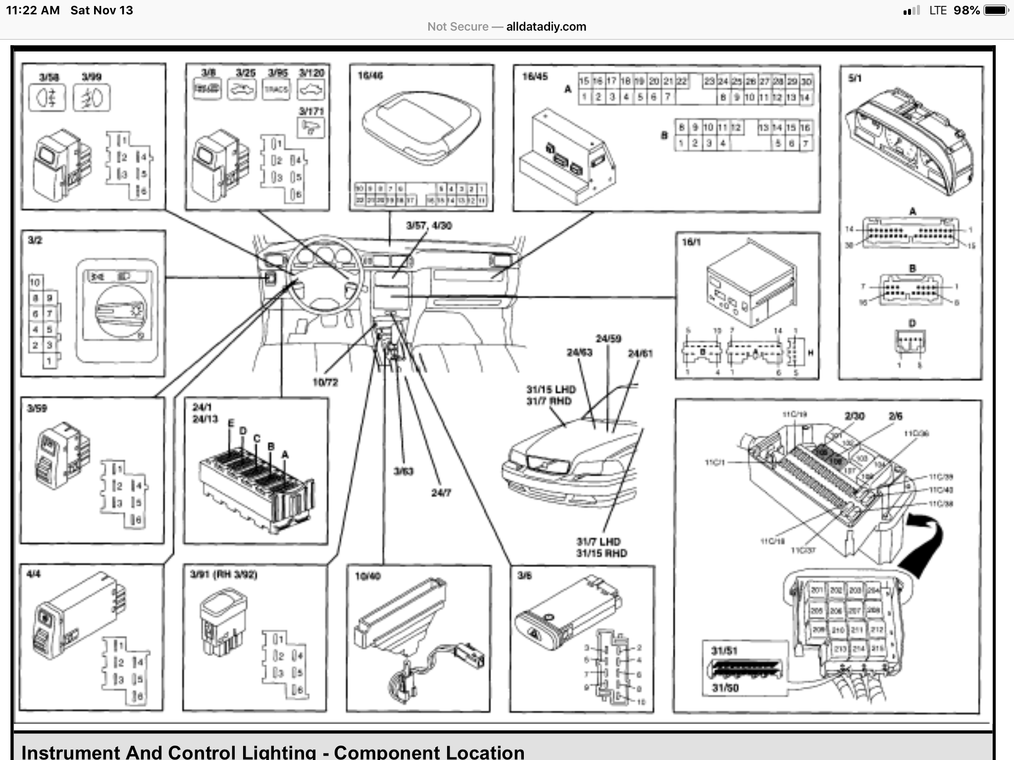

Hmmmm, lights are out on the MCC head
Diagram…looks like first check will be in B18 with lights on.

Brought my spare mcc control unit but as I pulled off the knobs and manipulated the plugs the lights flashed.
It turns out pressure on the rear face makes the lights intermittent. We put a spacer between the rear face and the mechanical cable unit and all is wellll

Sounds like some loose solder joints.
Glad you got it working though. No lights on the unit at night is no fun.

Ah, I know what’s going on
The bulbs bayonet the front of the circuit board on the MCC unit. The electrical connection is inside , on the rear of that board.
Slight Pressure on the bulb holders will disconnect the connections in the board and ,,,,, lights out
