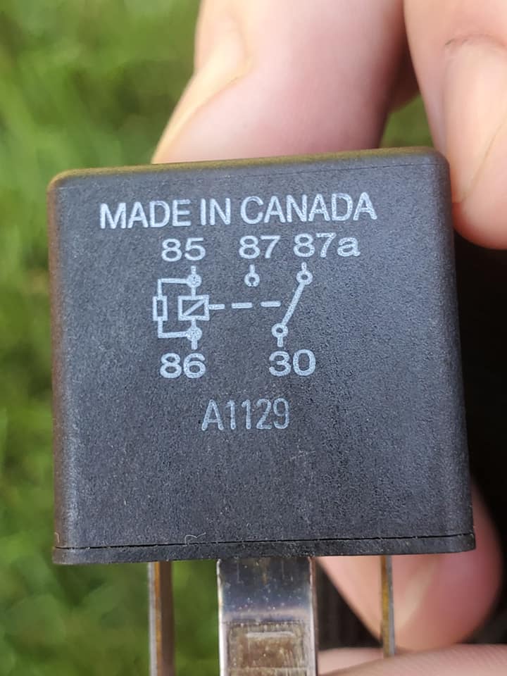

Relay diagram, stock "J" relay vs. BMW relay with 87A

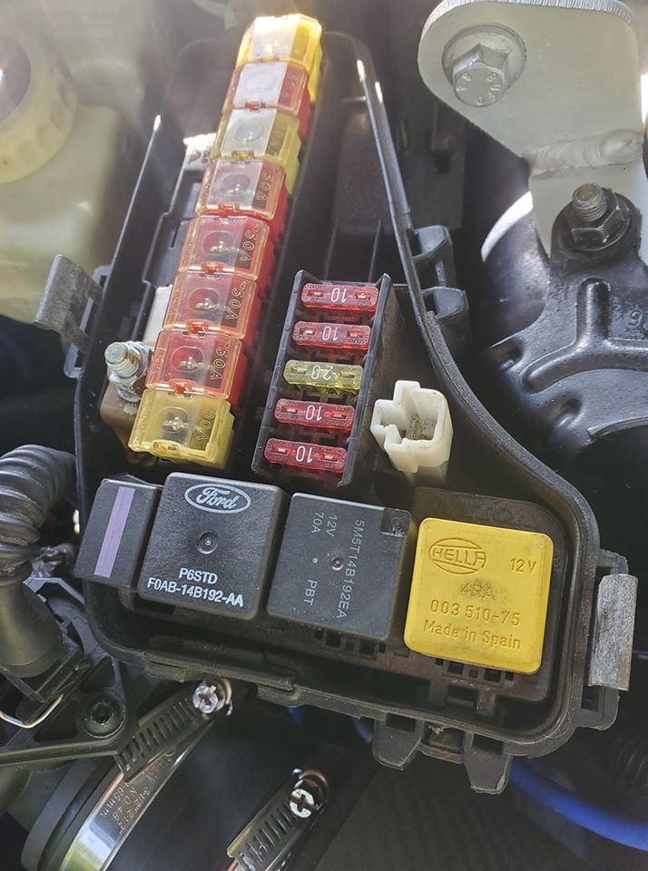

Ford relay detail
Ford relay detail
M56 money shot
M56 money shot
