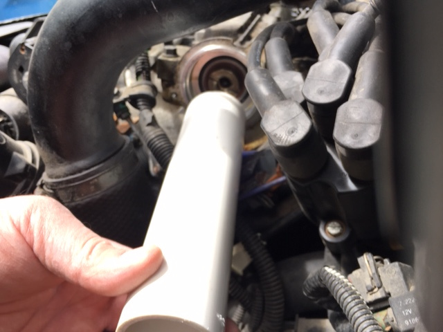

TOOL TIP...I didn't have a 36mm socket to drive the cam seal in place so I found that a 1 1/2" schedule 40 PVC tube (had a 4' piece) worked great, perfect diameter to seat the seal.
- IMG_6892.JPG (94.31 KiB) Viewed 2126 times
