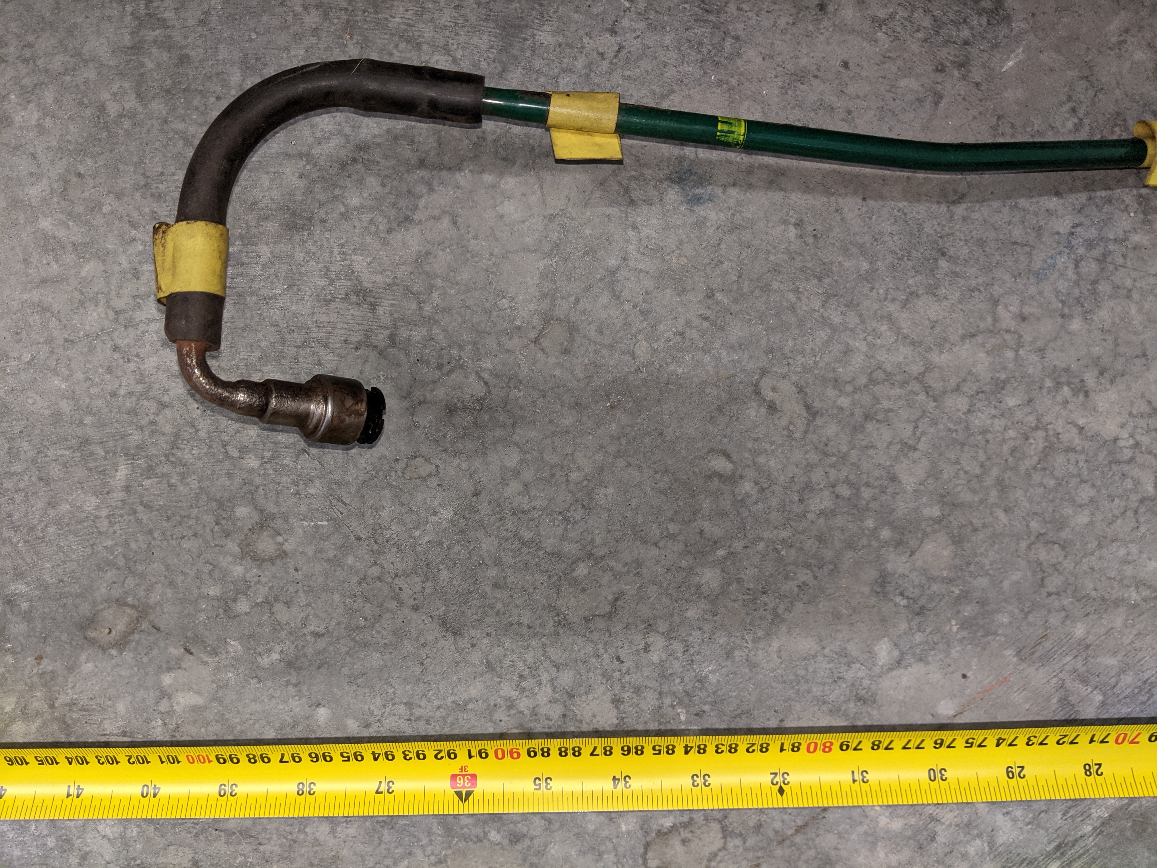

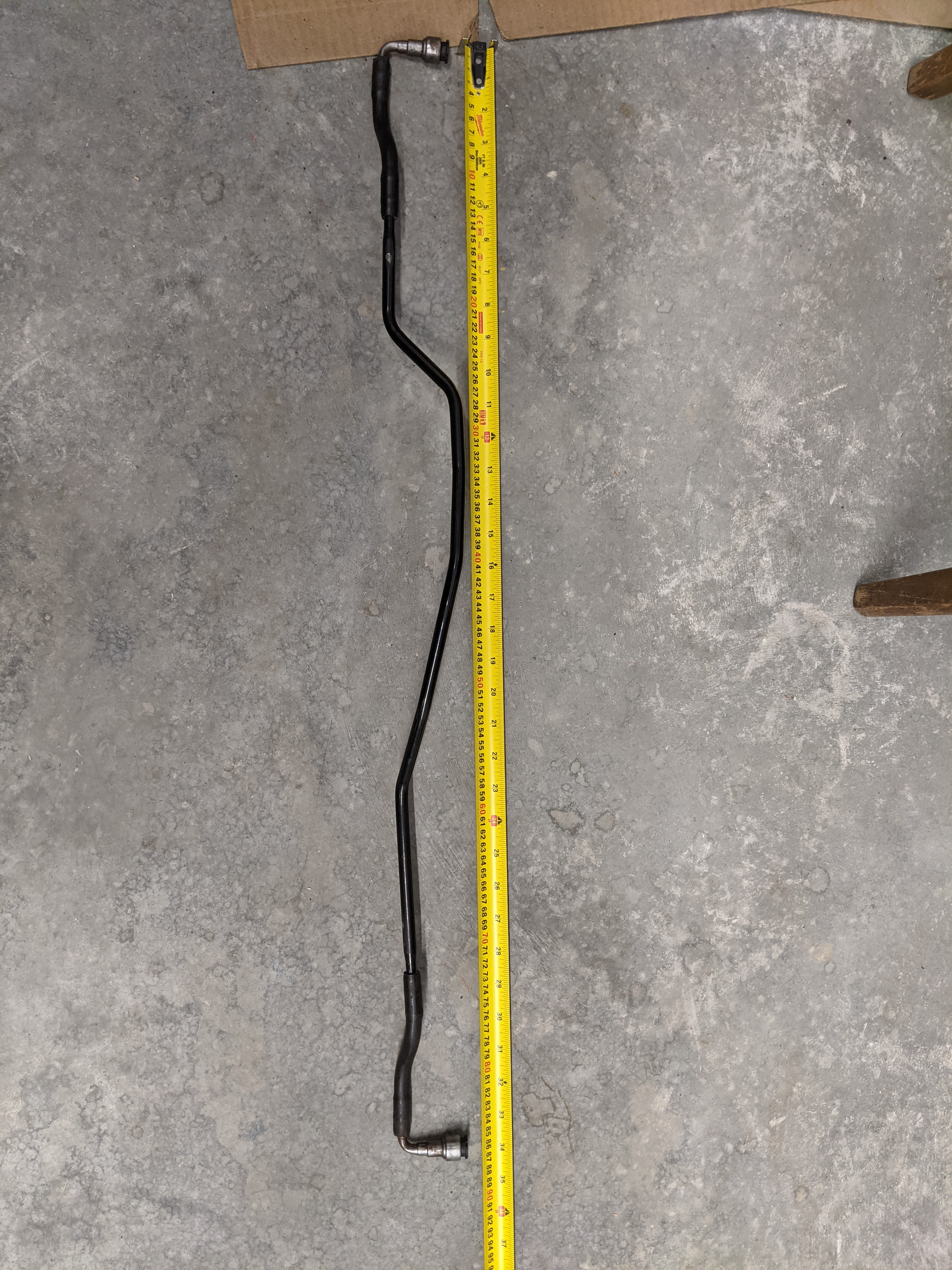

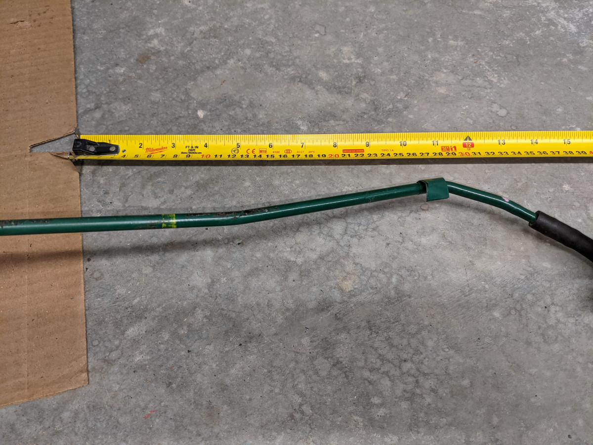

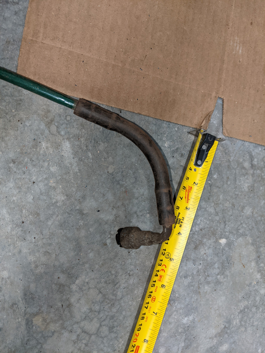

1) First up - Fuel line between left and right of saddle fuel tank
This pipe connects the ejector on the front of the fuel tank on the LHS to the fuel pump assembly on the RHS front of the tank. This pipe and in particular the ends where it connects to the tank has bare metal pipes which are exposed and prone to rusting. The center section is coated with like a plasti-dip material which is about 1mm thick!

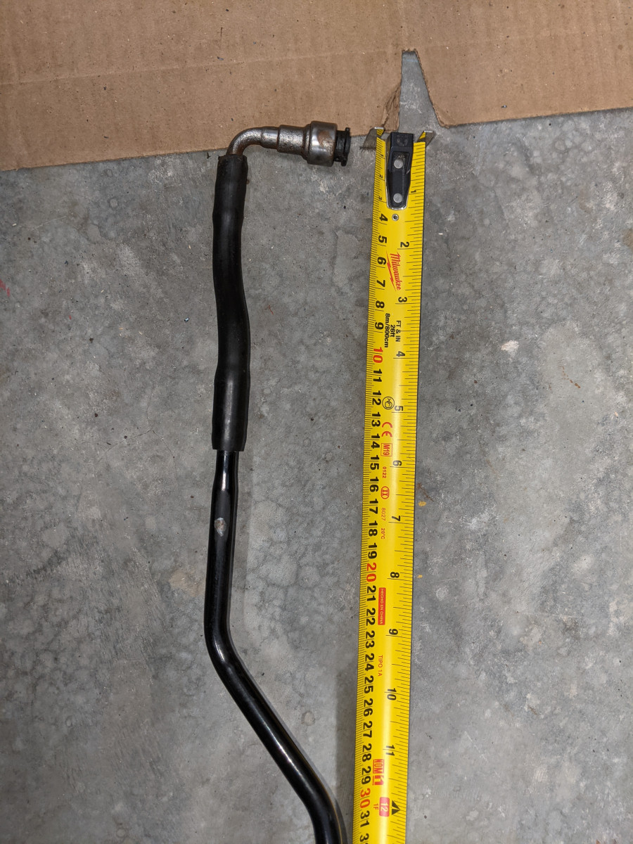

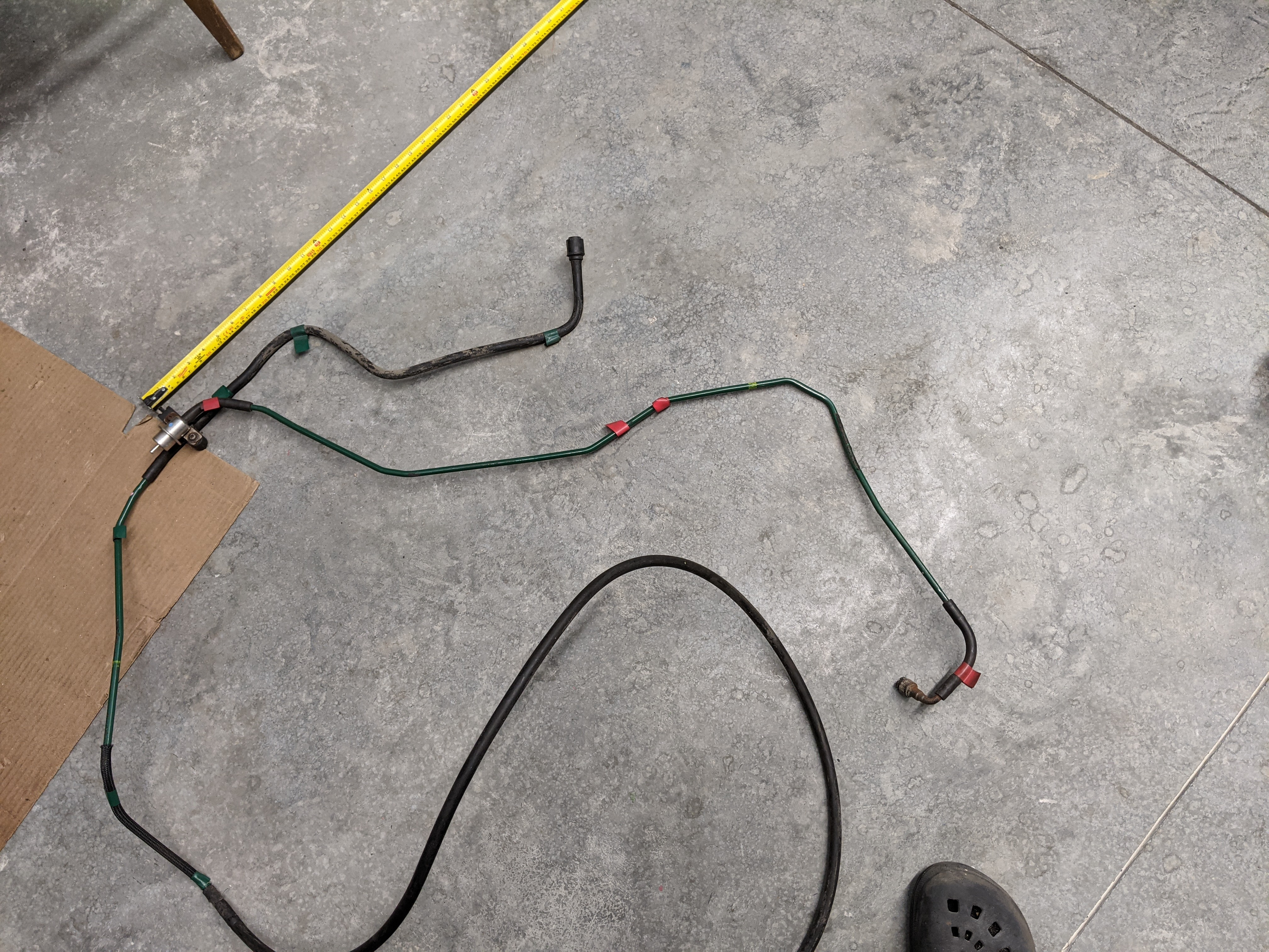

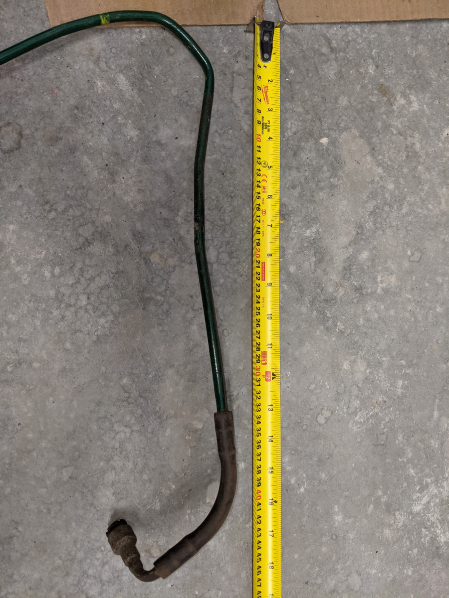

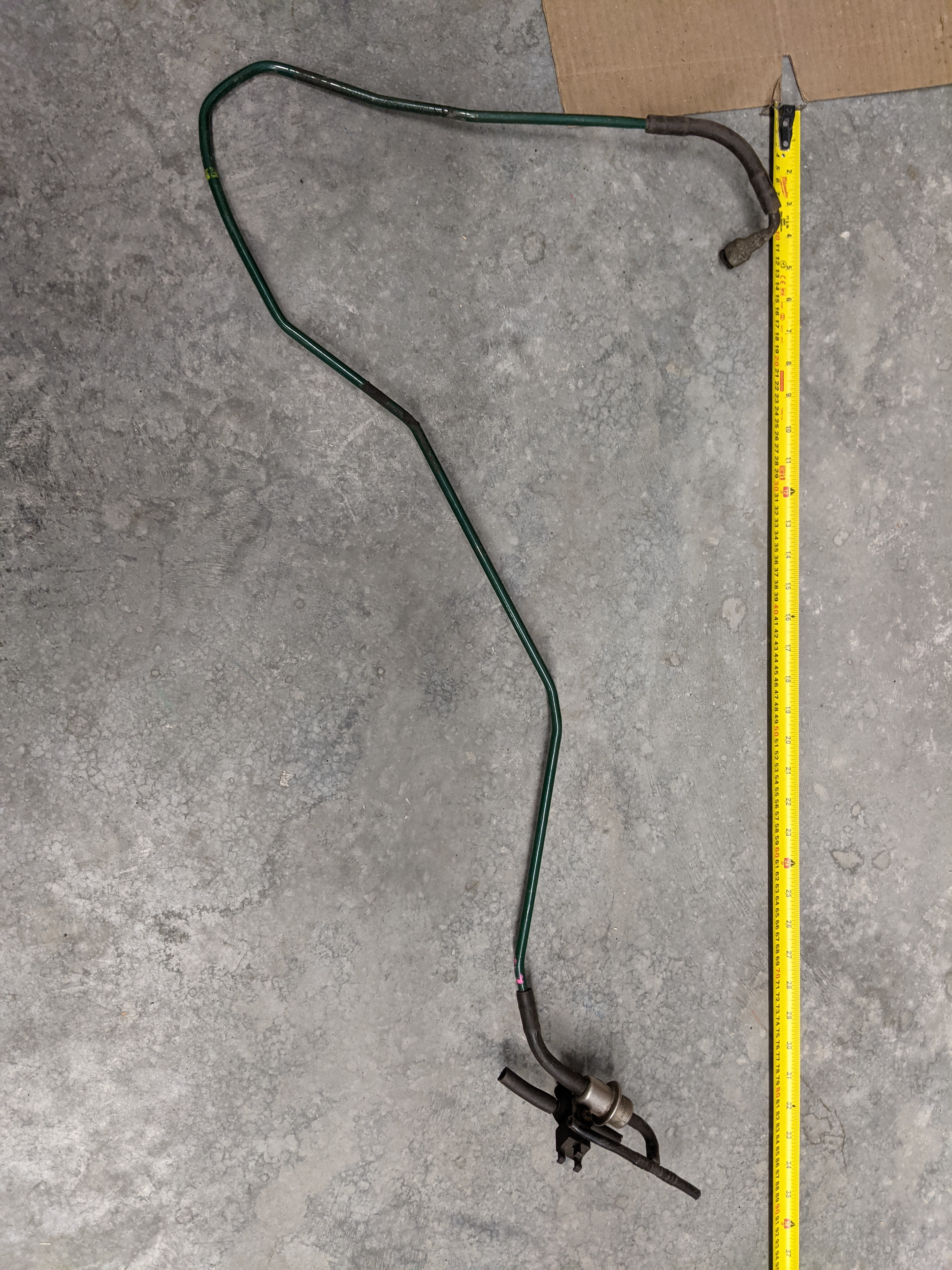

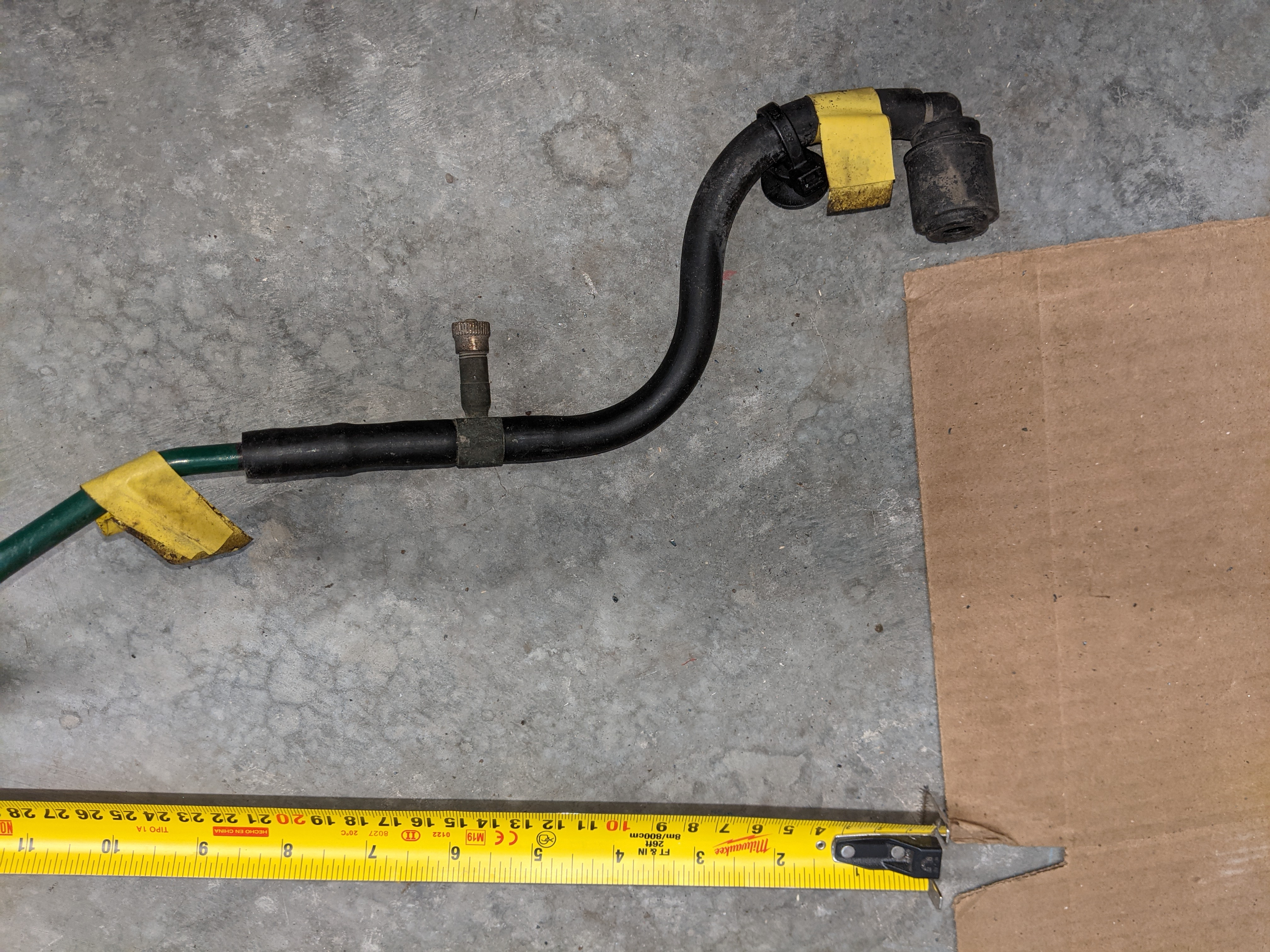

2) Main fuel pipe to the engine from fuel filter
This is the main pipe. This runs from just behind the RHS of the engine block with a fuel quick connect and runs back to the output of the fuel filter on the rear of the rear sub-frame. The pipe runs in a channel under the RHS of the car which is covered by a plastic cover.

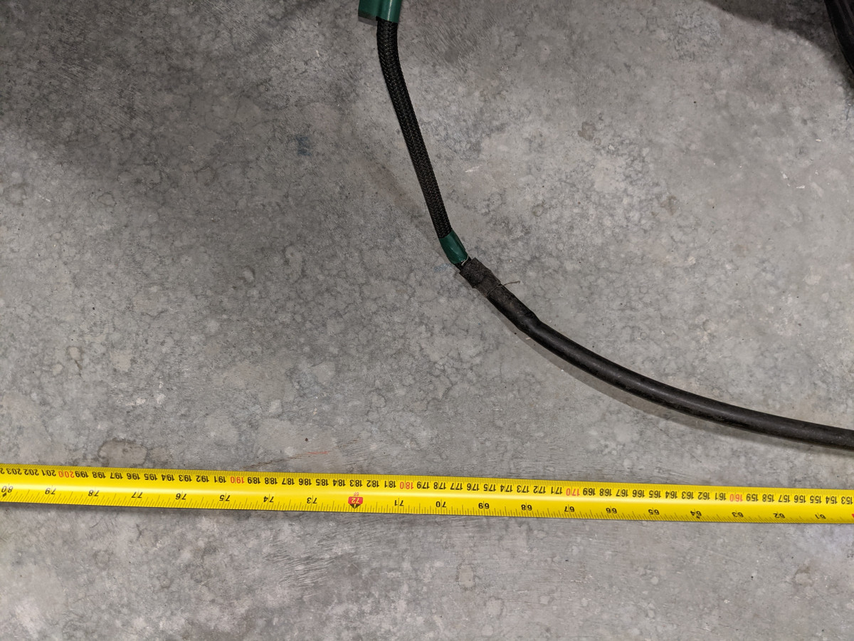

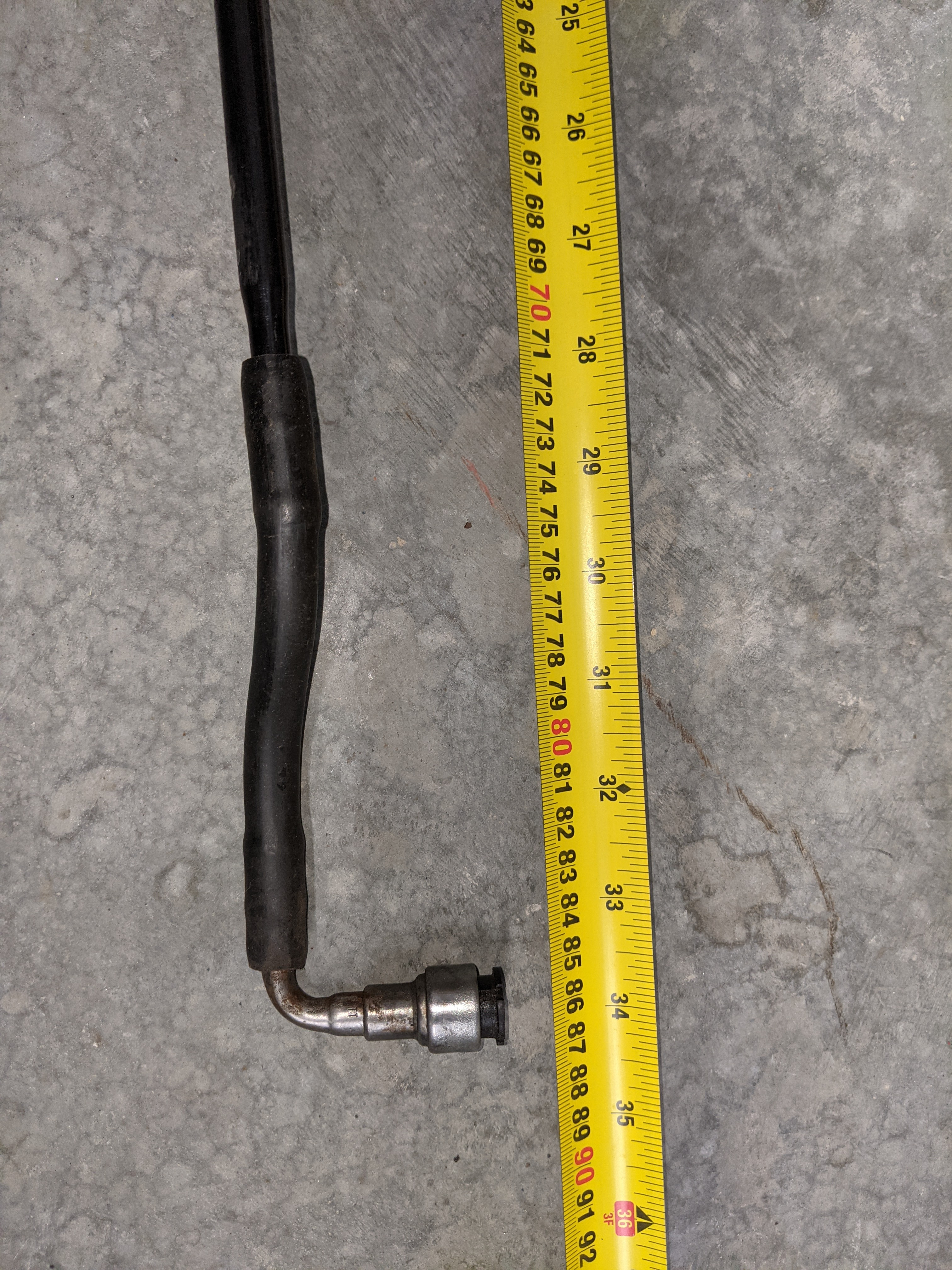

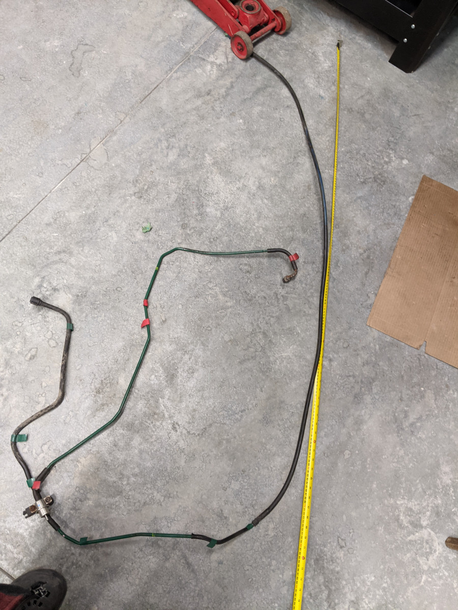

The long reinforced rubber hose that starts under the floor jack (approx. 6ft long) is the section from the hard-line up to the injectors at the rear of the engine and is covered in the channel under the floor to just forward of the fuel tank near the front of the RHS rear wheel

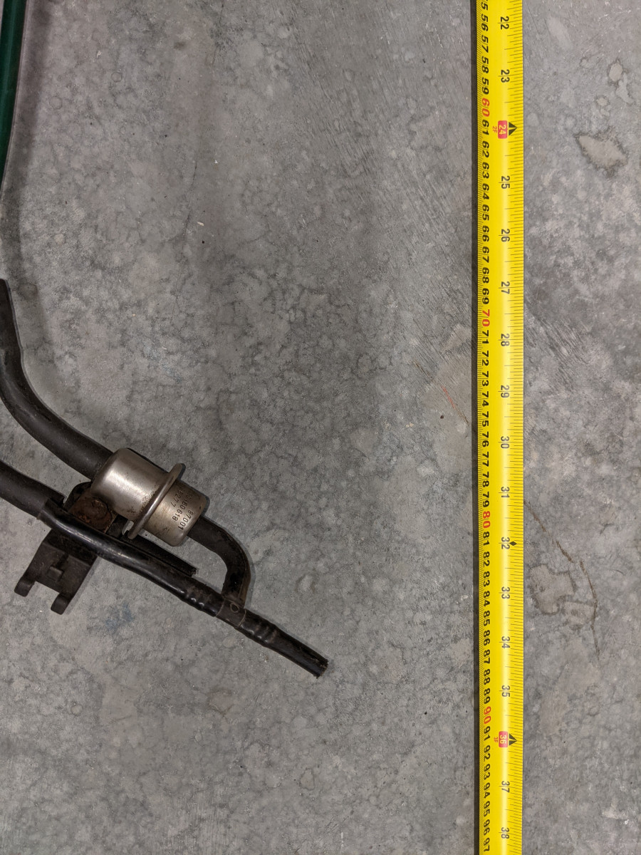

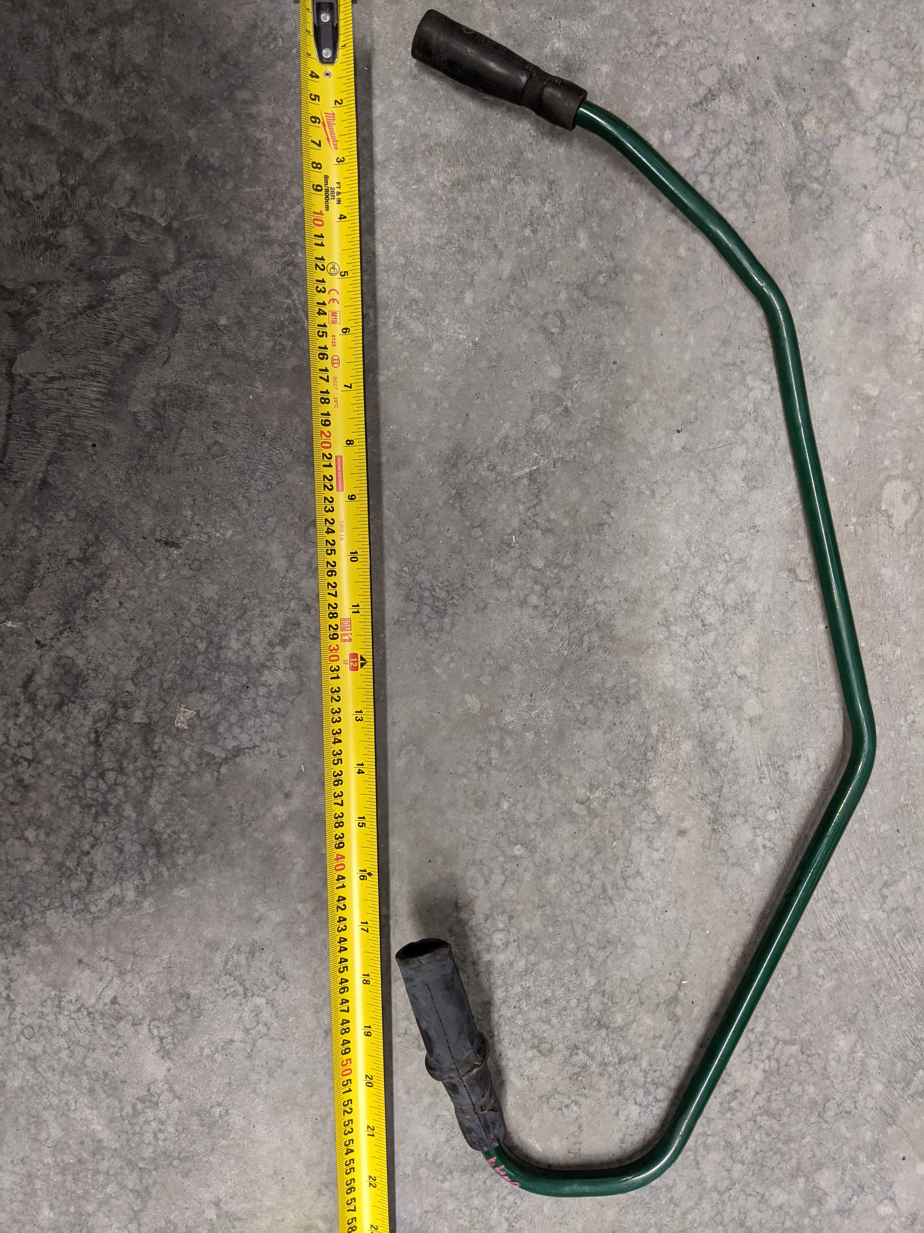

Finally for this pipe there is the section of pipe that returns fuel to the fuel tank from excess to the engine. This and the fuel feed are controlled by the pressure regulator (the silver cylinder on the pipe). This is fitted on top of the tank forward of the rear axle on RHS. The fuel regulator has a plunger valve on the underside that pushes down through the plastic housing it sits on to control fuel pressure to engine. The 'free' end of the fuel regulator has a pipe that connects to it that runs back from the engine in the same channel as the fuel pipe to the engine in the channel under the floor.
The pipe from the fuel regulator then runs over the rear of the fuel tank and then around to the front and connects to the ejector unit on the LHS front of the tank. Note: For AWD P80's both the ejector and fuel pumps have level sensors that both need to work to give correct fuel tank levels as the average out both sides.
The above picture is from a spare section of the pipe to make it easier to view.

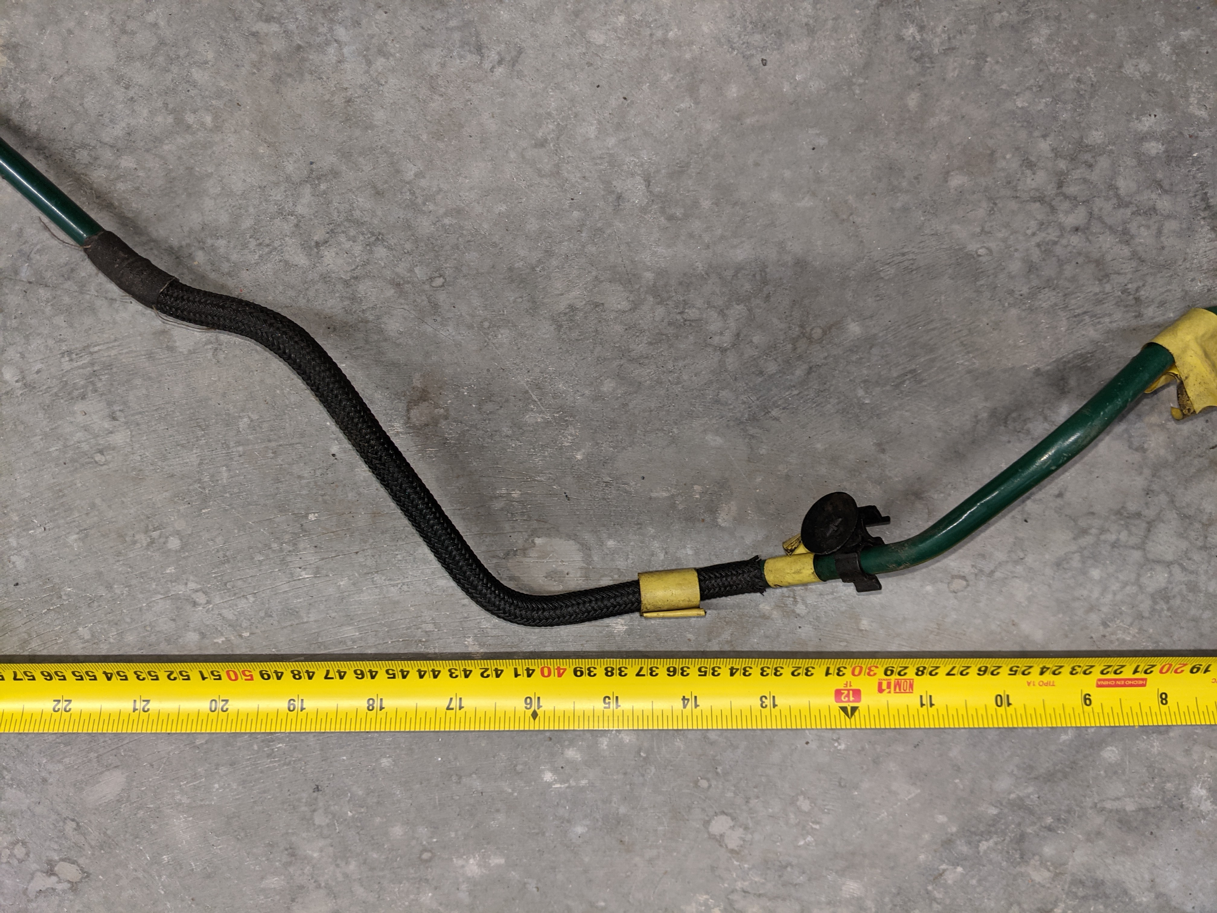

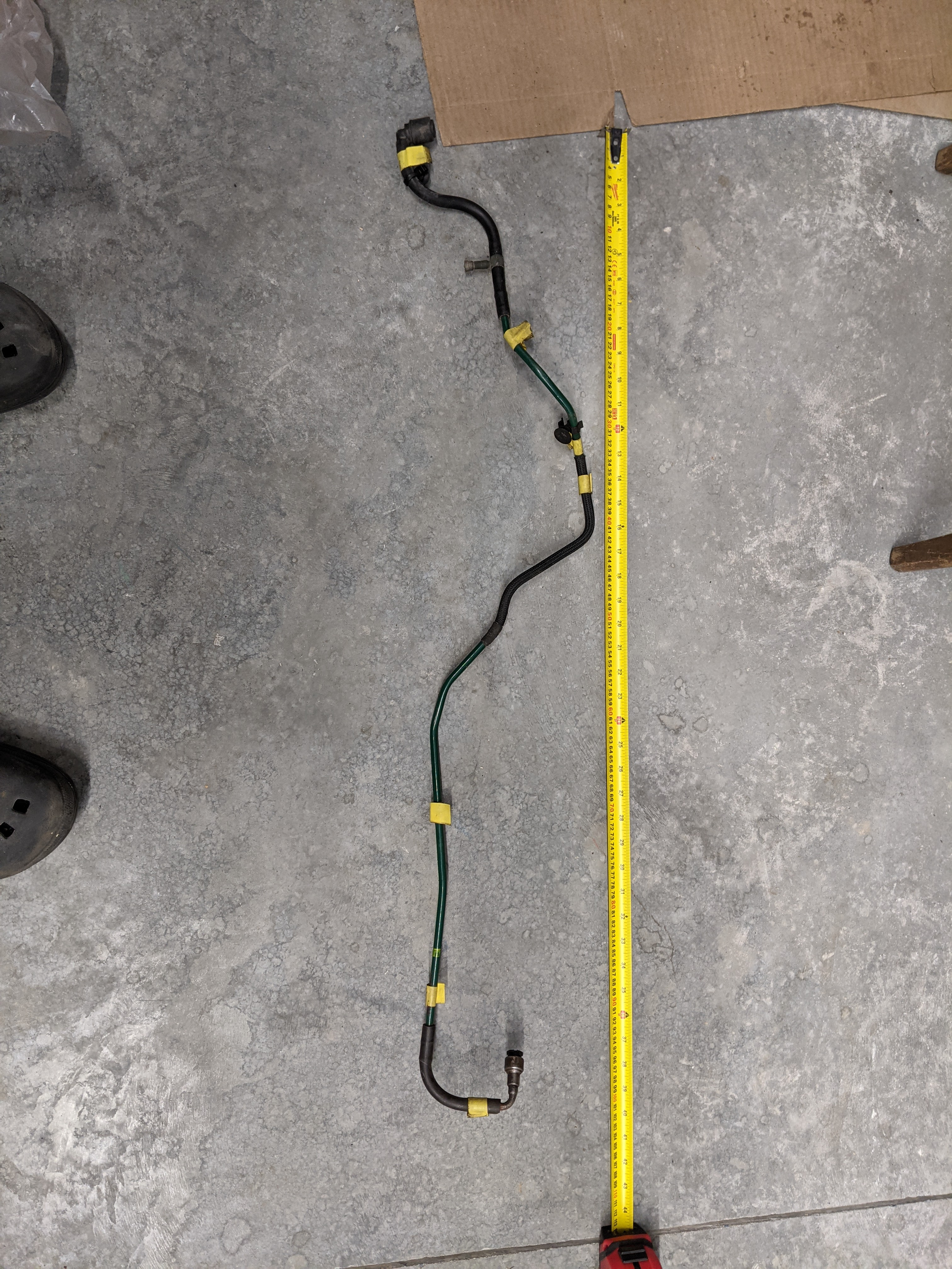

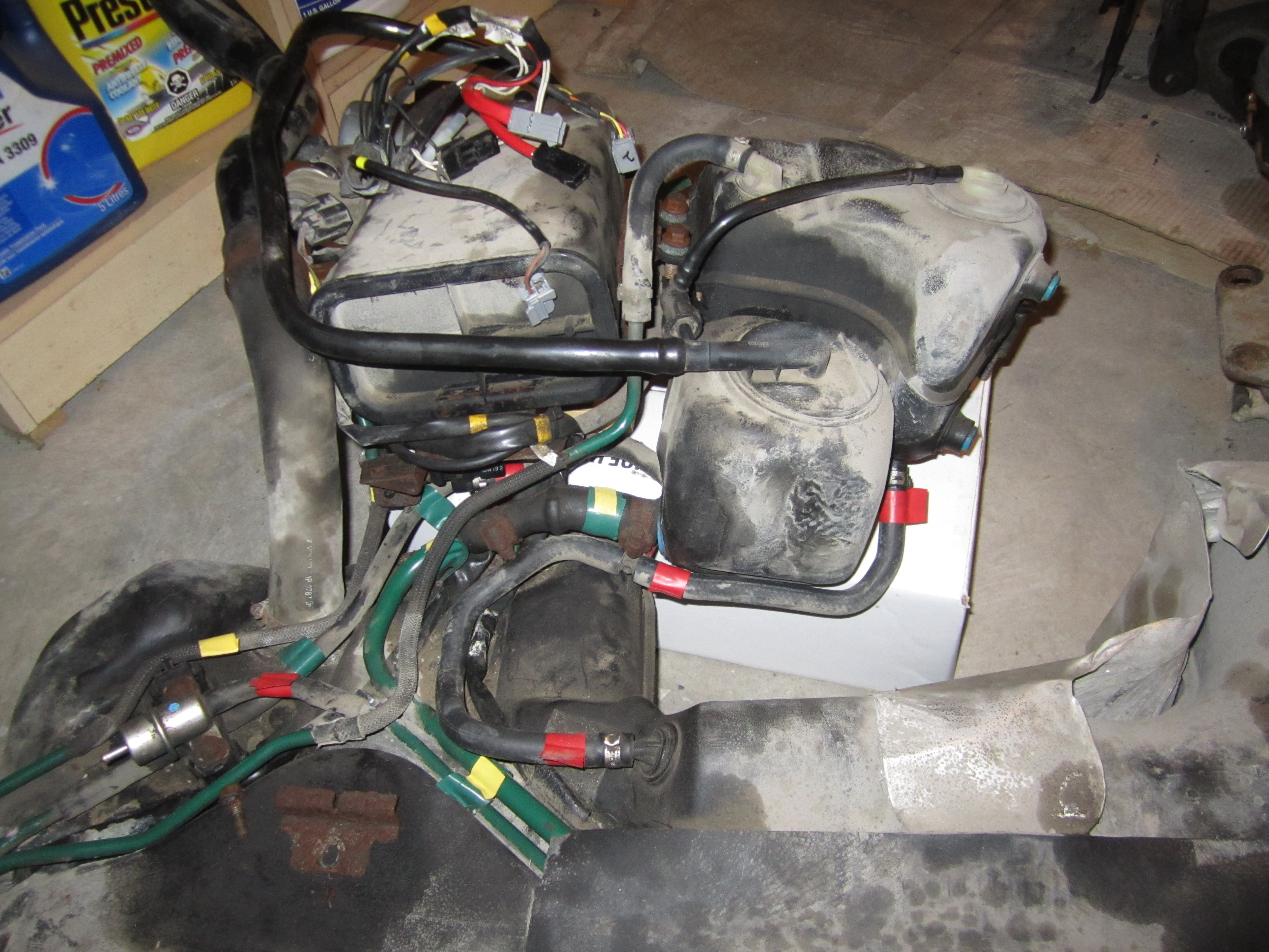

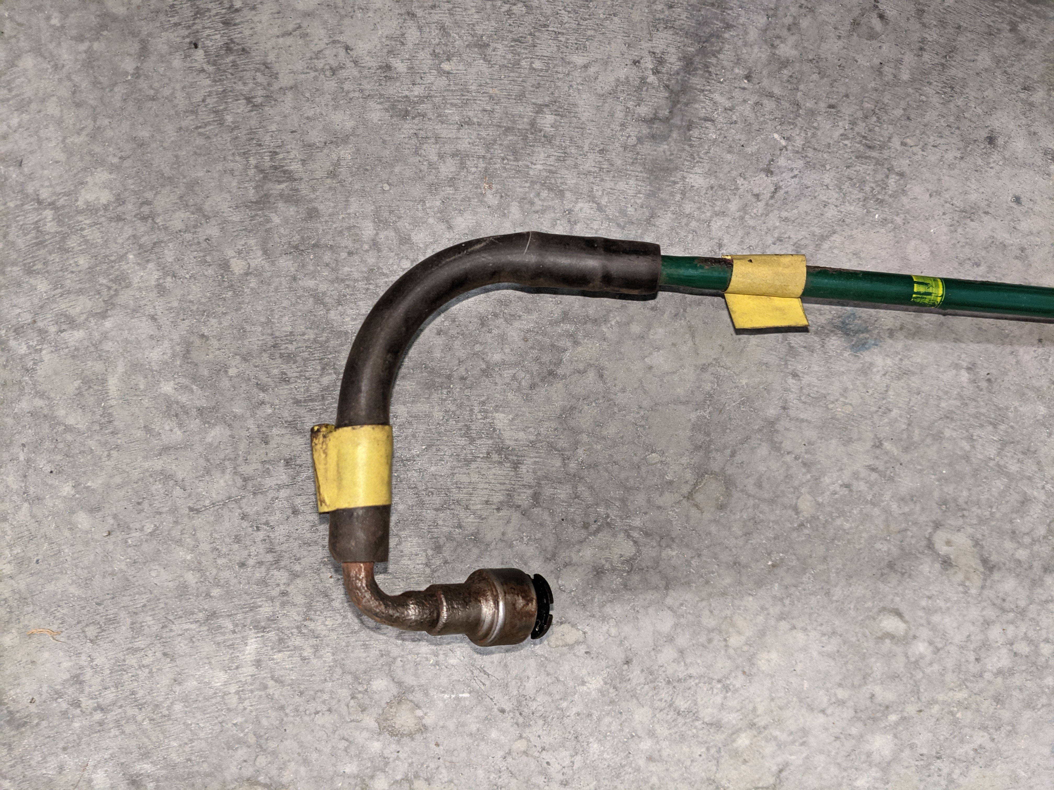

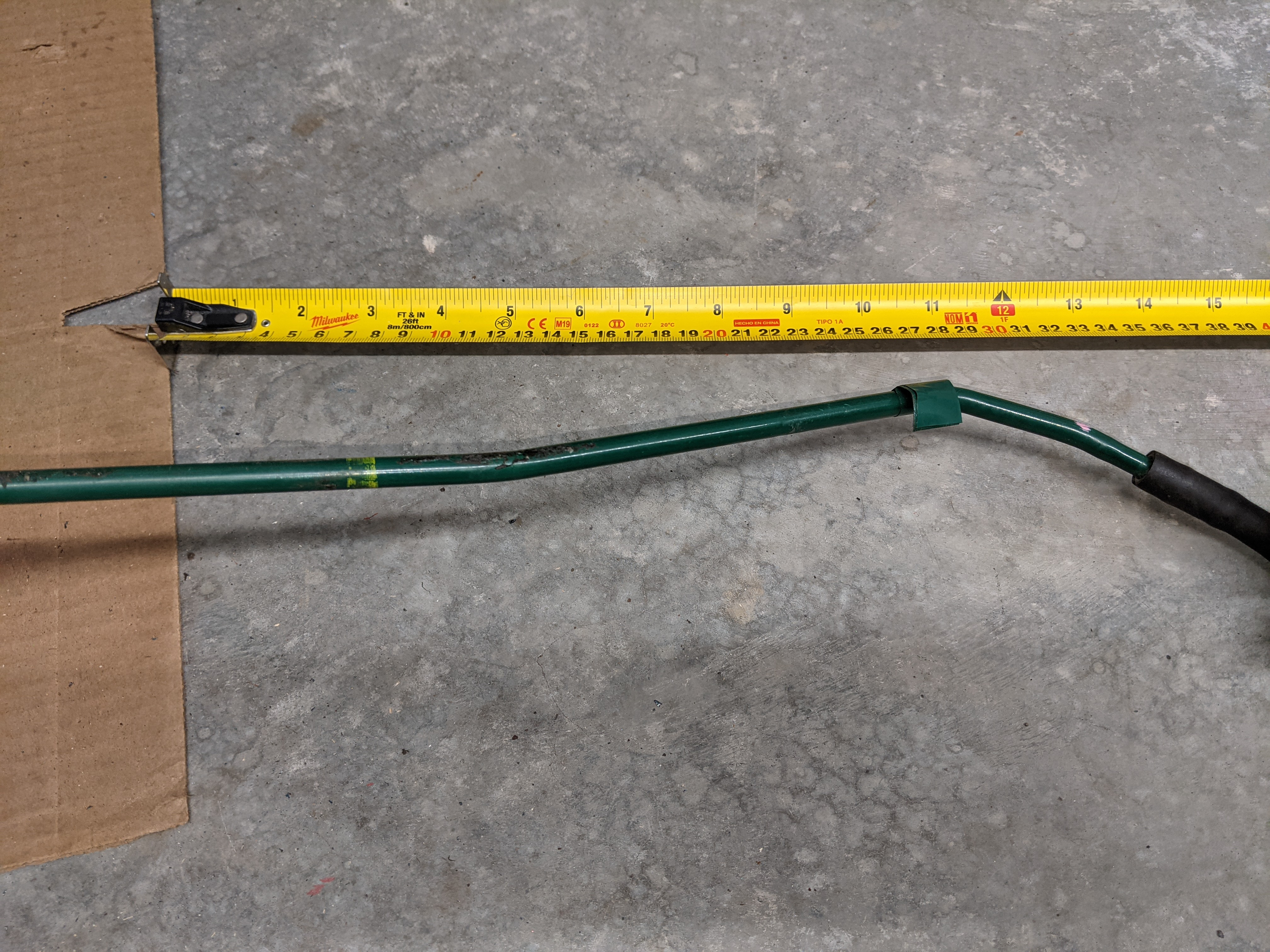

Continuing on. Last major pipe is the pipe from the RHS front of the fuel tank from the fuel pump and runs backwards over the tank to the fuel filter on the rear of the rear sub-frame.
Note: There is a Schrader valve on the pipe just above the RHS of the rear axle and forward of the fuel filter which is just inside the RH rear wheel.
You can see the Schrader valve in the above picture.
This center section of the fuel pipe has a protective wrap over it.
pipe connection to fuel tank

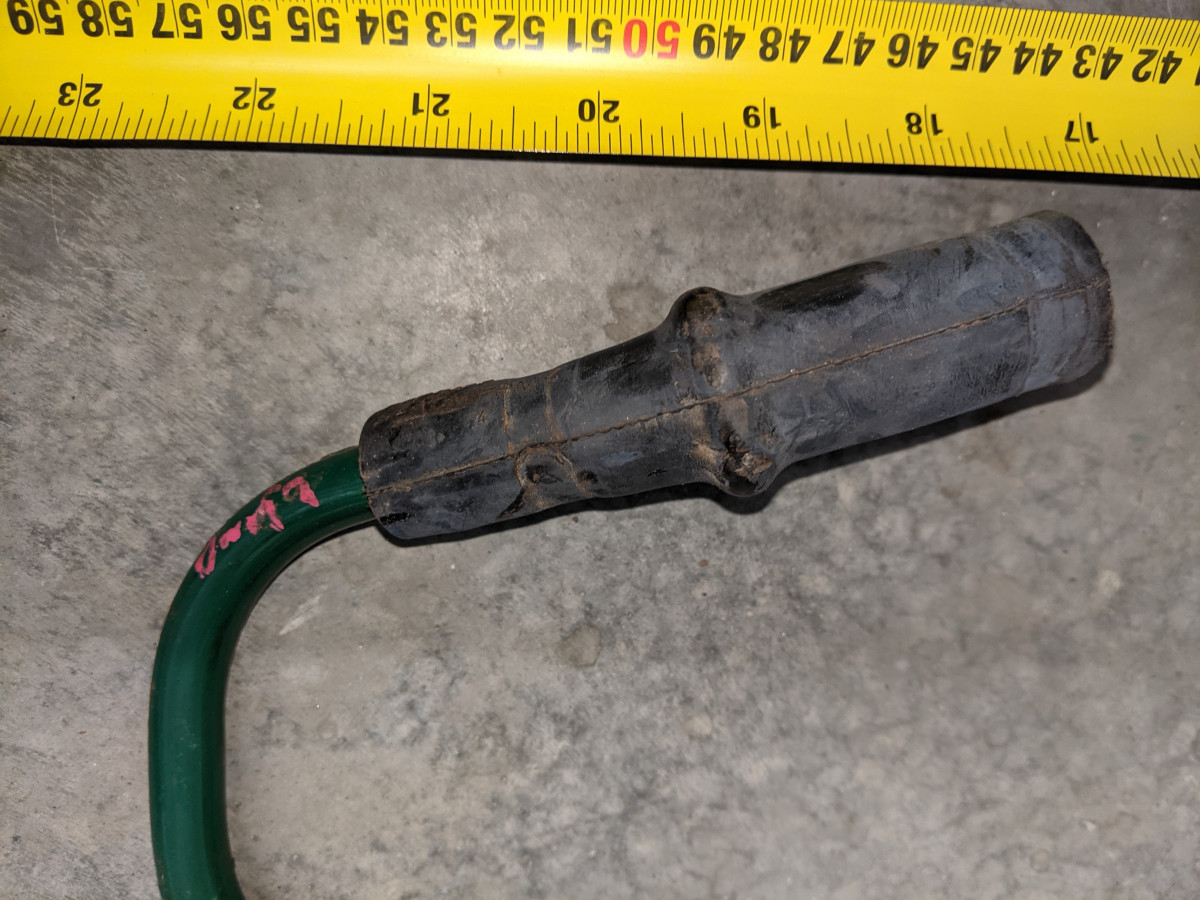

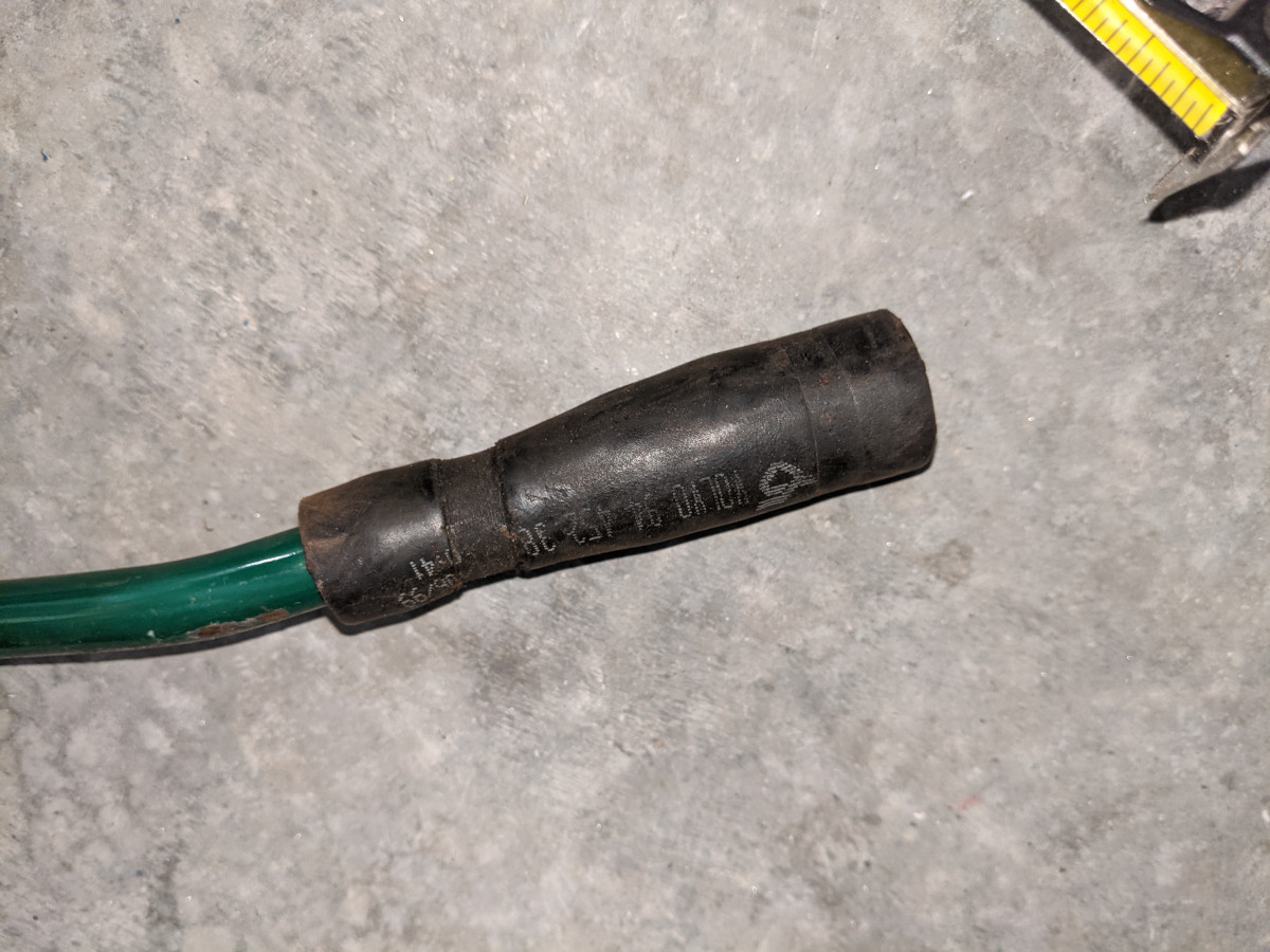

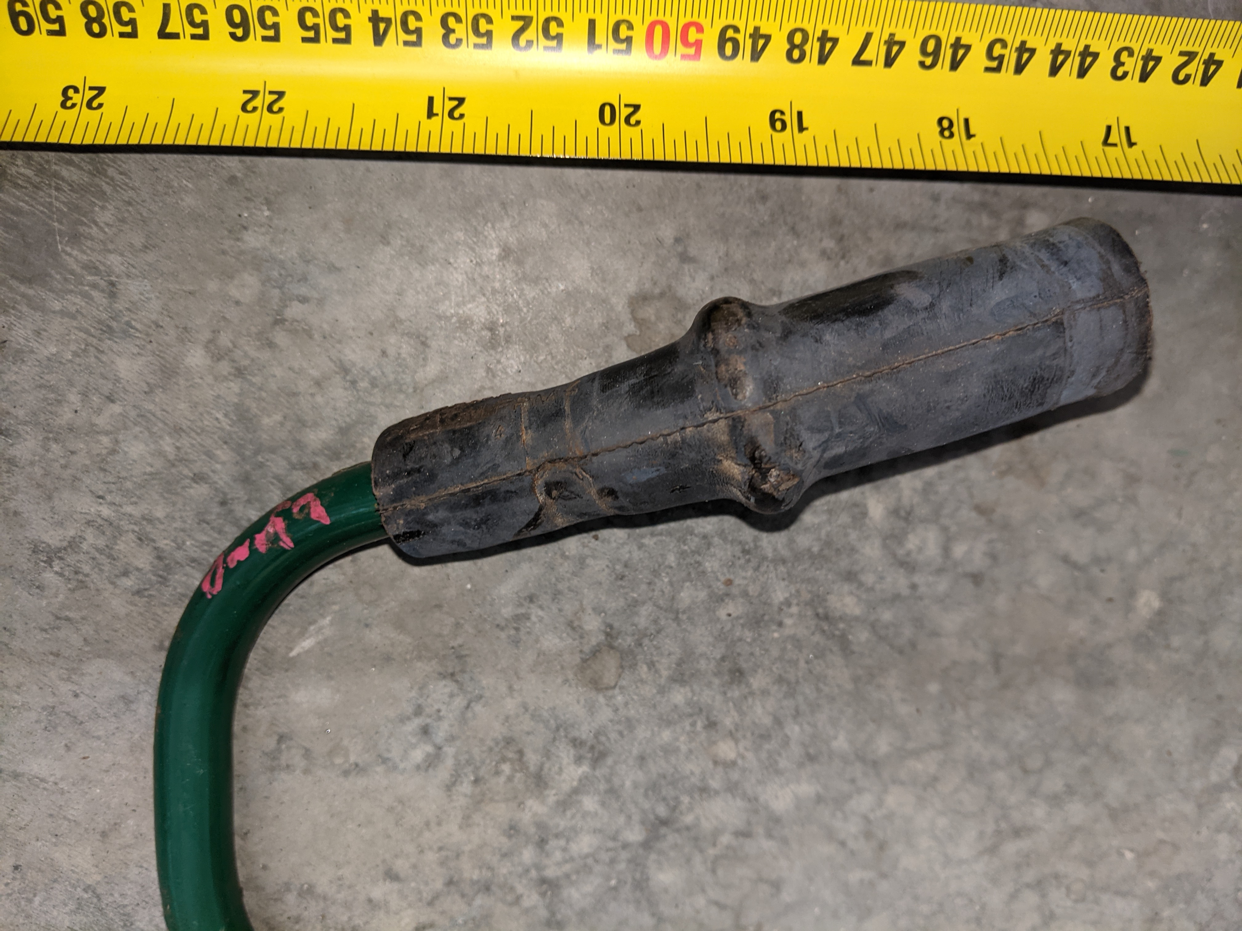

Emissions pipe on top of tank that is prone to failure:
There is a weird pipe on the top of the fuel tank to the rear that is I believe a overflow return. It has these weird cone shaped rubber bellow ends that tend to fail. Part is NLA. I have heard of people making thier own version using stepped diameters of pipes bonded together and clamped to the metal pipe
If you look carefully you can see the middle of the bellows looking crusty. These have been in my garage for about 4 years.
If you see the smaller tank closer to the camera there is a rusty clamp on the lower LHS of it in the picture. This is one end of the vent pipe which then runs under a cover to the center of the fuel tank top.
Hopefully this will be of help to other and naturally if there are any questions or further detail required please let me know.

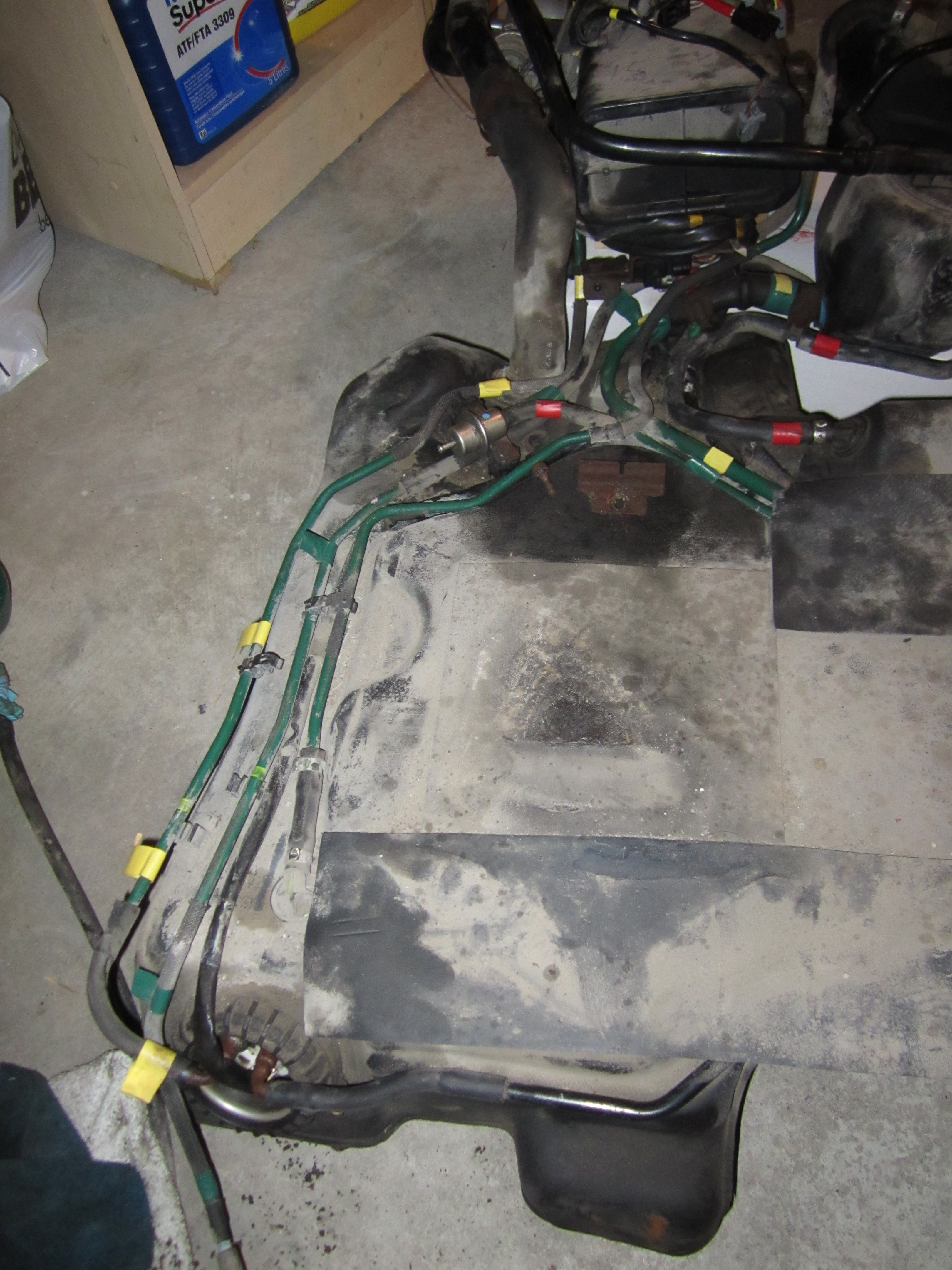

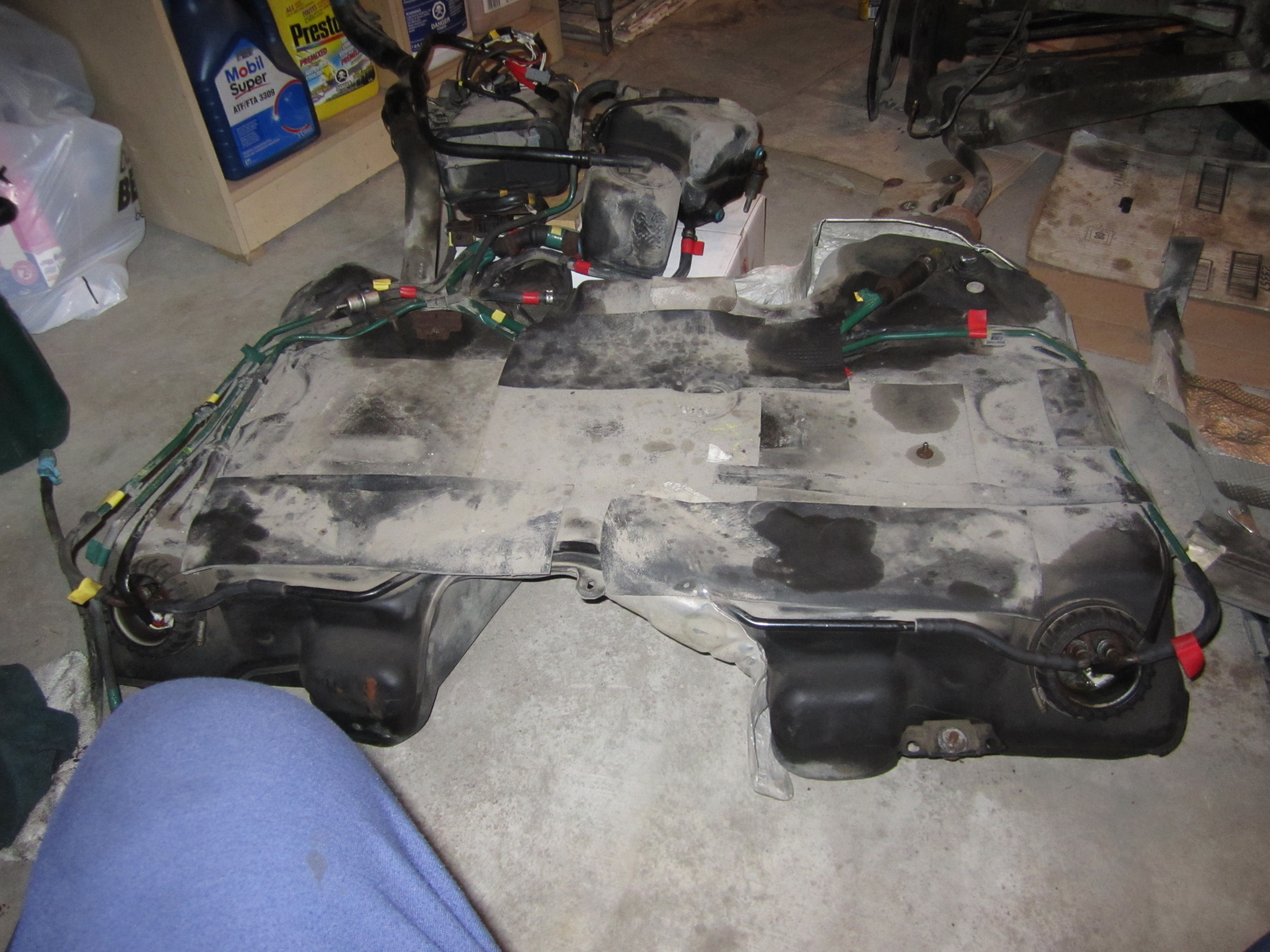

I've added a picture of the fuel tank viewed from the front of the car to help picture where the pipes go:

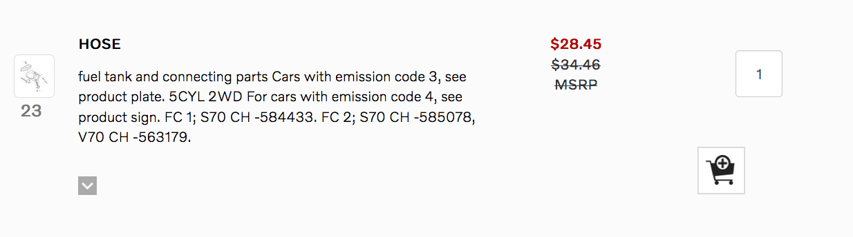

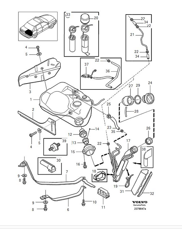

Update on the cone shaped peice above, NLA part ???? ( they dont even give you the slightest glimmer of hope on Volvo parts web store)
It looks like the FWD car version of this piece, number 23 can be adapted.

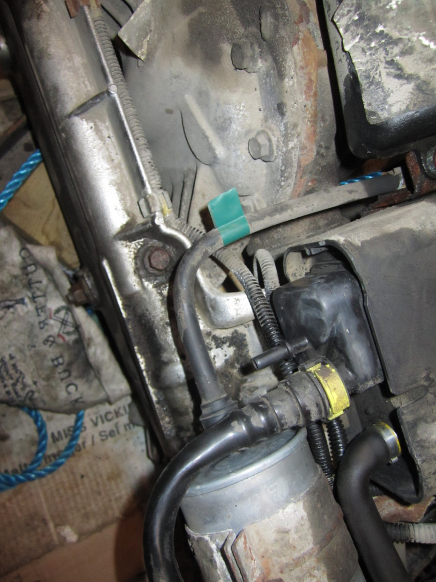

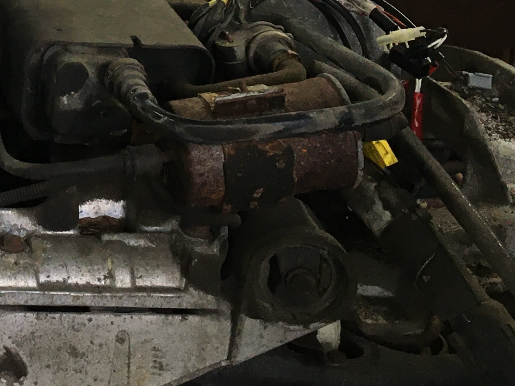

Having corresponded with abscate I need to add some more detail on the fuel pipes.
The pipe below:
The detail I missed with this is that it runs up the RHS of the carbon filter and connects to the RHS (when viewed from the rear of the car) of the fuel filter.
The other end (LHS) of filter is the feed line to the engine.
If you look at the fuel filter connector on both pipes the connector can only fit one way to the filter.
Abscate was confused as it looks like (subject to his confirming possibly tomorrow) his fuel filter may have been fitted backwards with the flange pointing to the RHS not the LHS.
I am assuming that which was fitted to my 2000 R was connected the correct orientation with the flange to the LHS as seen here:
These are the only pictures I can find showing the filter in place.
Hope this helps
The pipe below:

Yeah, mine is in backwards. I know these filters flow skinny -> fat end from opening them up, and my skinny end runs to front of car
On the fittings:
Maybe I will buy four lines from a junkyard to get the fuel pump fittings
2 on main fuel pump
2 on ejector pump.
On the fittings:
2 on main fuel pump
2 on ejector pump.
