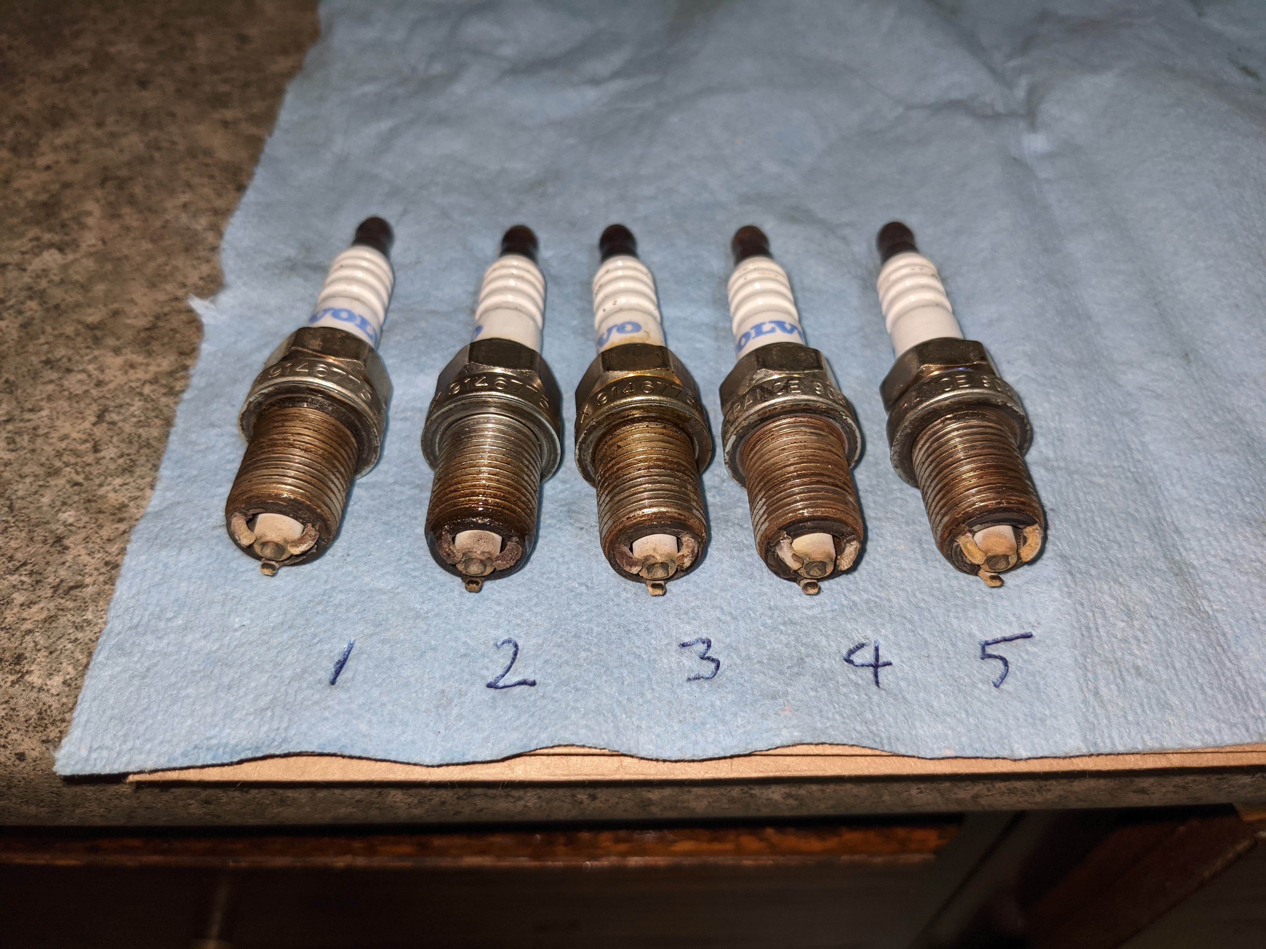

I just did a compression test and changed the spark plugs in my new-to-me 2000 V70 NA with 200k mi. What I found seems bad so I could use some help to interpret my findings.
Spark plugs:
Around the installed plugs, cylinder 2 had 1/2" of fluid and cylinder 3 had traces of fluid. Both plugs were tightly installed. Is this engine in trouble?
The cylinder 2 and 3 coil rubber cone had separated from the plastic base. Unbolting them from the head caused them to push away from the plugs. Does this matter?
Installing the new plugs gave me about 20% more power. I had no misfires or DTC codes before doing the work.

Thanks. I'll be checking the plugs probably every 1000 miles to see if that oil returns. I removed the cylinder 2 fluid before unscrewing the plug, yet still the plug electrode was dripping with fluid inside the cylinder. The top of the engine had lots of oil which pushed out of the fill cap, so maybe it dripped around the plugs from above? I replaced the oil cap and will clean the PCV soon.

Cylinder #2 and #3 get the oil from the leaking filler cap seal or a loose or split PCV pipe to the head.

Thanks, this really puts my mind at ease. There was oil at the rubber seal around the cylinder 2 coil, so it seems likely that it came from the oil filler, not up from the piston. This is a huge relief. On with the restoration I go.
