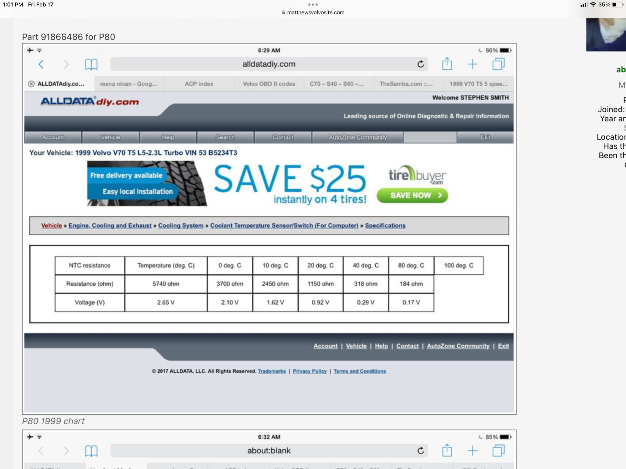

The 1999 coolant temperature resistance specs are here, the table is formatted badly, shift the cells so thst temp and resistance are aligned

Thanks a lot! Just checked the resistance on the fully warmed up car. On sensor socket terminals the resistance is 18.3 kOhm. This number seems to be much more than 318 Ohm in the table.
But still how does the dashboard gets correct readings? 18.3 kOhm seems to be well below absolute zero...

It is strange. With the car cooled down I've re-checked the resistance and it seems to be at around where it should be. I read 1012 Ohms, the engine feels warm on touch. And the resistance according to the table is between 20C and 30C.

I've re-taken the measurements in the morning after the car has been cooling down overnight.
Cold engine: R=3330 Ohm.
Hot but thermostat closed: R=350 Ohm.
Hot, thermostat open: R=224 Ohm.
It kept holding fan on for a long time up until I've erased the error code. After that the car seems to got back to normal. The fan only turns on when it is hot and thermostat is open and stays on for ~30 seconds at a time.
So I cannot reproduce those 18 kOhm resistance I measured yesterday anymore. The error code doesn't get back, at least not yet as of today...

Yes you are totally right! I didn't actually convert Ohms to degrees C. If I do so based on the table I get 241 Ohms corresponds to approximately 63C. and 274 Ohms to around 53C. Resistance doesn't go any lower than 241 Ohms. Both 63C and 53C seems to be a little bit too low temperature for a fully open thermostat.
