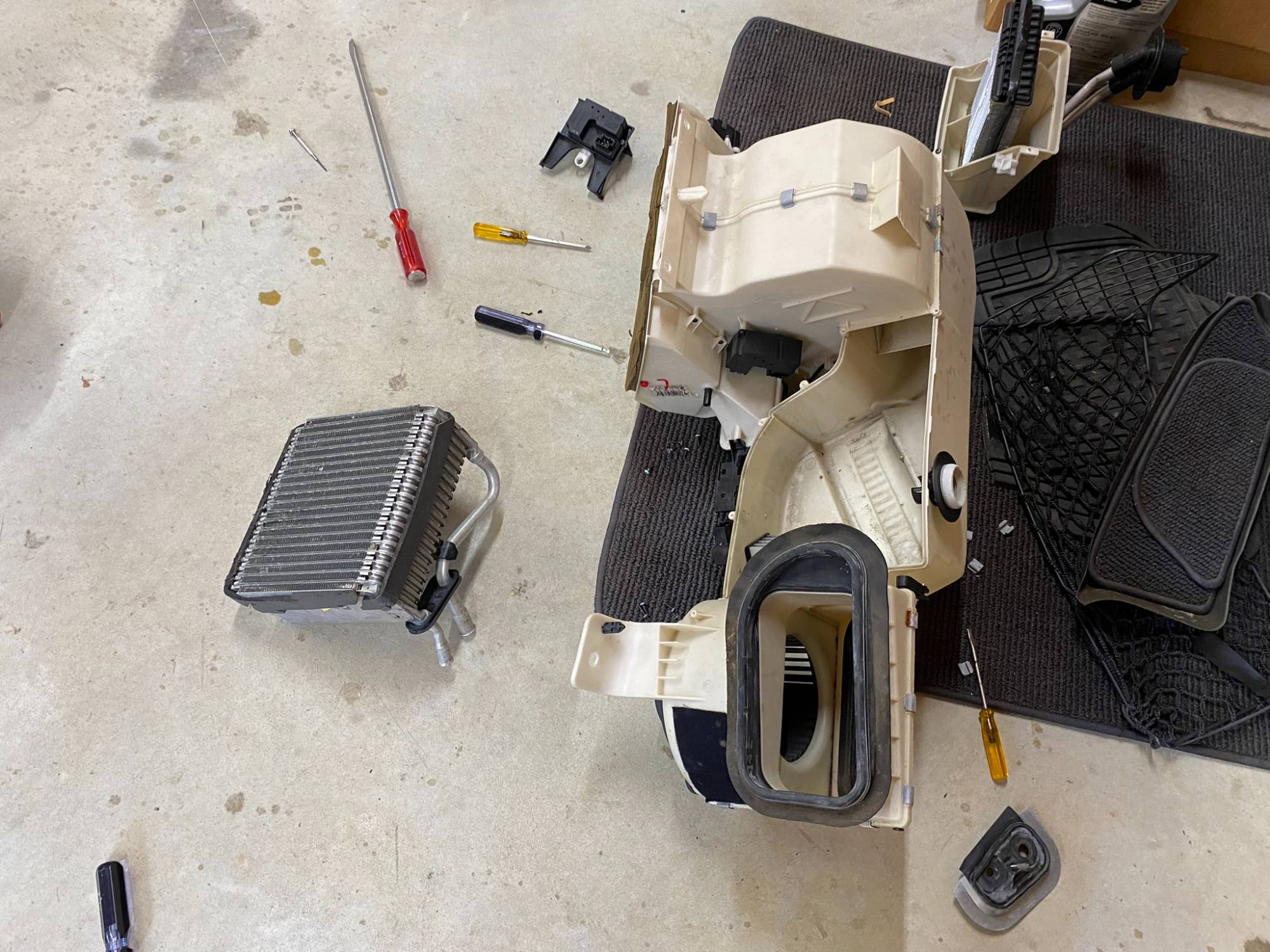

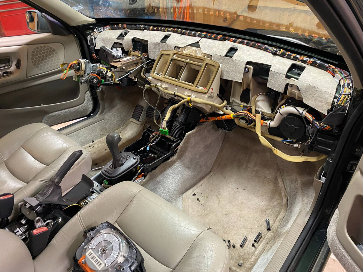

So it’s time to take this thing apart and replace the evaporator and blend door flap. Everything is almost ready to come out, but I can’t for the life of me figure out how to get these evaporator lines off. System is drained, the bolt by the headlight is out, and I have the quick disconnect tools, but no matter how hard I pull on the damn thing, nothing moves. Anyone have any tips or tricks?
Edit - got them off - turns out wiggling and pulling gets them off eventually. Anyone have any idea how to get them back on?

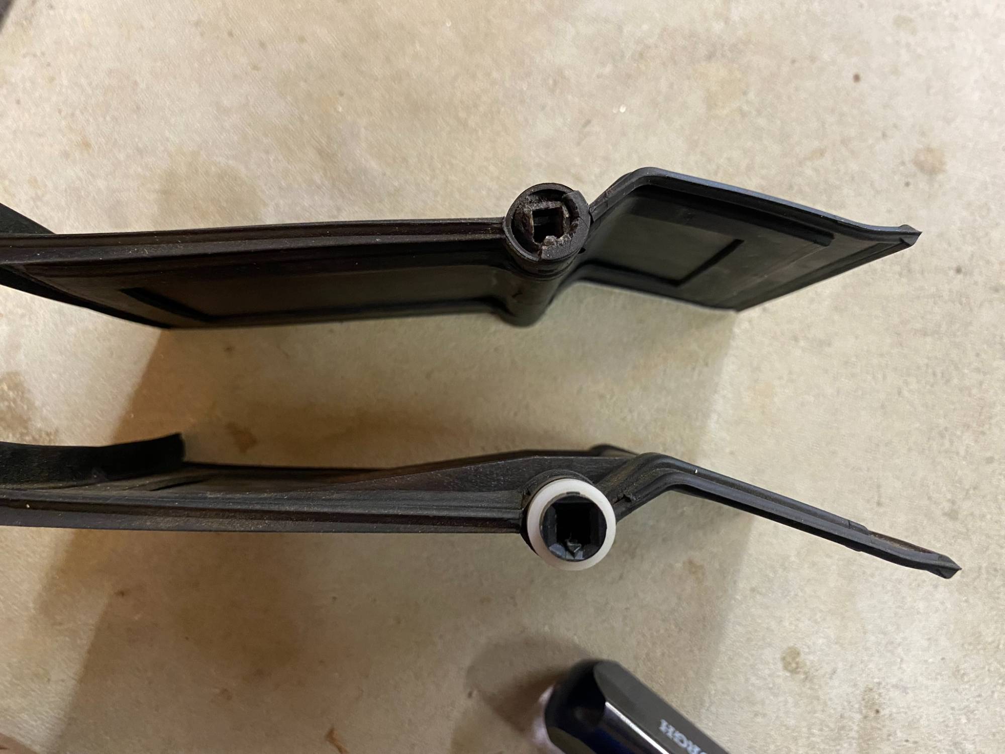

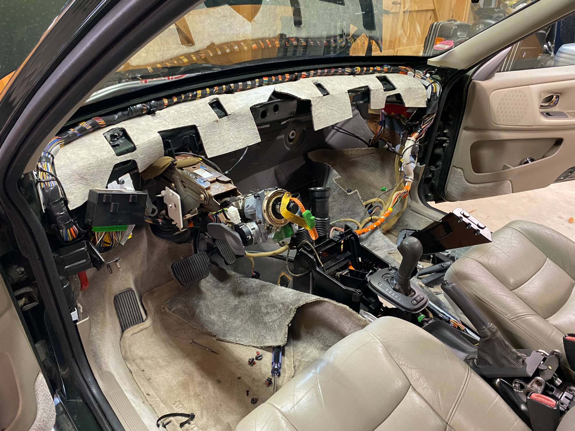

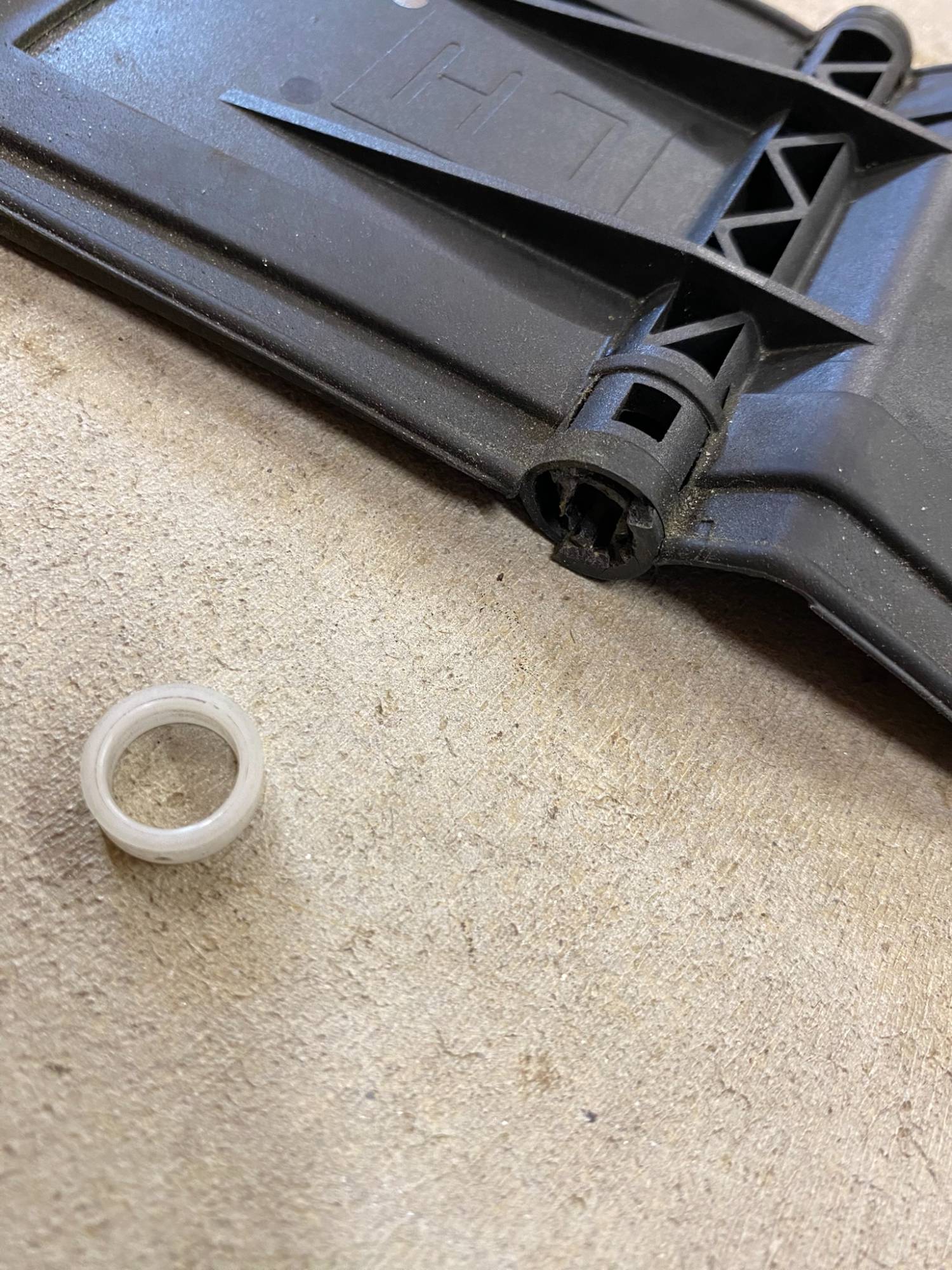

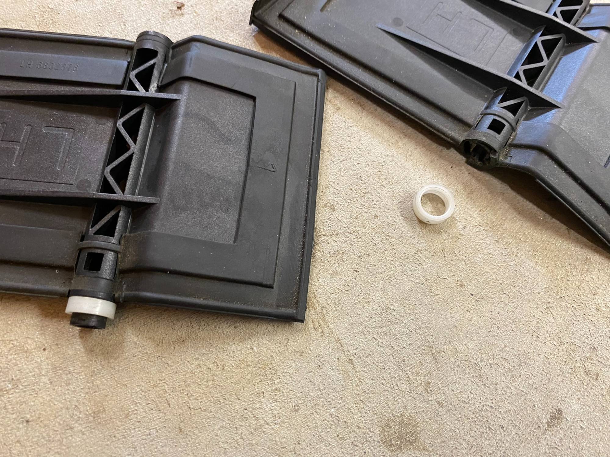

And it's fixed!!!!!
Turns out the end of the blend door was completely sheared off and wouldn't allow the motor to engage with it whatsoever, and it was loosely flopping around in the case.
I'm incredibly happy to finally have the climate control figured out. After months of fighting with it, I now have full control over the temperature in the car. The blend door from Alex's '98 partout and non-broken flap from my '99 parts car is what ultimately ended up doing the trick. While it was apart, I also replaced the evaporator since I have a leak somewhere. In the coming days I'll also replace the receiver/drier and get it charged to get this thing fully to 100%.
Some interesting things I learned through this process:
Despite sharing part numbers, there appears to be early and late blend door actuators. Multiple motors from a '99 (that worked well in the car they came from) wouldn't work in my '98 and threw an error code, despite having the same part number. As far as I can tell having taken both a '98 and '99 P80 AWDs apart, the cars are more different than they are similar, occasionally without a reason or indication of that being the case.
The HVAC case is surprisingly put together in a way that it's not very difficult to replace individual doors, though it is tedious. I elected to take this route as opposed to swapping boxes with my parts '99, as I don't want to evacuate that AC system to remove it completely since I don't have the equipment, and swapping all the motors and other items over would have been a pain.
Massive shoutout to all the work @xanthefin has put into the 850 OBDII app as a direct result of my car's issues. It was a big help in ultimately diagnosing this car and figuring out the year split oddities with the blend doors. Also thank you to everyone else who helped me through this process.
And some pictures of what's hopefully the last climate-related surgery I'll have to do inside this car for a long time.
