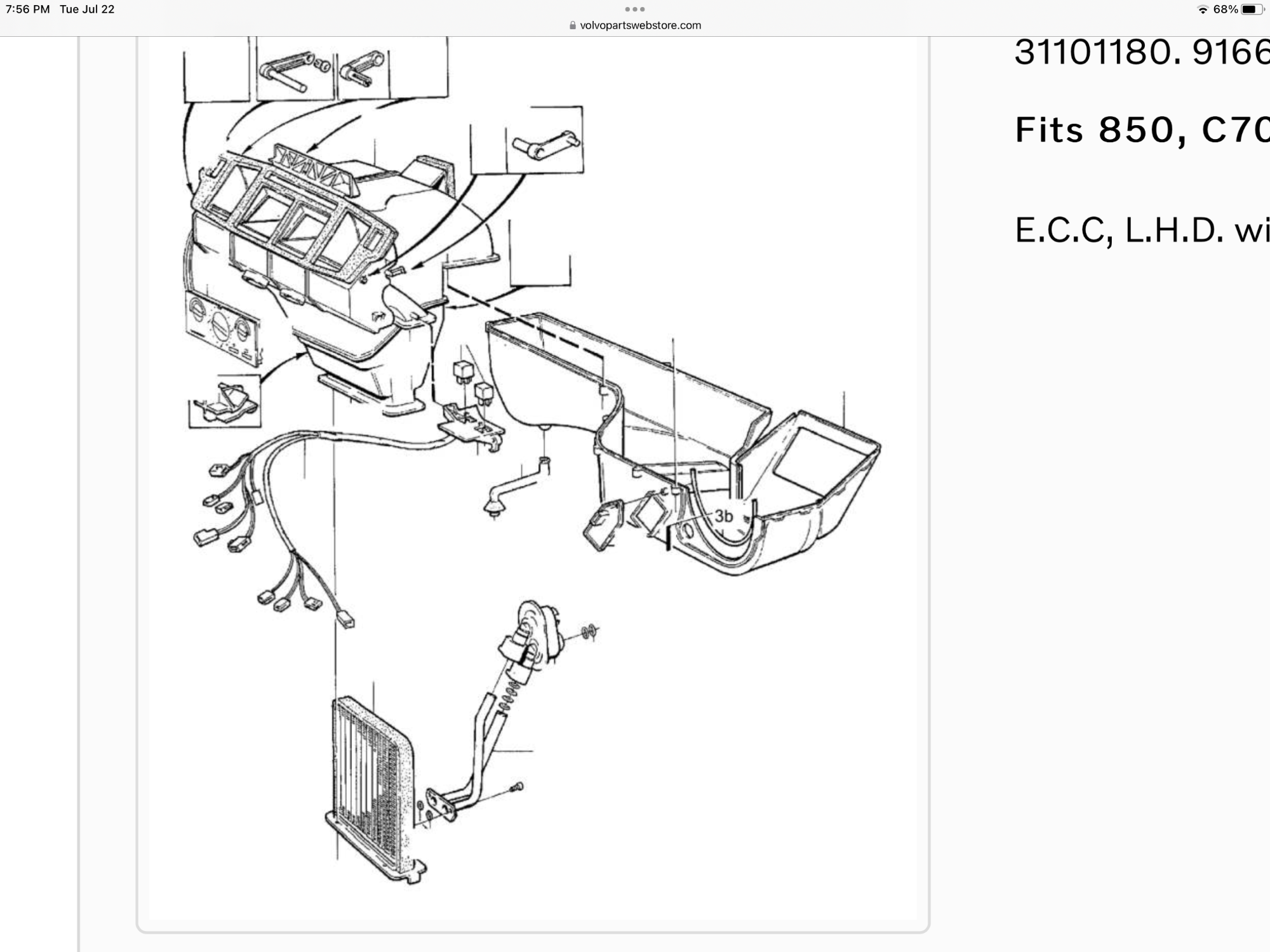

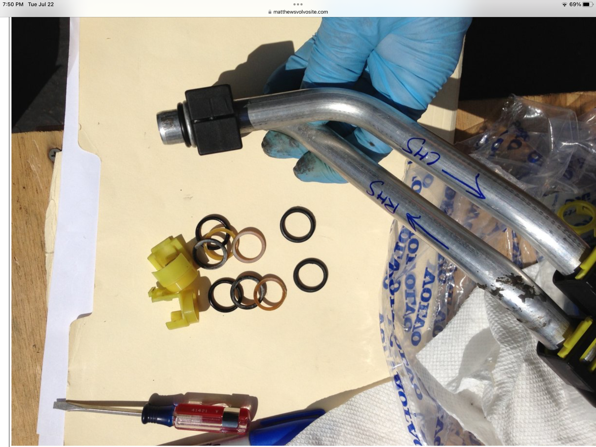

Couple of pictures documenting the orings that go on the heater pipes. These are poorly documented in the Volvo exploded diagrams
Each pipe has two orings and two hard plastic spacers
