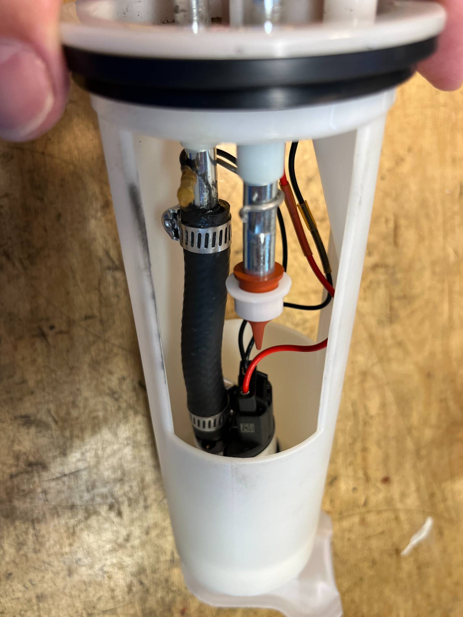

Disassembly of the unit is pretty straight forward. Once you have the pump assembly out of the car, three things need to be done to get the old pump out.
First undo the electrical connector.
Secondly undo the clamps on the fuel tubing.

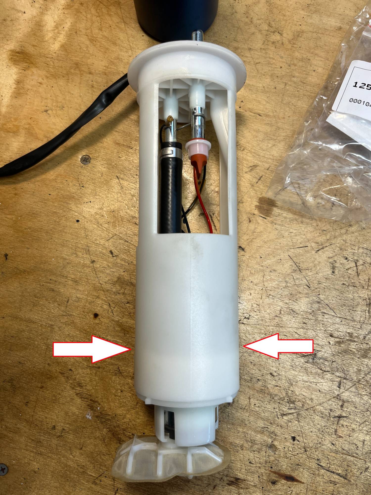

Lastly you will have to push in 2 tabs on the bottom of the assembly, which will then enable you to slide the pump insert out the bottom. They are in the location of the arrows in this photo:

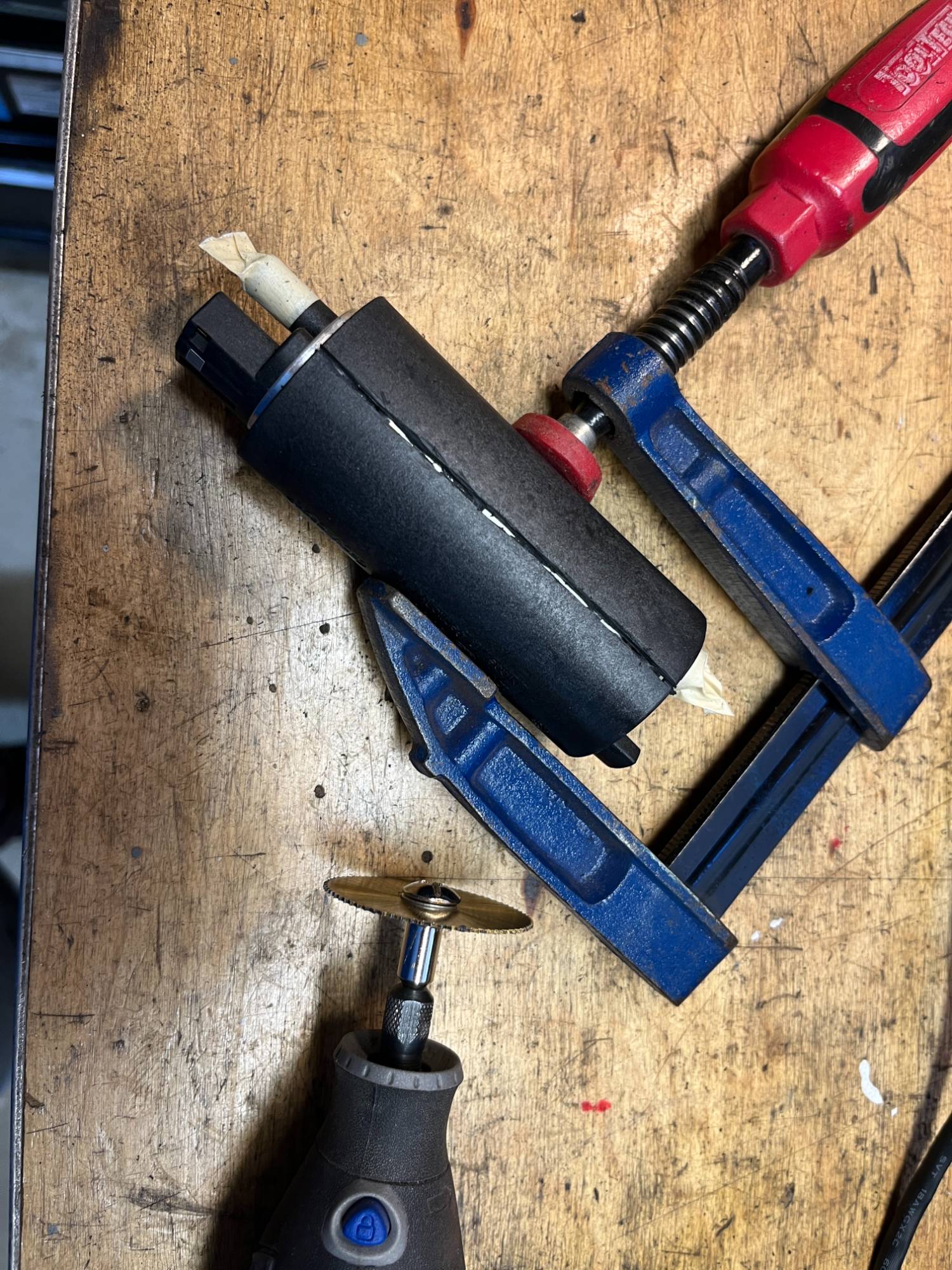

The Bosch pump comes with a plastic sleeve, which has to be removed. I did 2 cuts with a Dremel, about 180 deg apart. This way the housing will come right off. I sealed off the intake and output port with painters tape so no debris can get inside the pump.
On the intake side there need to be a few more cuts. This is needed so the plastic tube where the filter screen attaches stays in place.
