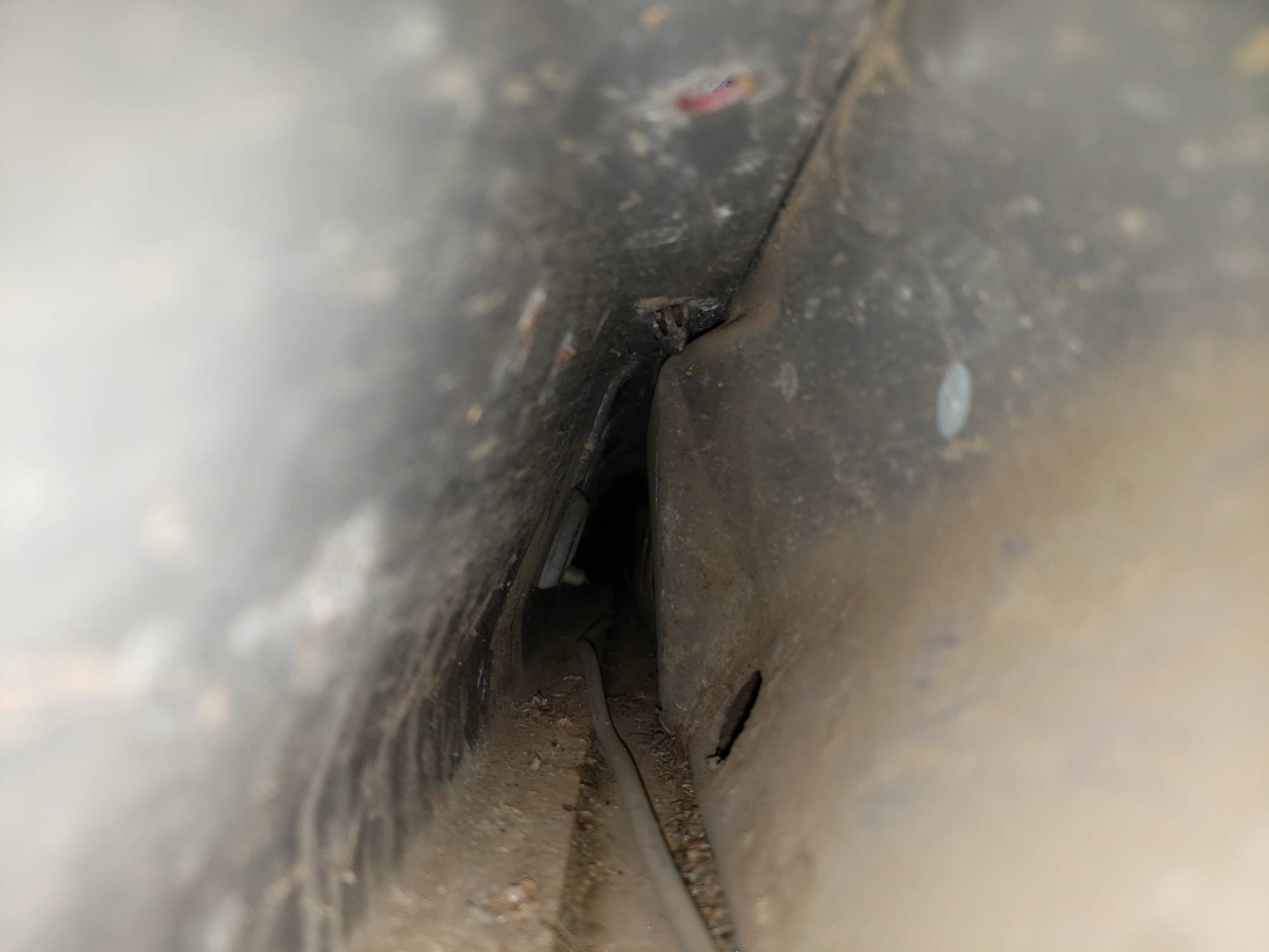

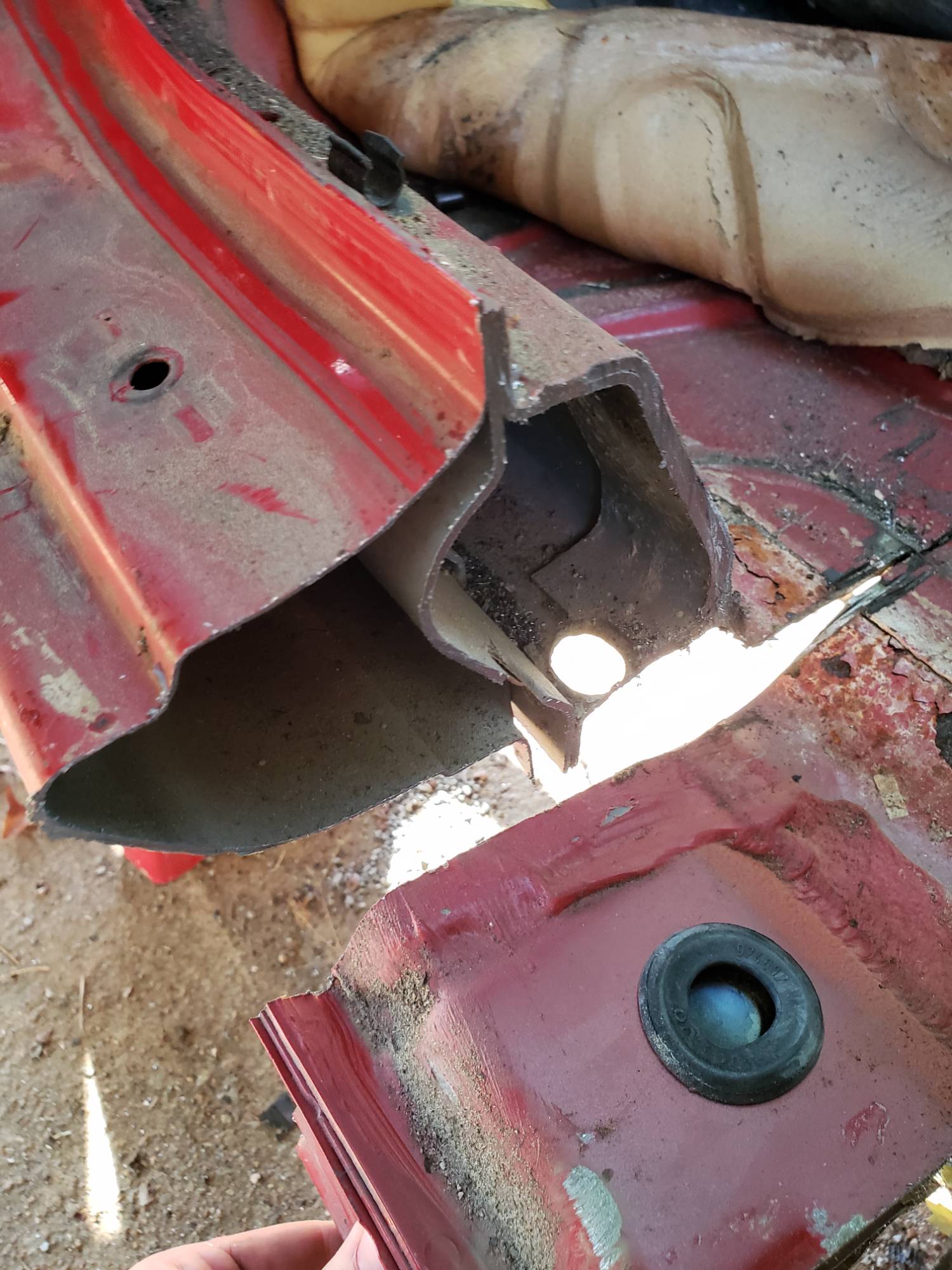

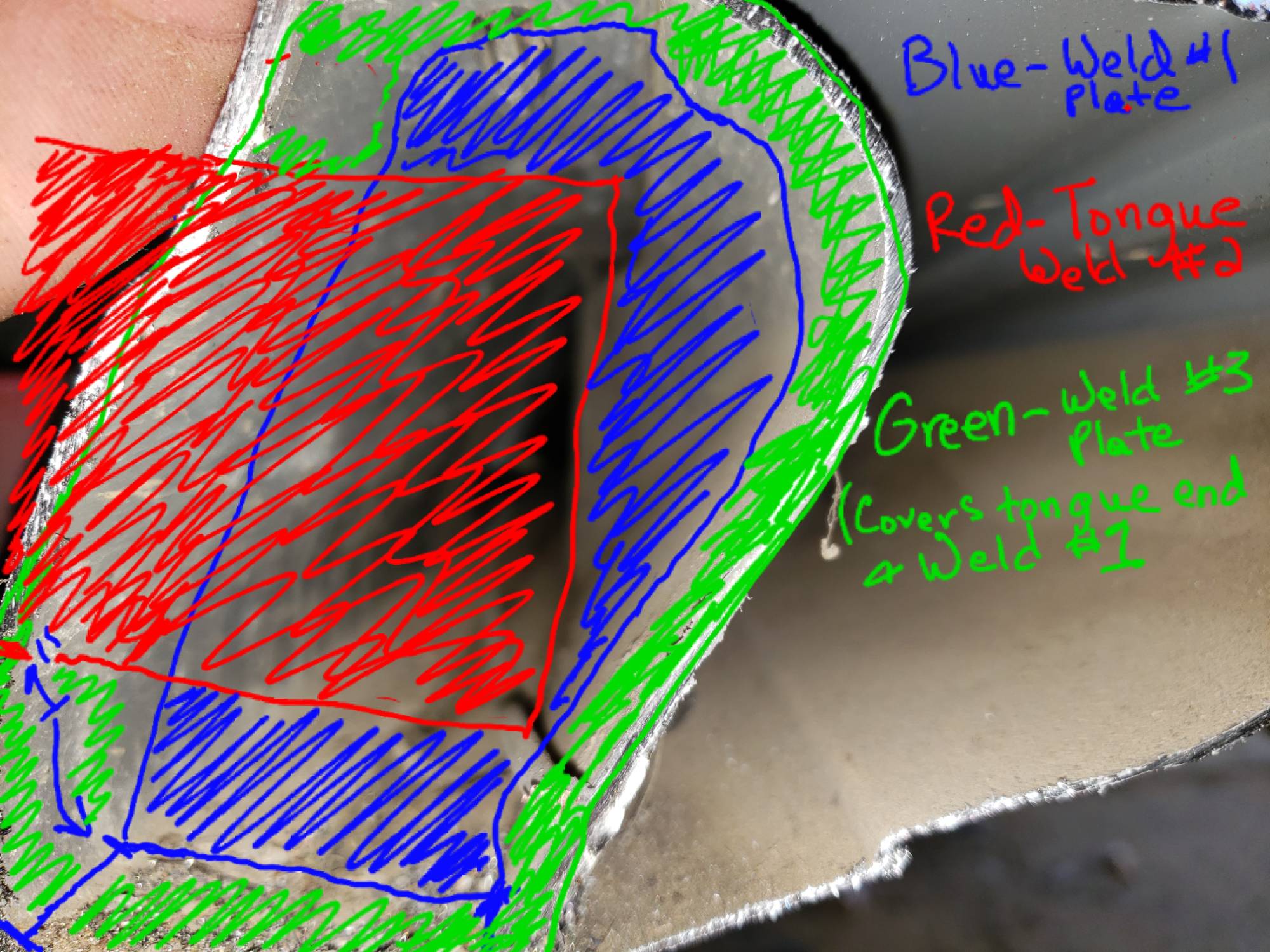

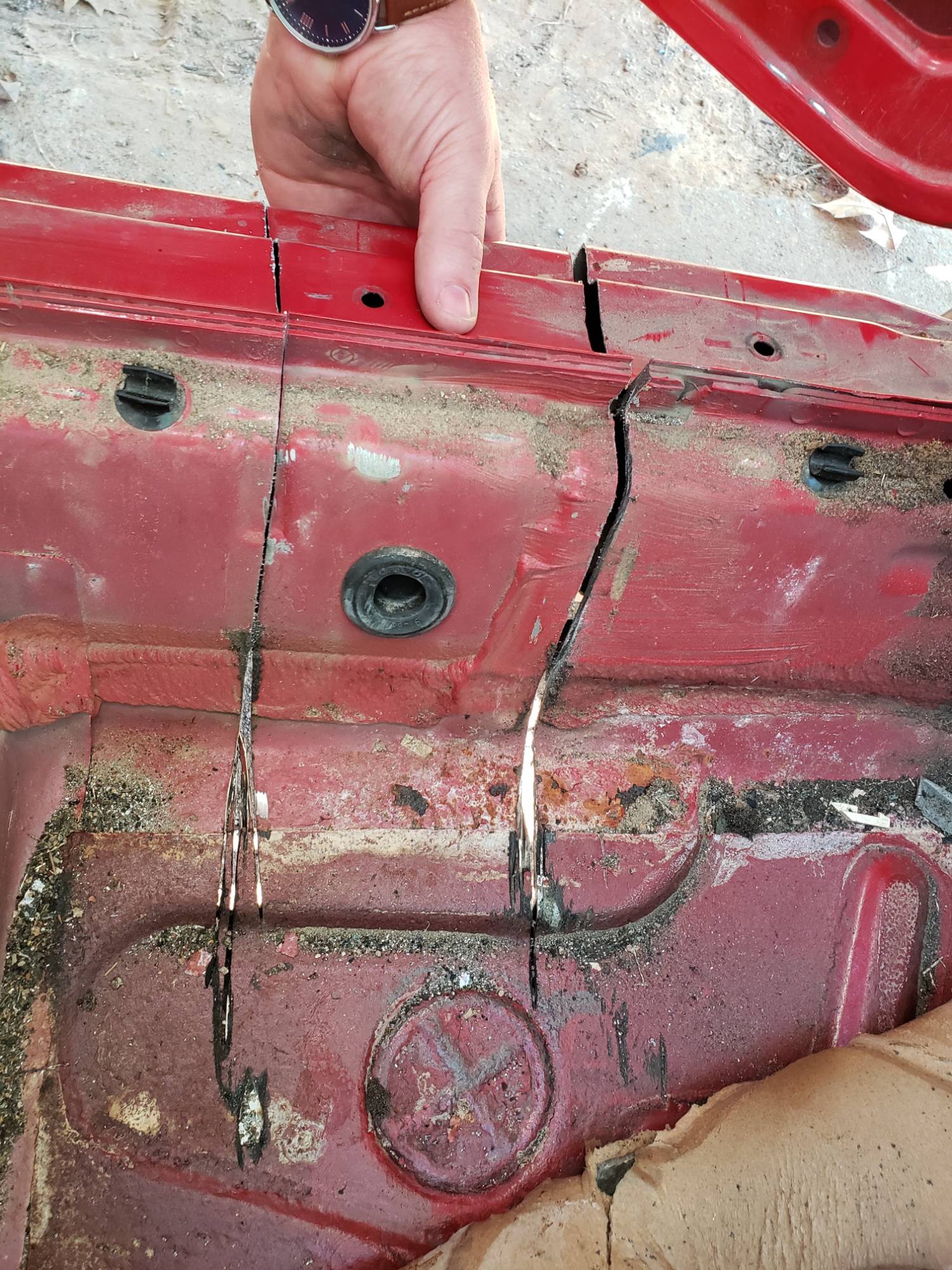

I did the test cut on the front driver side frame/chassis rail. See attached pics.
Angled frame rail means I'll slide in a foot or two of 2"x3" tubing on both sides (angled) with 1" of free space on the end, then screw them into place, then weld that end closed. That will leave 1" of frame rail to weld on the beginning of the tongue. After that i can weld the 1" closed. Later I will upload a rough demo sketch with the test cut. Also I will hopefully show a full size chalk drawing of the tongue on my driveway. By using chalk, someone is bound to think I'm drawing hopscotch or butterflies. 😜🤪🤓😆😎
Edit: I took a couple pics of inside the frame rail. There's a lot of structural stuff and not enough room for a 2x3 so I think I'll do the 1" weld and patch. That'll be plenty of rigidity.

Look at the thickness of that rocker steel. Thats Volvo for Life , right there.

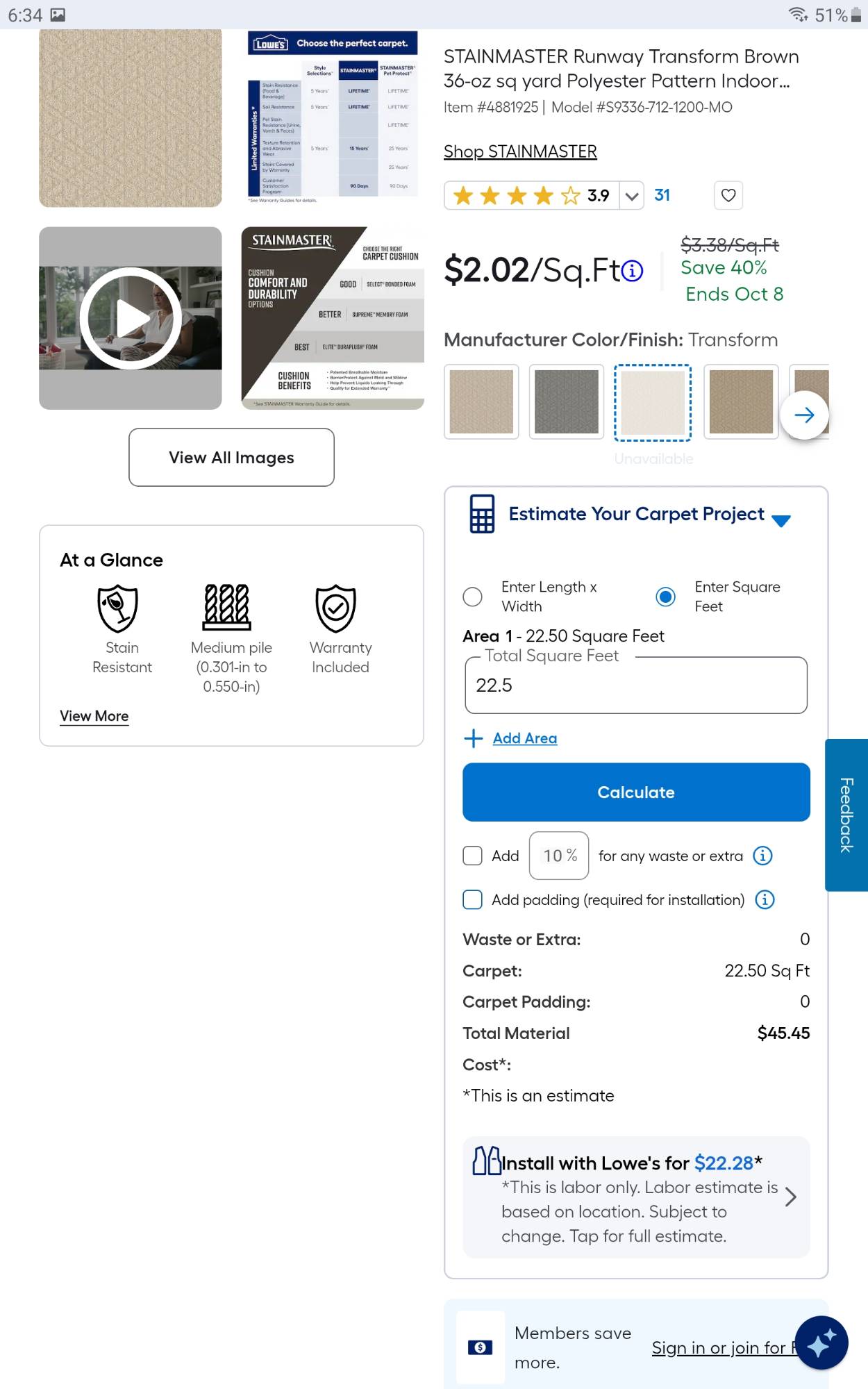

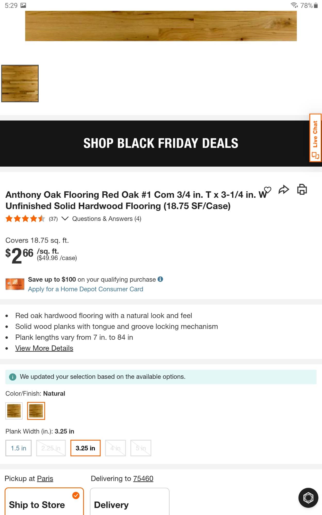

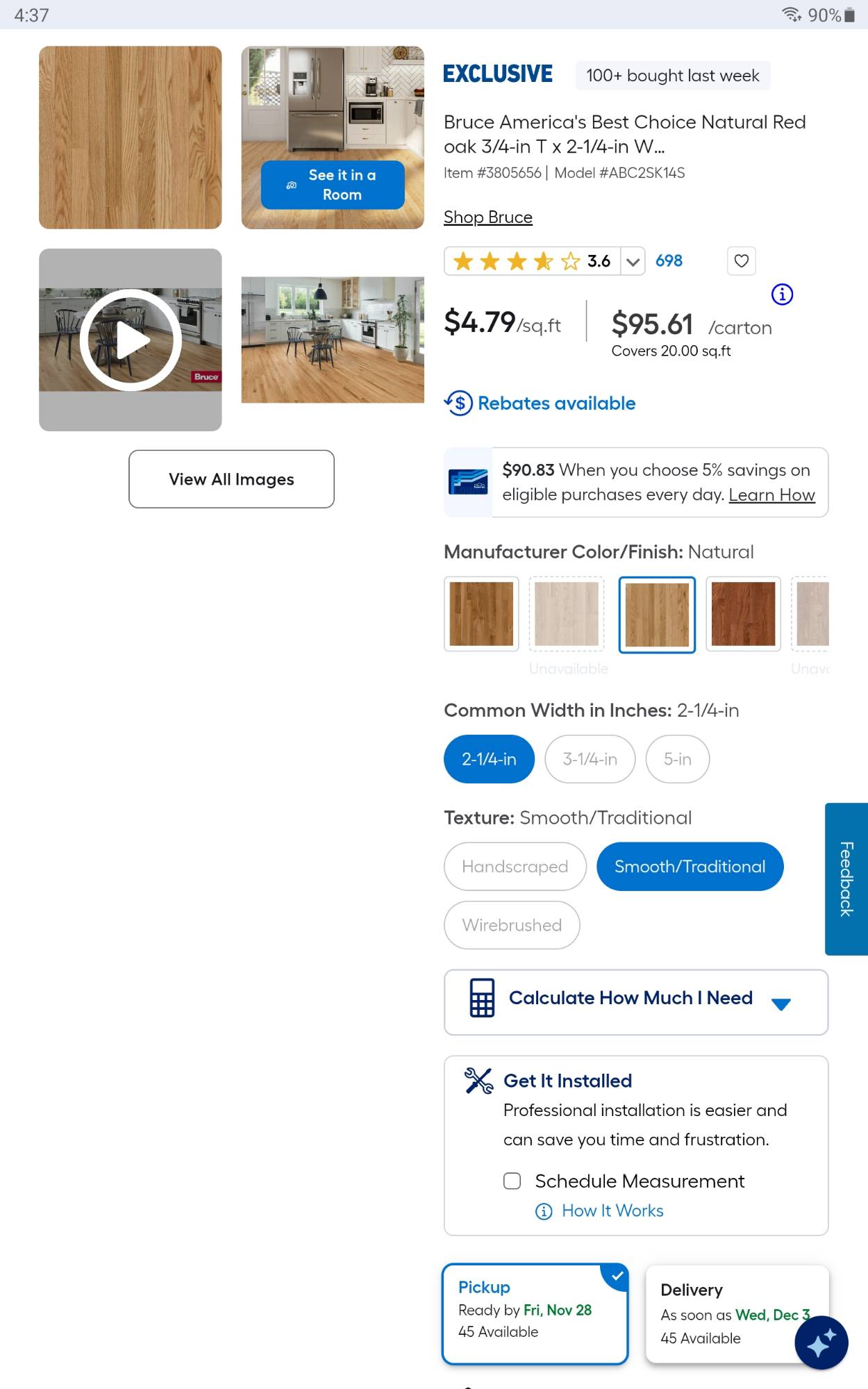

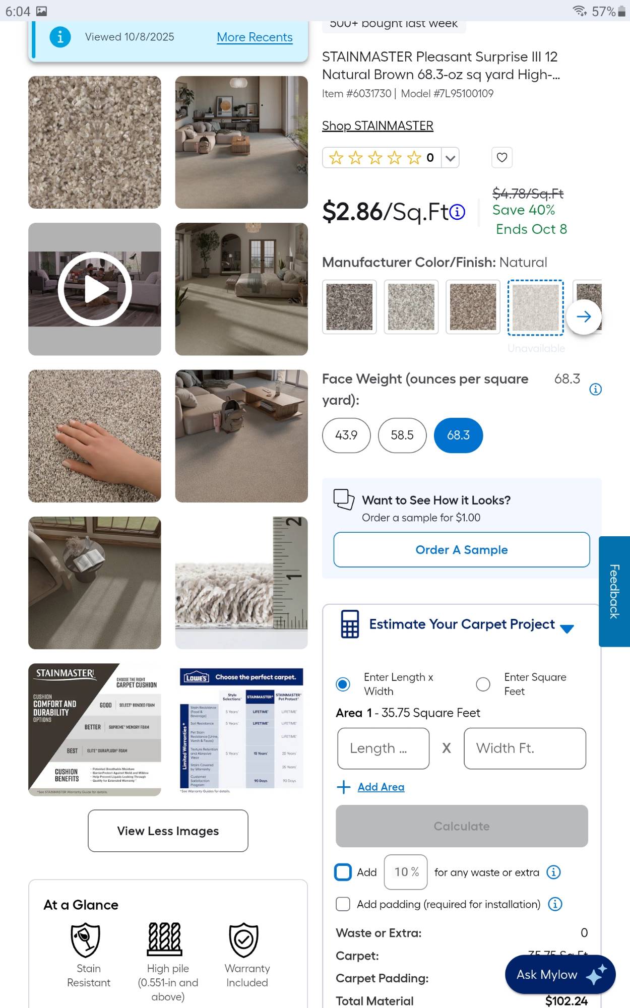

In the pics you can see the things I've looked at and worked on. Those are carpet and hardwood options I have picked out, which I will get samples of. My minor/mild depression is keeping me from picking cooler/darker colors. Dark rustic bamboo is so cool. But I'll stick with lighter oak I think. I've got sort of a development going on with the Volvo factory trunk floor boards. Once I get the next step prepped, I'll record another video. I'm considering (DIY) tye-dyed curtains because I can't decide on 1 particular color.

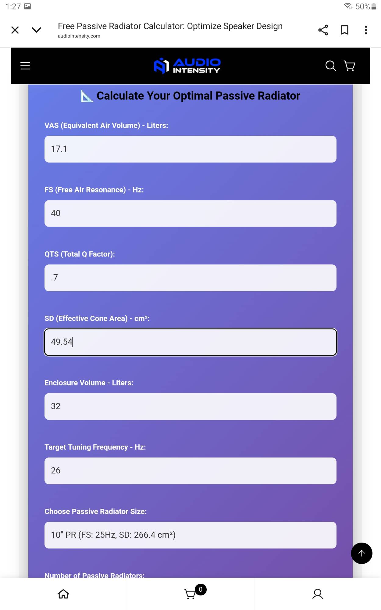

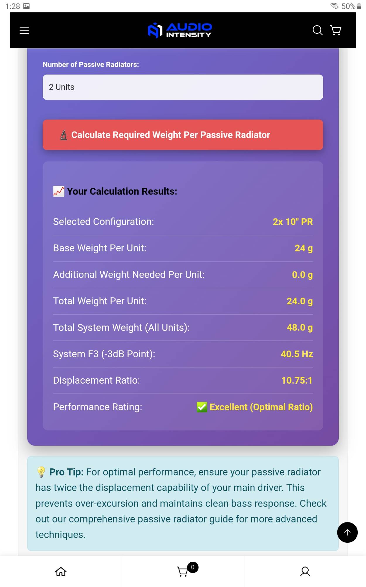

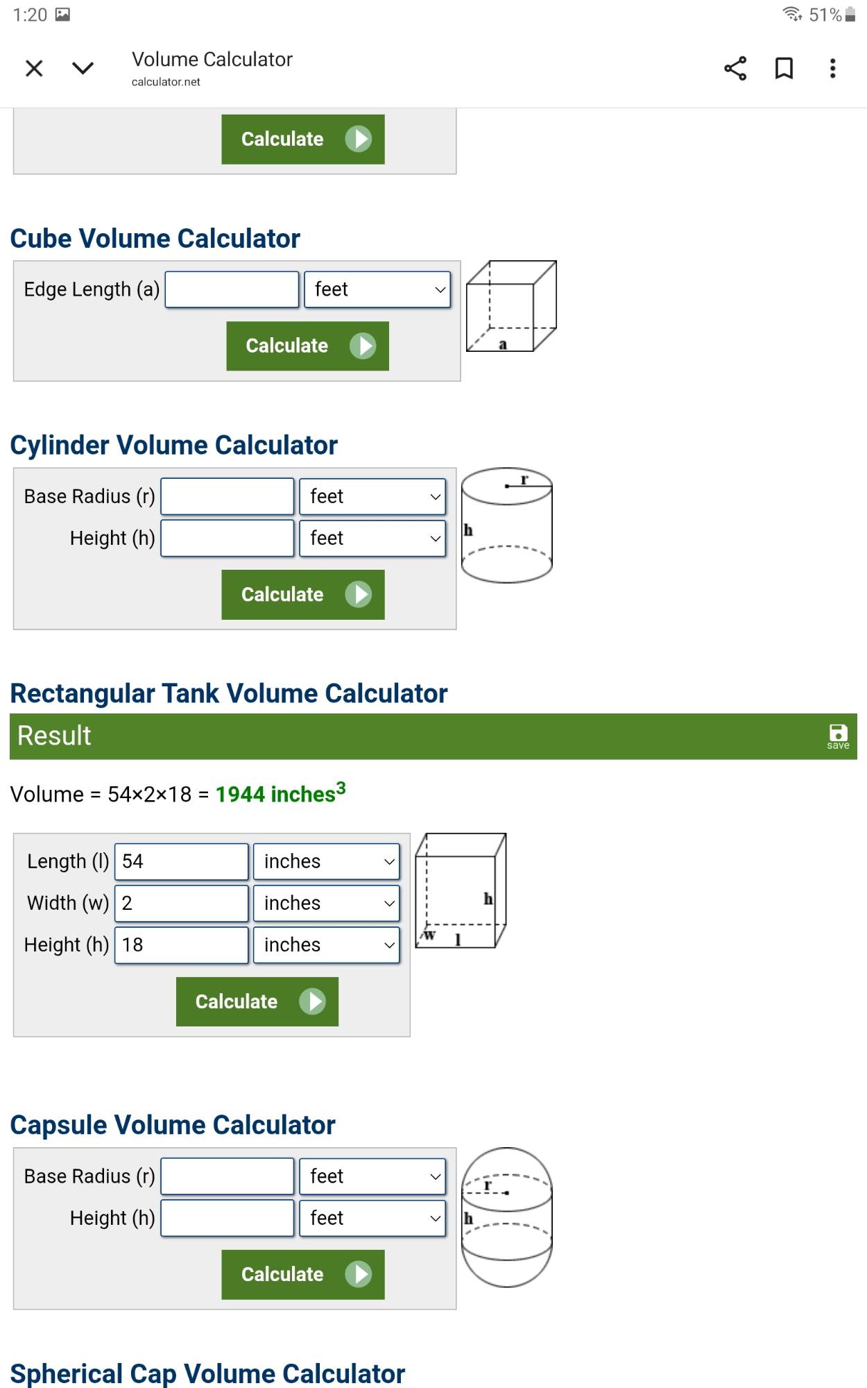

The calculator you see says 2x 10s. That's the pair of passive subwoofer radiators. The set of 3 subs including those 2 rads will be a part of the thinnest sealed 'enclosure' ever made, I guarantee. I won't specify anything about that (except the word 'integrate') because it'll be super cool. All speakers (despite being 3 brands) will follow a particular theme and will match. My hope for the bass setup will be to have more sound quality (SQL) than bump (sound pressure or SPL) so productions like Zombieland and The Mask will be more immersive. Yes I'm going to attempt to store a 'small' TV. The batteries I've picked out (not bought yet) are crazy powerful and I'm excited to show them during the unveiling a few months from now.
