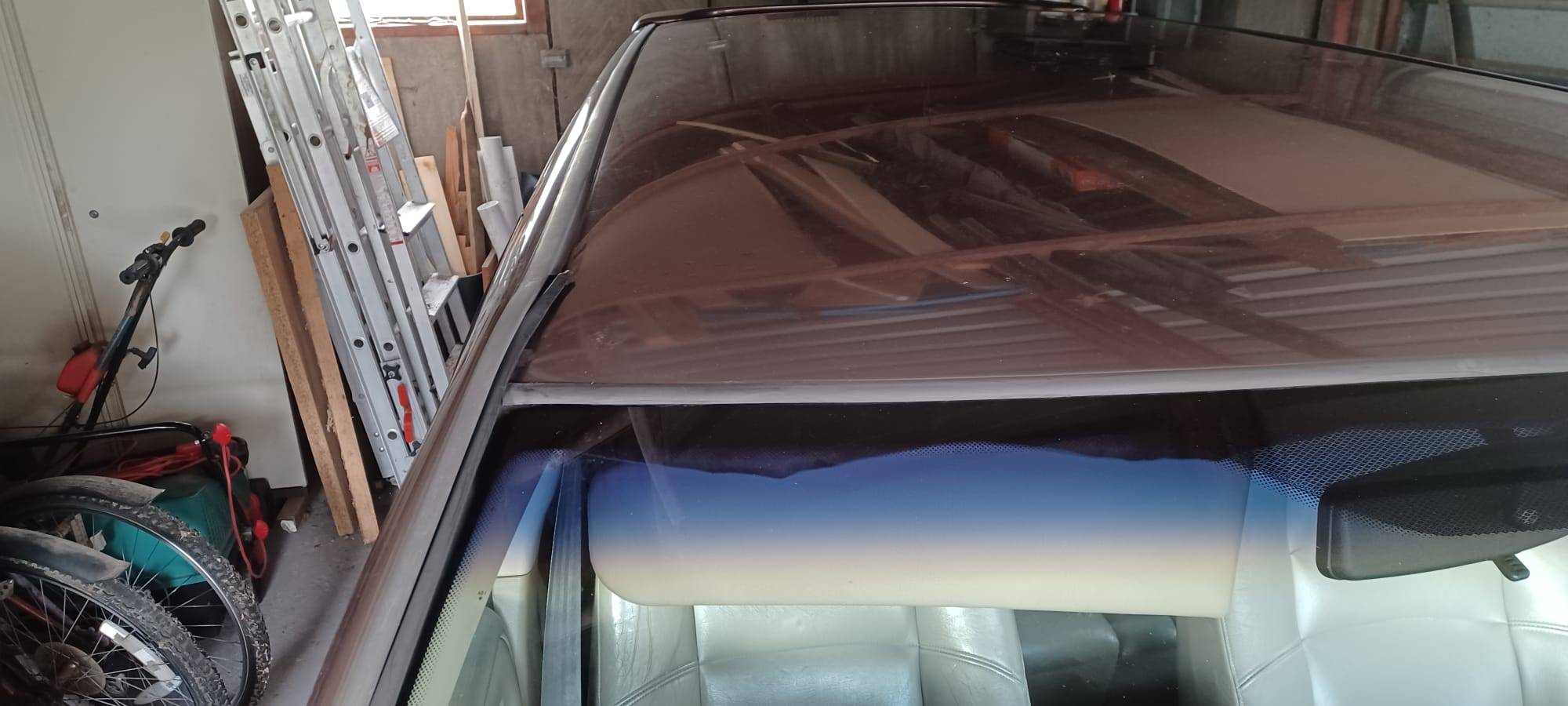

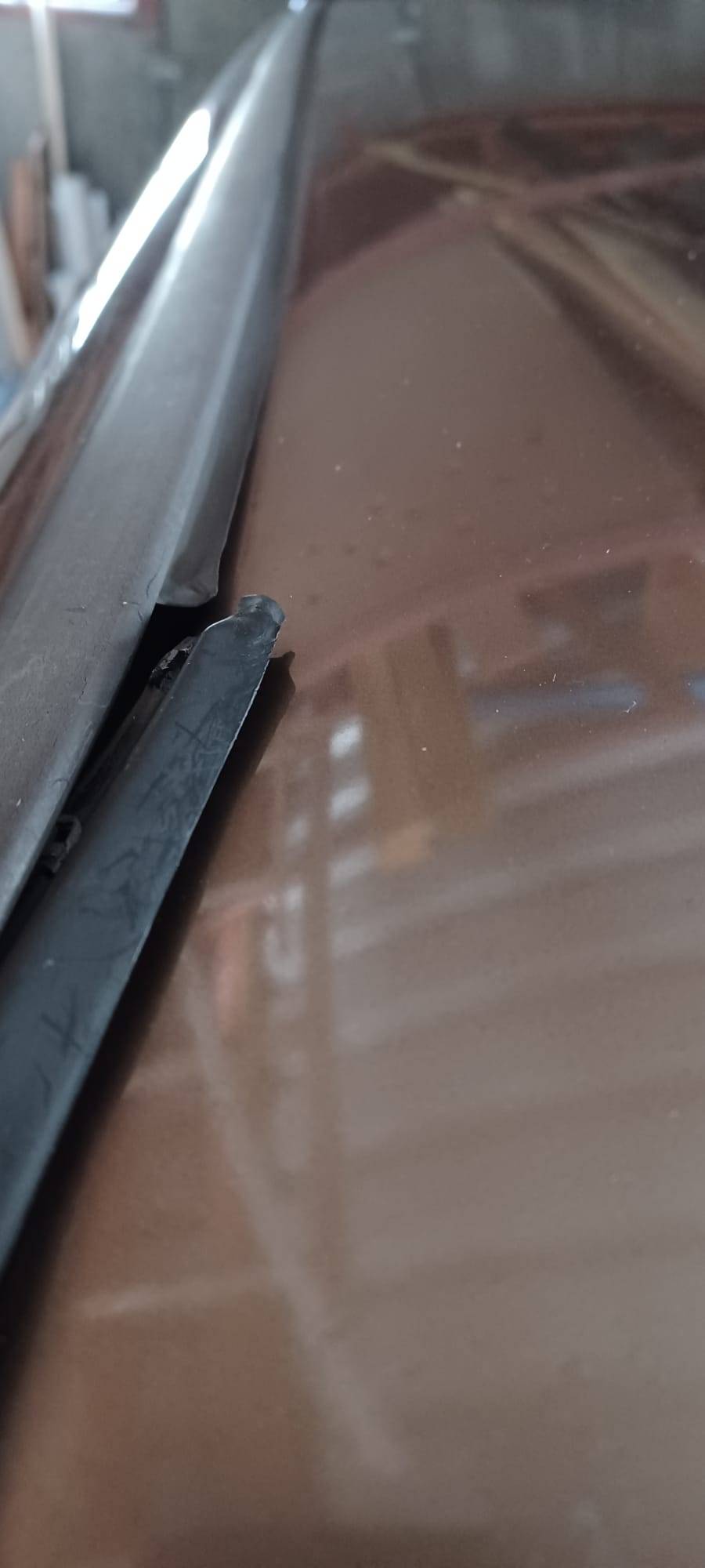

Managed to get some photos from my dad, who is currently storing the car.
I've not been over to see the car myself yet as it was purchased local to my dad (we're using it for an NC500 road rally event in May next year). I believe the slightly wacky black lines on the windscreen are shadows from the garage, and that is actually straight!
Any thoughts are welcome - having seen these closer images it looks like the rubber seal that mates with the roof trim - I would assume that all comes as one assembly if you buy it OEM.

Post by jreed »
That piece of rubber broke loose on my car a while back... I used a rubberized epoxy to bond it back in place... has been holding up fine so far.
The source of the water leak may be in the channel underneath the weatherstrip. You may be able to pry it up gently and find the source and plug it, then gently put the weatherstrip back in place into the channel.
