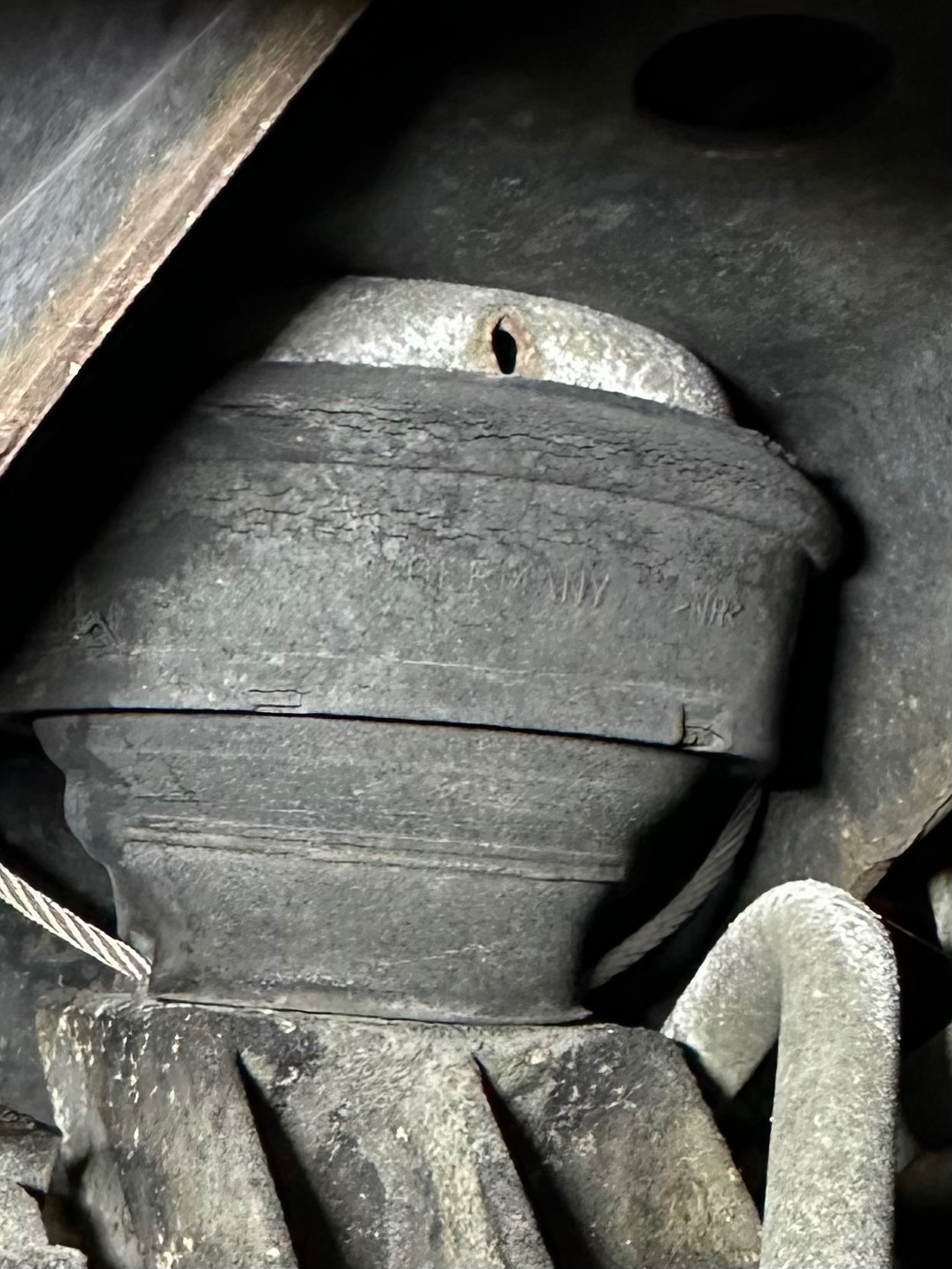

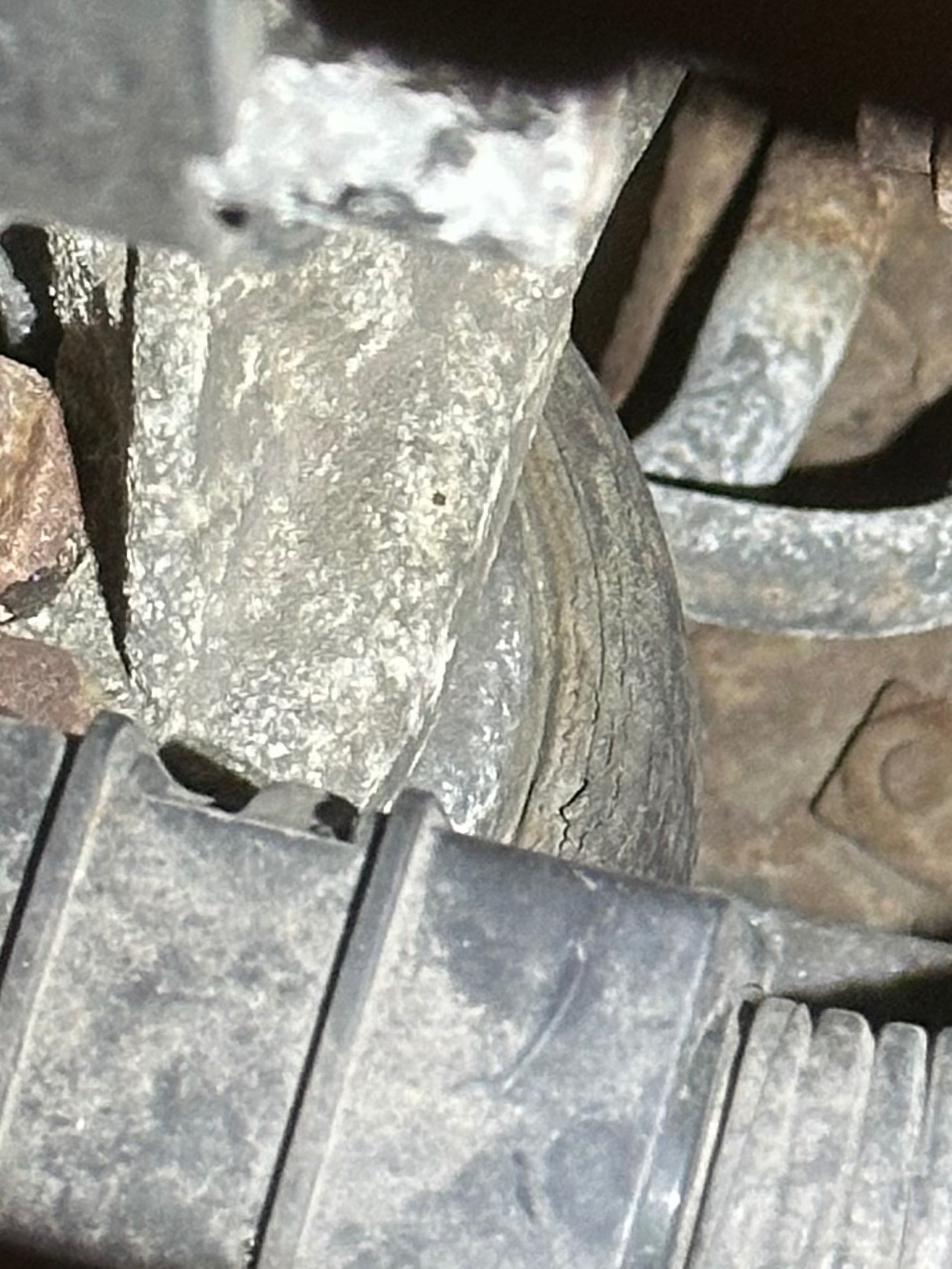

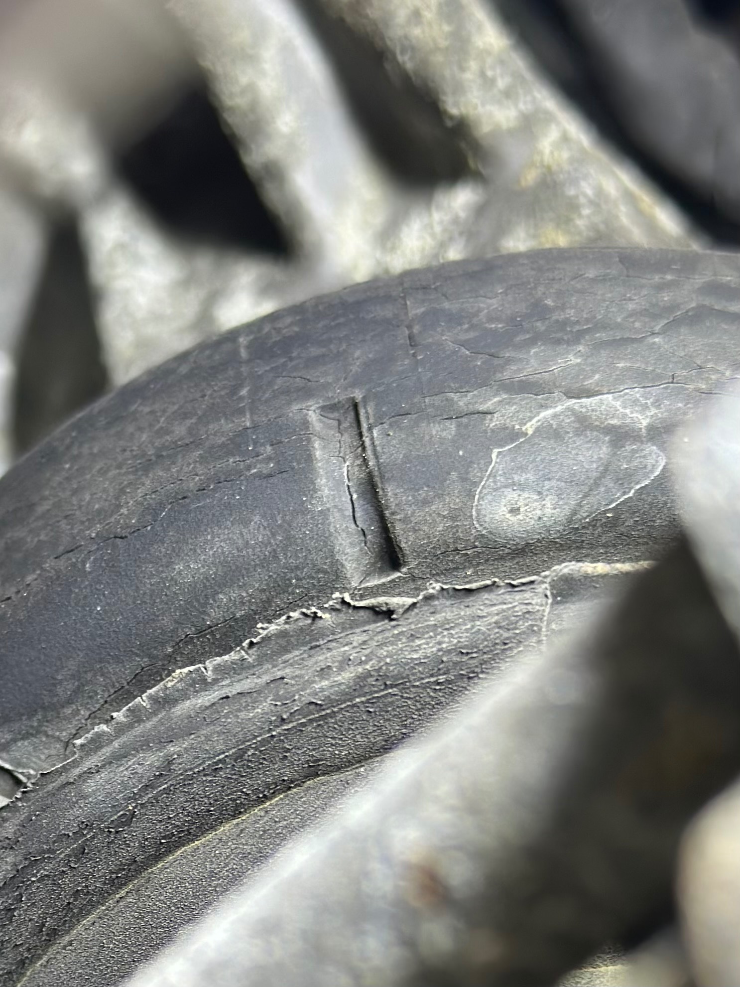

abscate wrote: 24 Dec 2025, 03:55 also checked the engine mounts and it looks good, so I won’t be ordering that for now.
…that engine mount looks awful to me, is that just the angle?
Today I will be chasing 7 fishes...
Yeh. Scrap that. The mounts are shot when I compared to new ones online. Transmission mount is sinking in as well.
Another job to add to do never ending to do list.

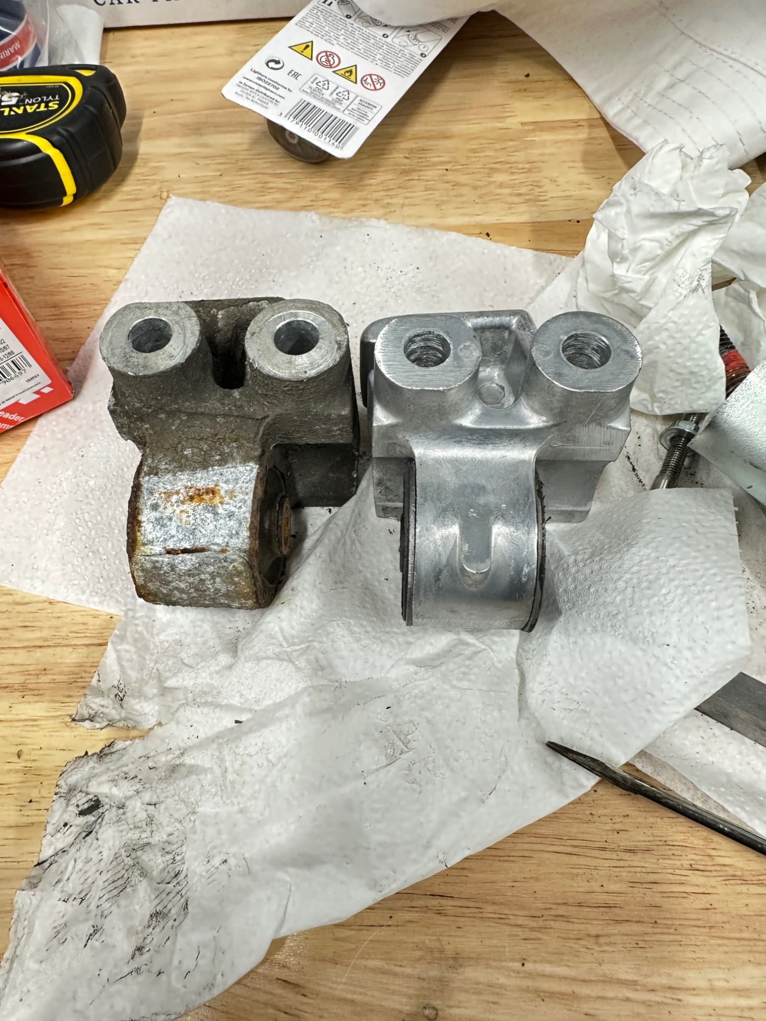

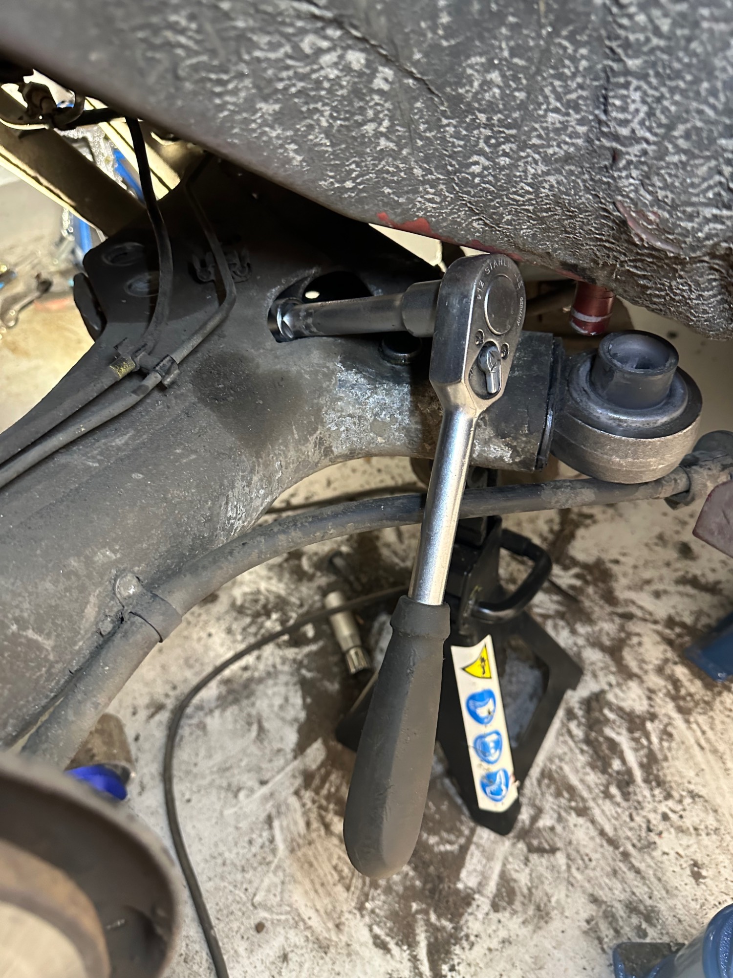

Post by Chieber »

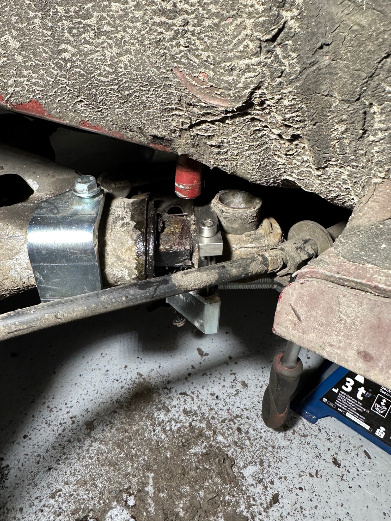

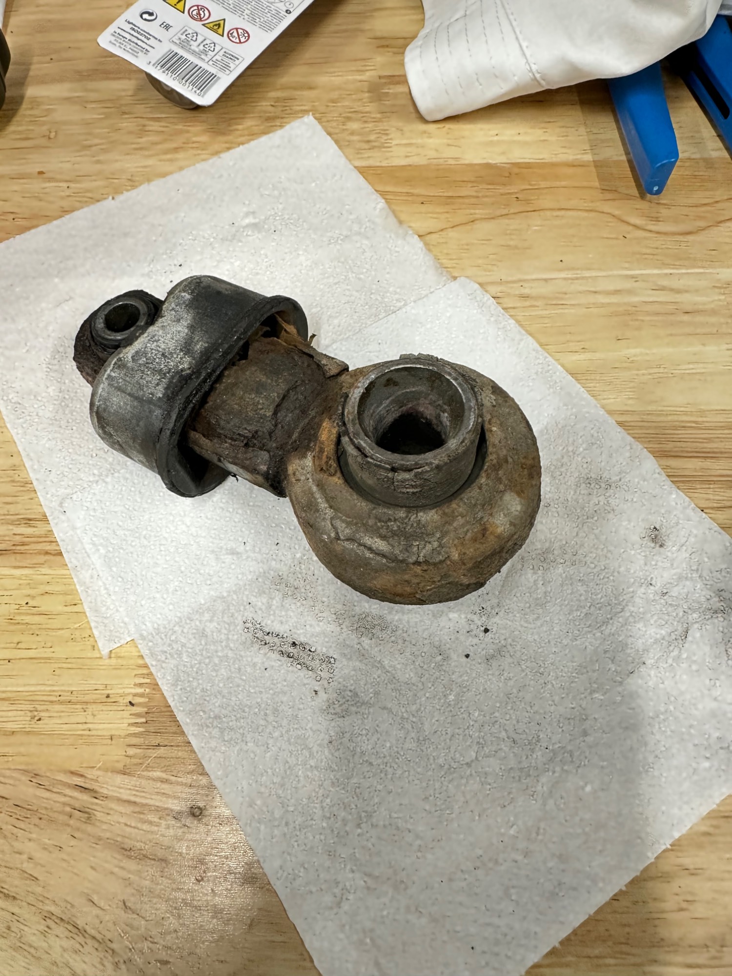

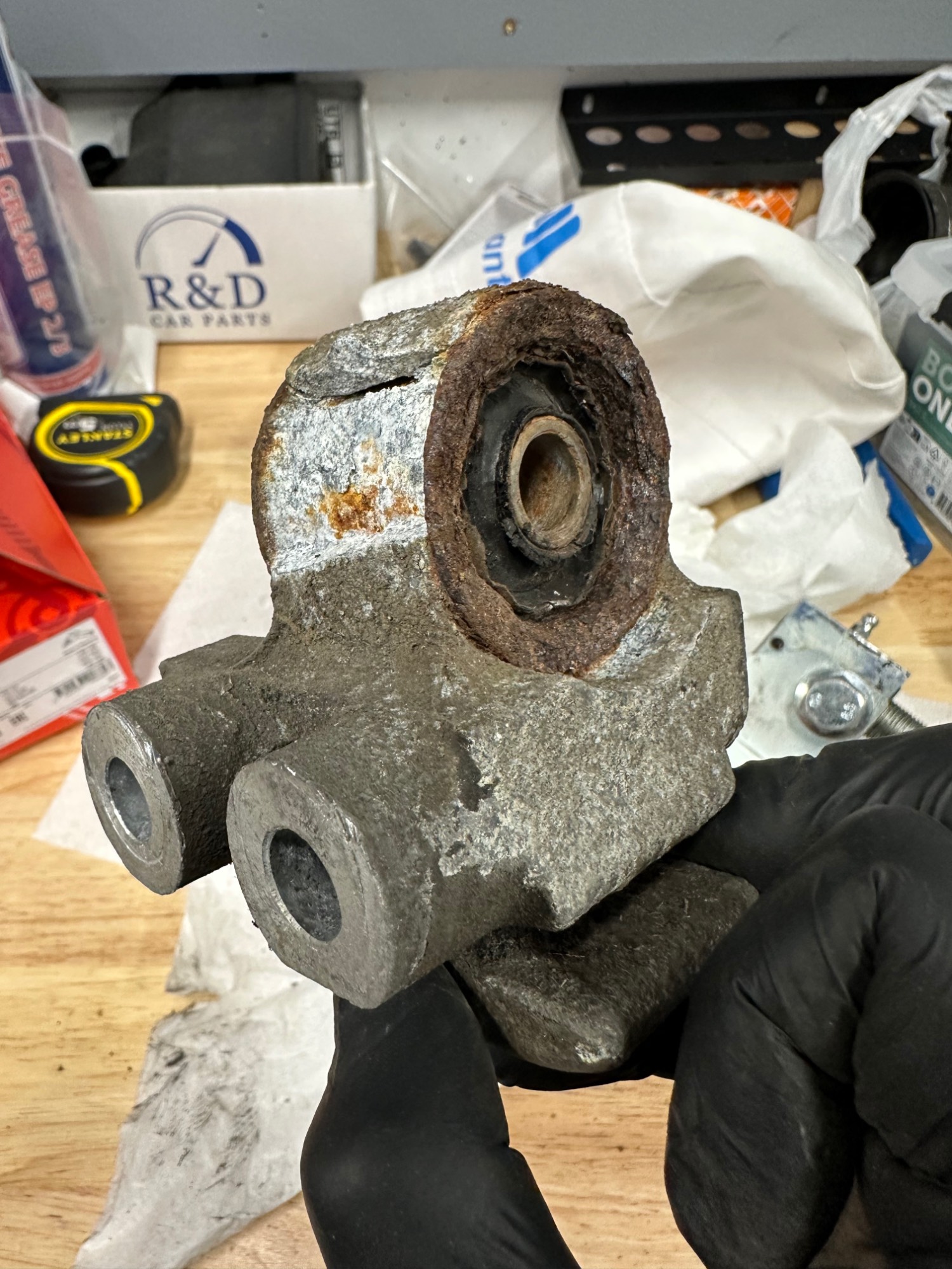

Even with the tool to press out the delta link bushing it is royal PITA!
1/2 a shitbox V70 1998 2.5 NA

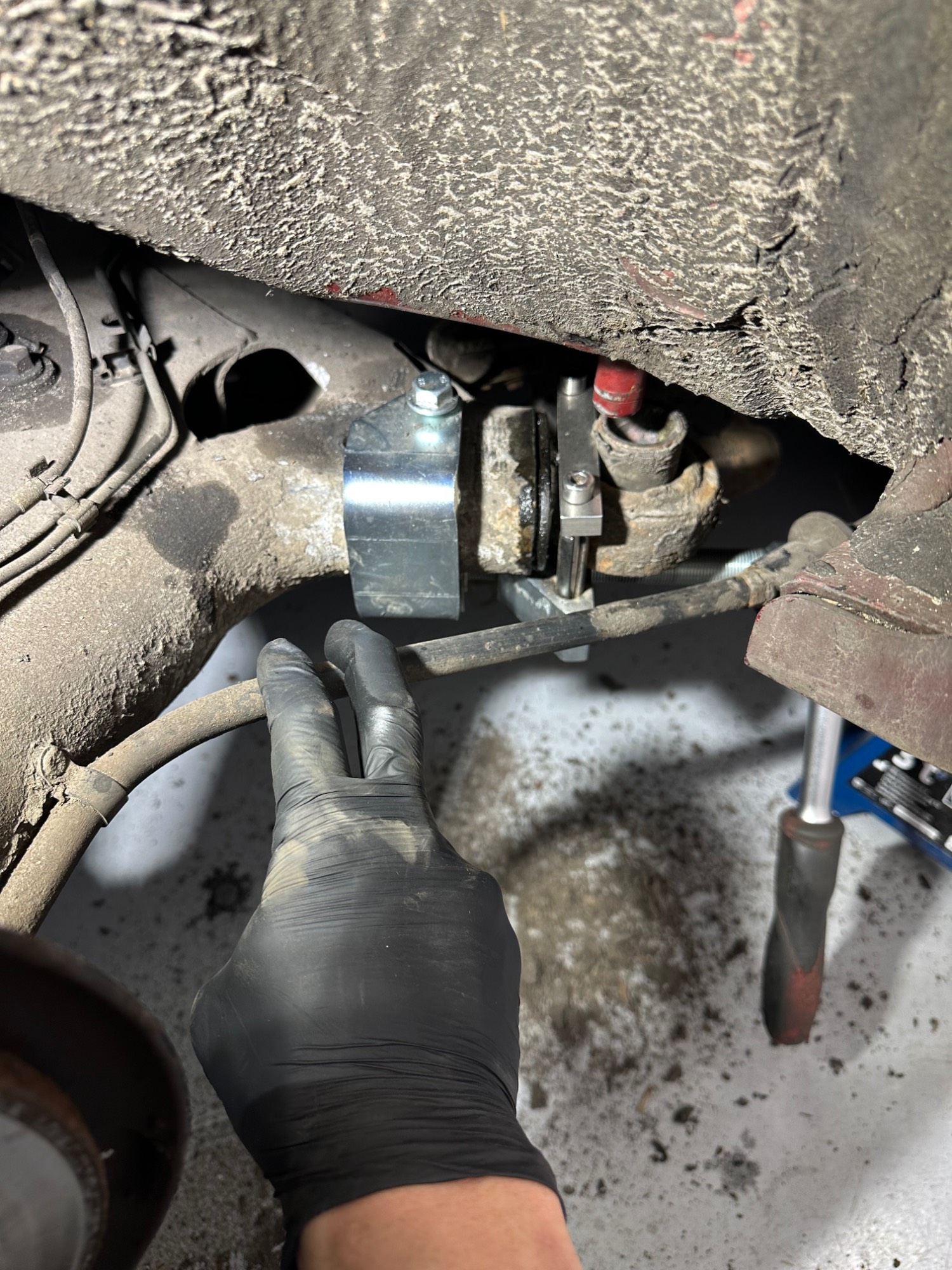

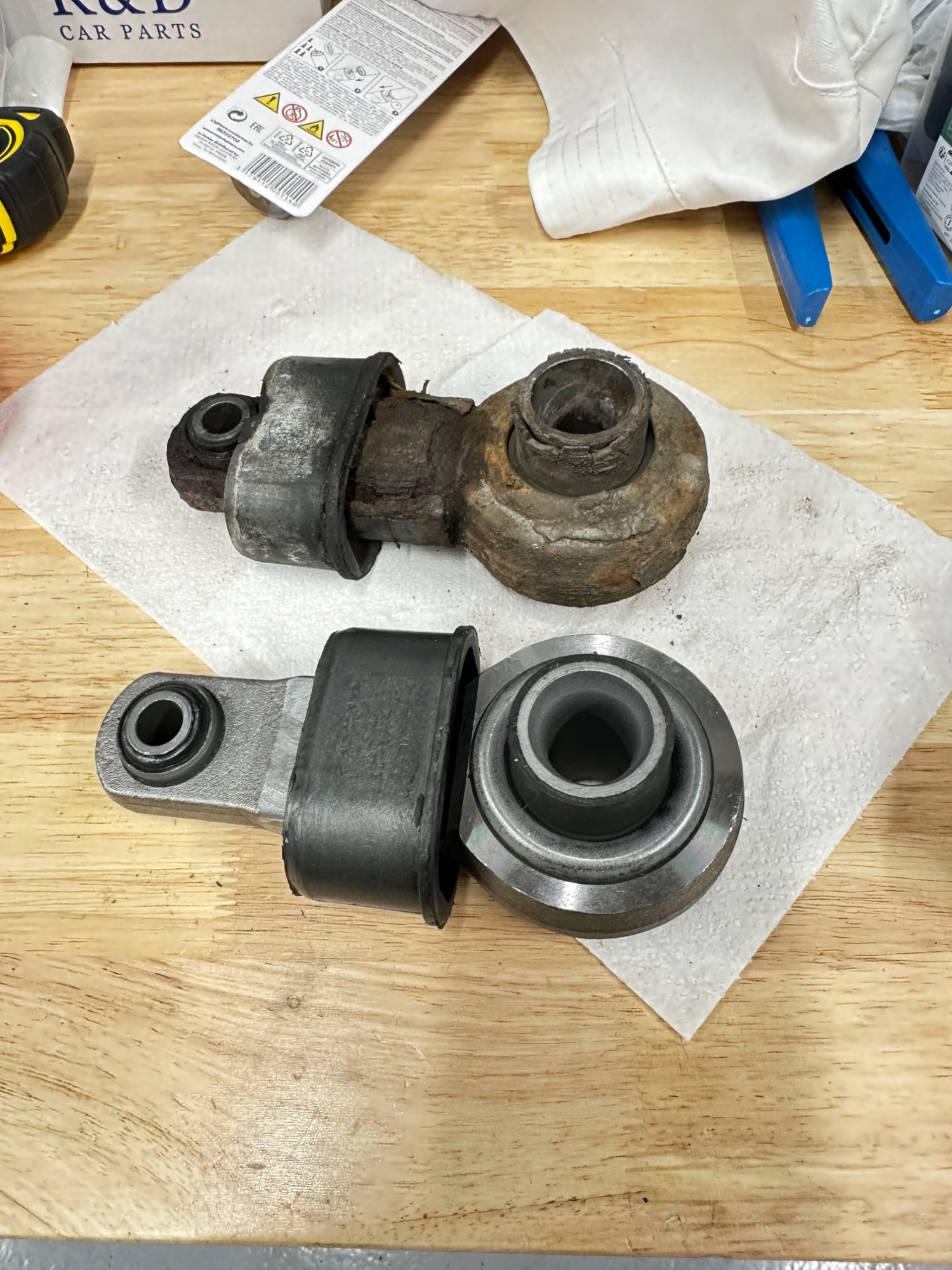

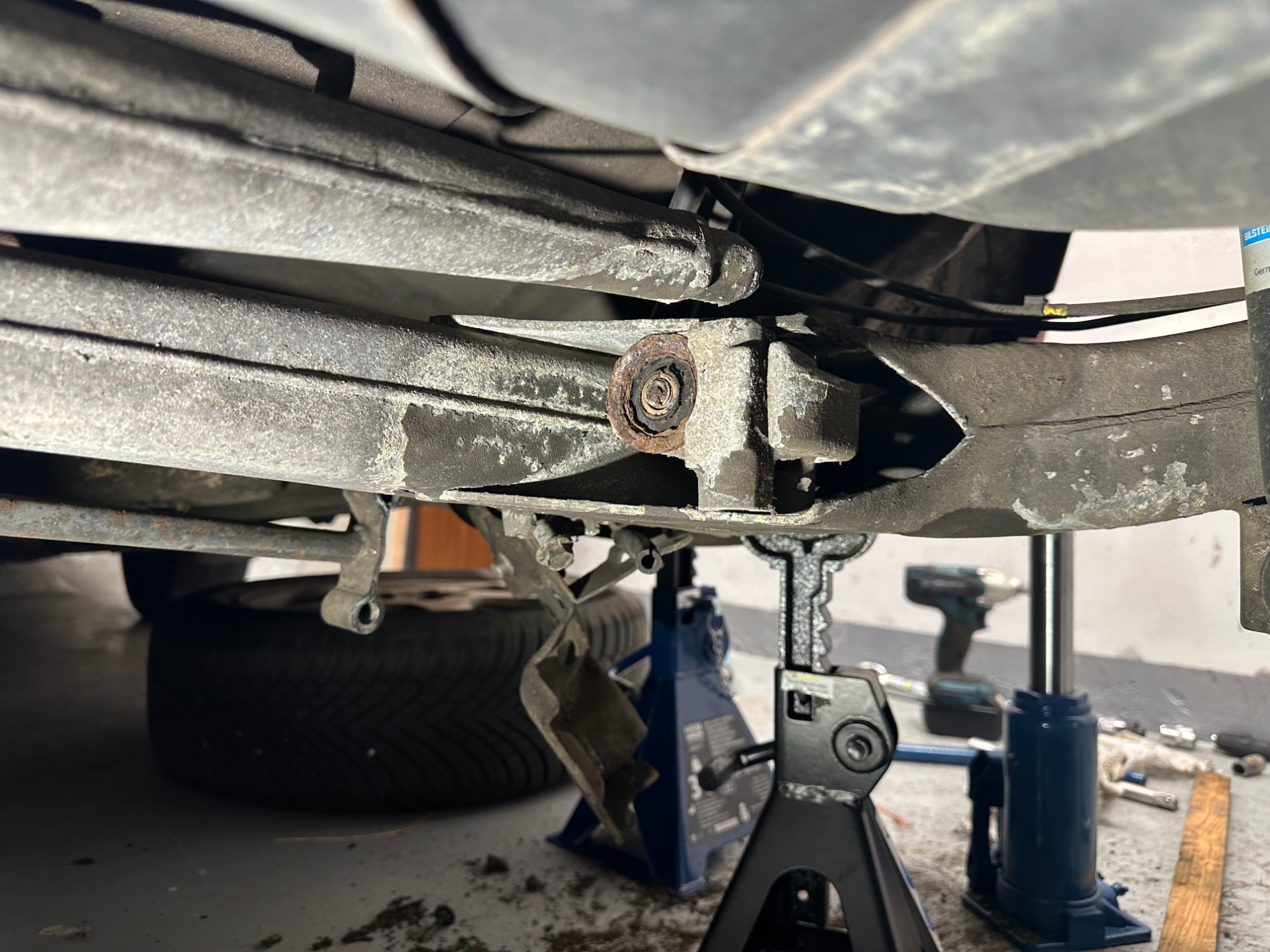

Post by Chieber »
Spoke to soon that the delta link is a pita.
This is even worse.
I’ve been doing the two jobs on the passenger side for 7 hrs now.

Chieber - those hydraulic motor mounts ( the two grenade shaped ones that are fire and aft in the subframe) don’t need replacing unless they are leaking fluid. Those don’t look bad. Your right ( car) or front ( engine) mount looked looked it was collapsing to me in your photo. Compare to new. Make a thread with photo measurements if you need help with that.
