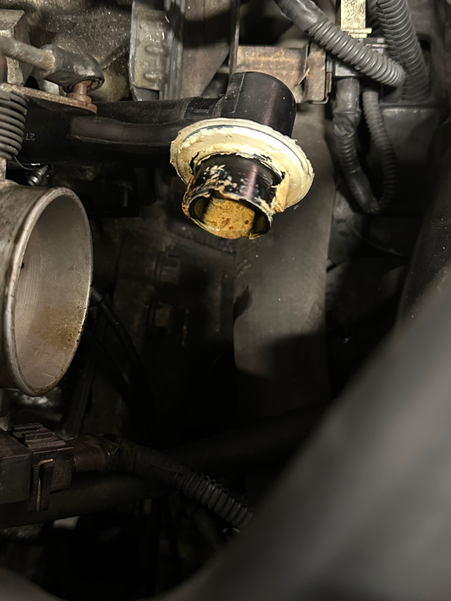

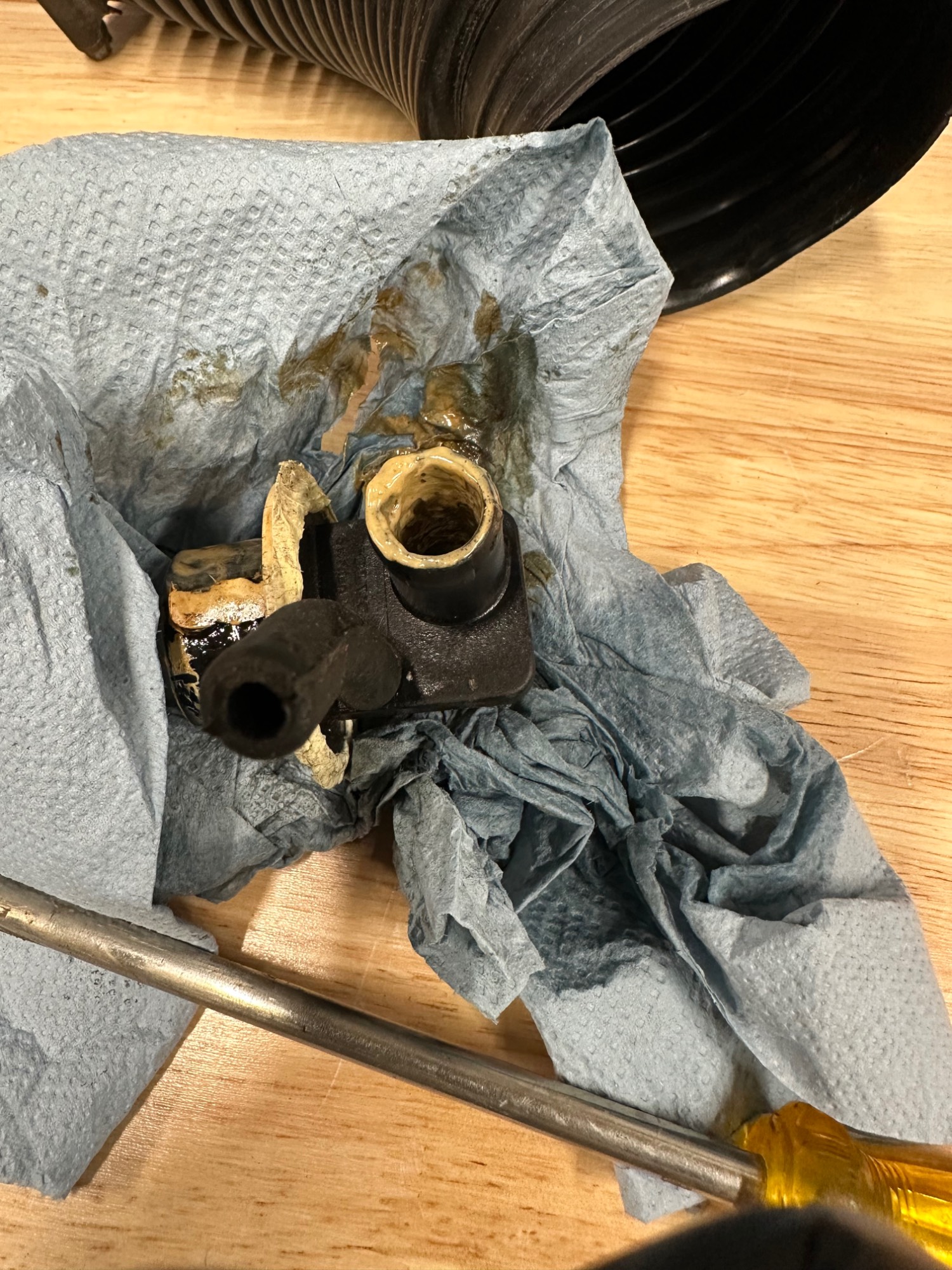

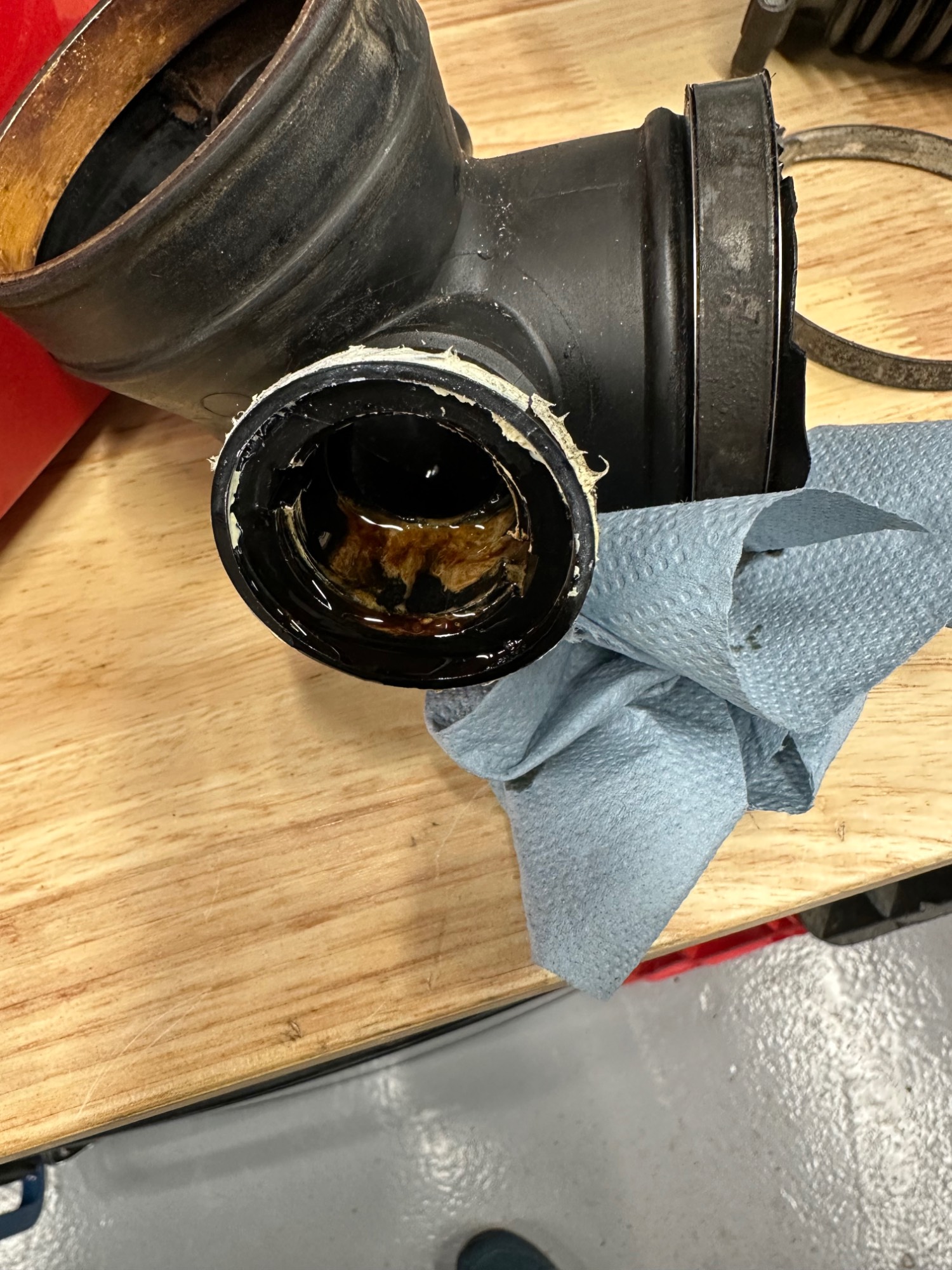

5k km later the pcv looks like this. Seems like I need to drive longer distances :lol:
The white around the edge is sealant.

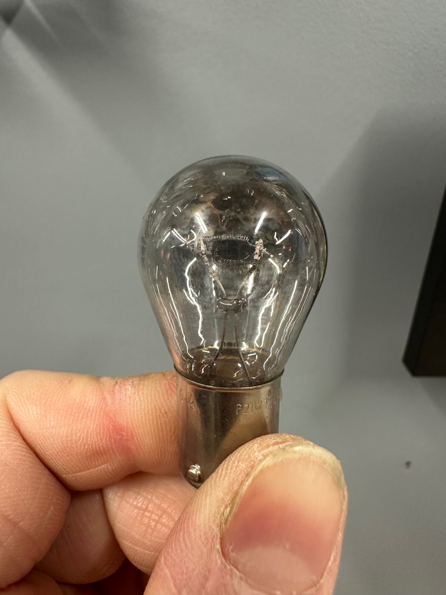

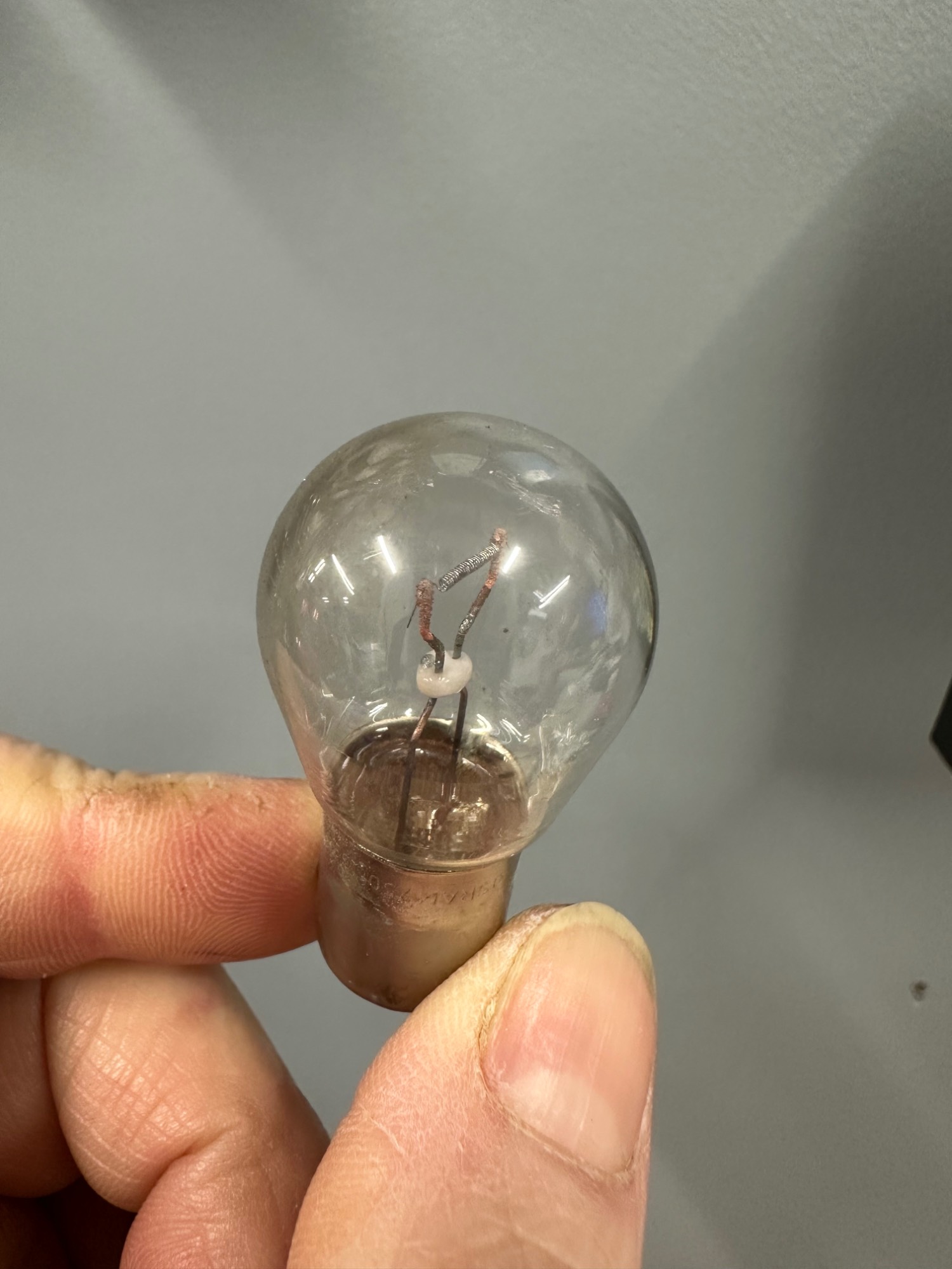

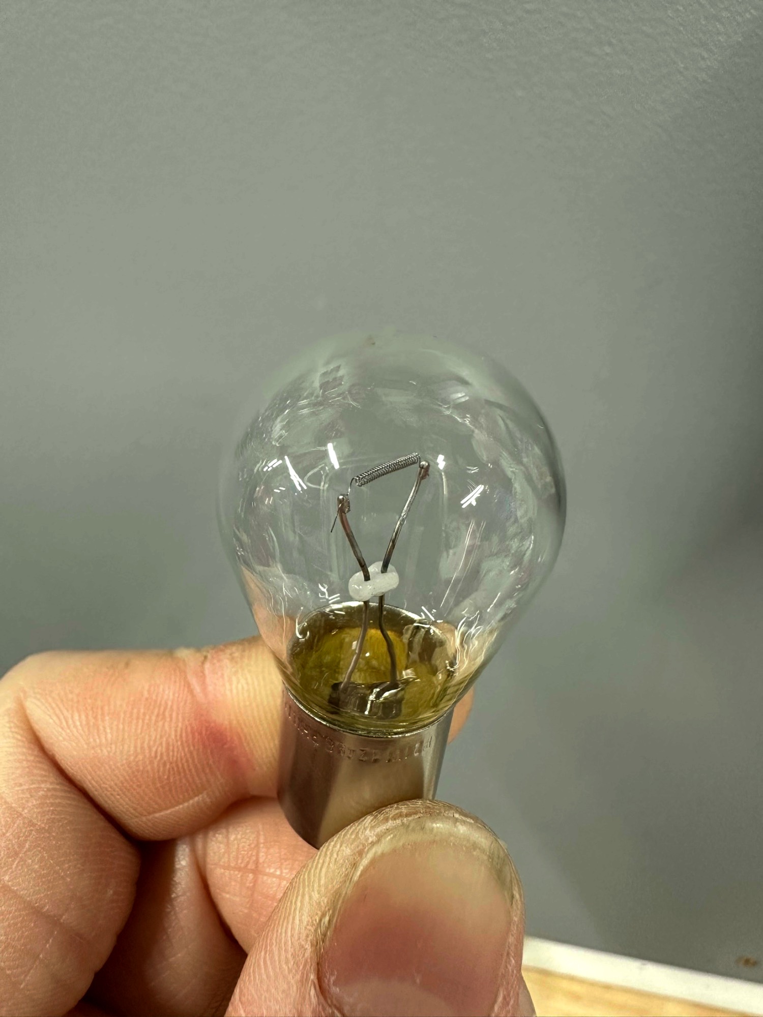

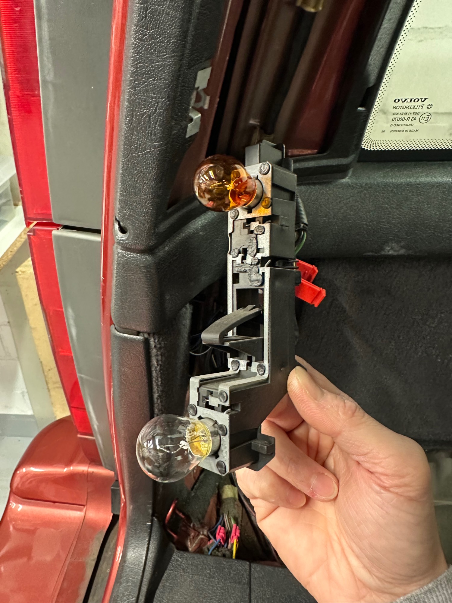

Bulbs time! Replaced all bulbs on the rear.
The og was osram. I replaced it with what was in store, which is Philips.
The difference in build was immediately seen when bulbs are placed next to each other.
Edit: just noticed that the new delta link is already rusting. Brand of the link was fag schaeffler
1/2 a shitbox V70 1998 2.5 NA

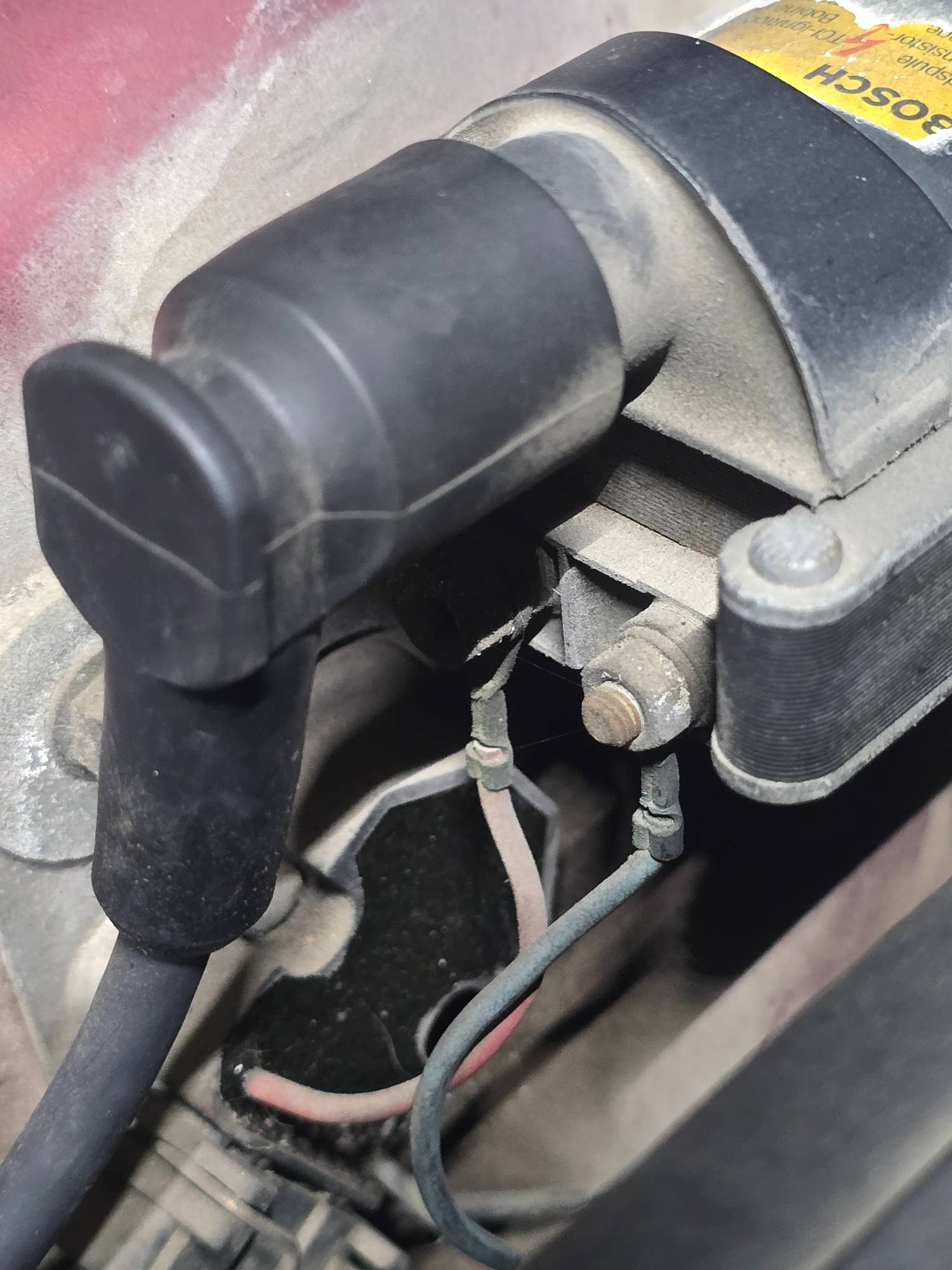

On a whim I cleaned the ignition module leads. No changes but I had high hopes.

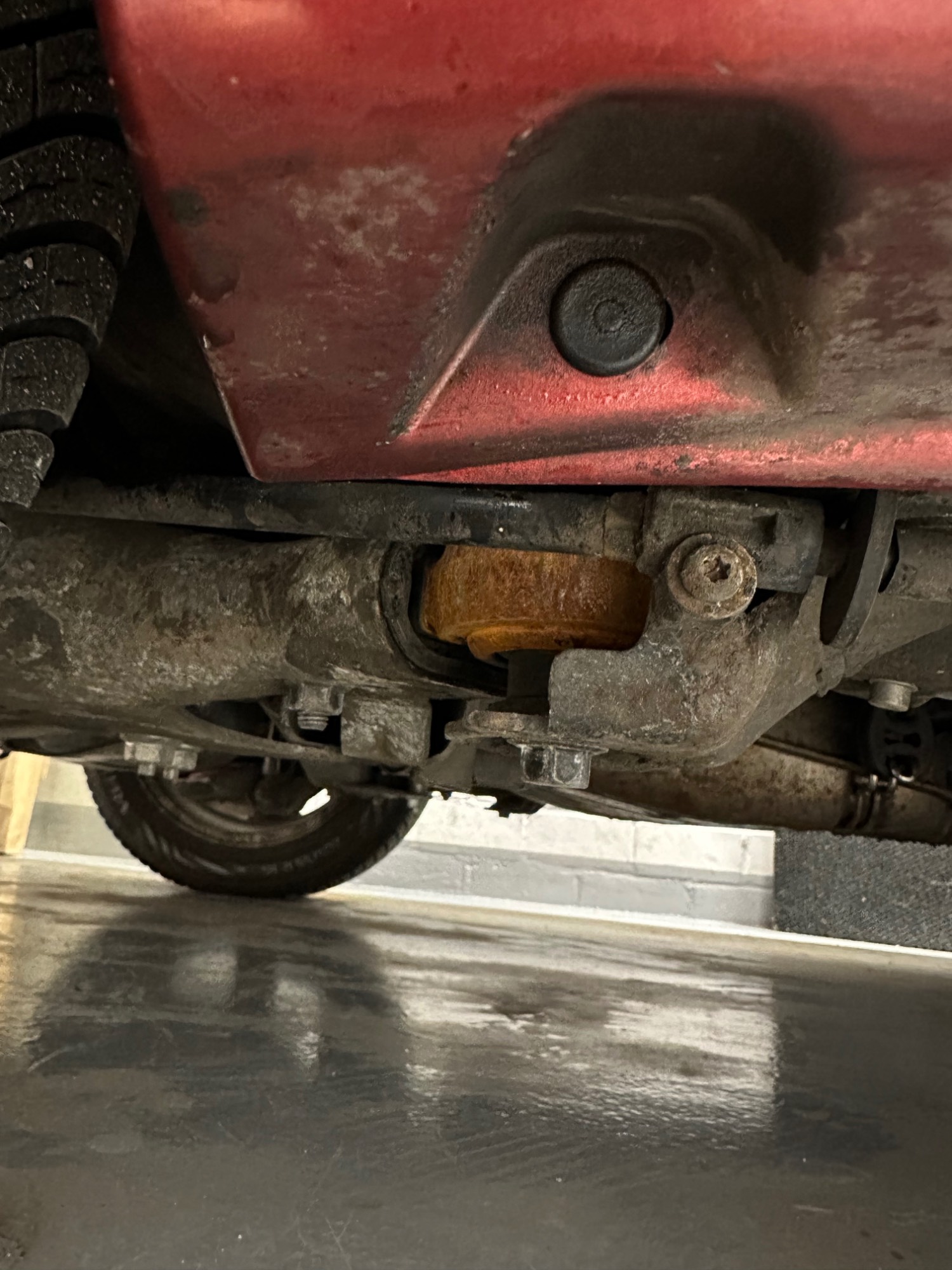

Got a text from one of my buddies who bought my 2000 V70 base. It had a picture attached of a rear axle support bush where the rubber had separated from below the car where it bolts to the floor. He was looking for advice on what part to buy as all we get north of the border seems to be a Delphi or a Suspensia? branded part. No idea if either are any good. Same parts supplied by Rock Auto but cheaper.
OE part is $300 CDN!!
He also asked if the job was difficult............errr, yes!
I then said, I have a spare bush made by Febi (same as IPD/FCP sell) for about $80 US. It was for another friend's car that never got fitted as the car had one done and it was a pig, and then it was written off before the 2nd one was done. My friend then donated the part and the Volvo tool to the PIF fund. Naturally my buddy just laughed and said he'd be over in 15 minutes.
