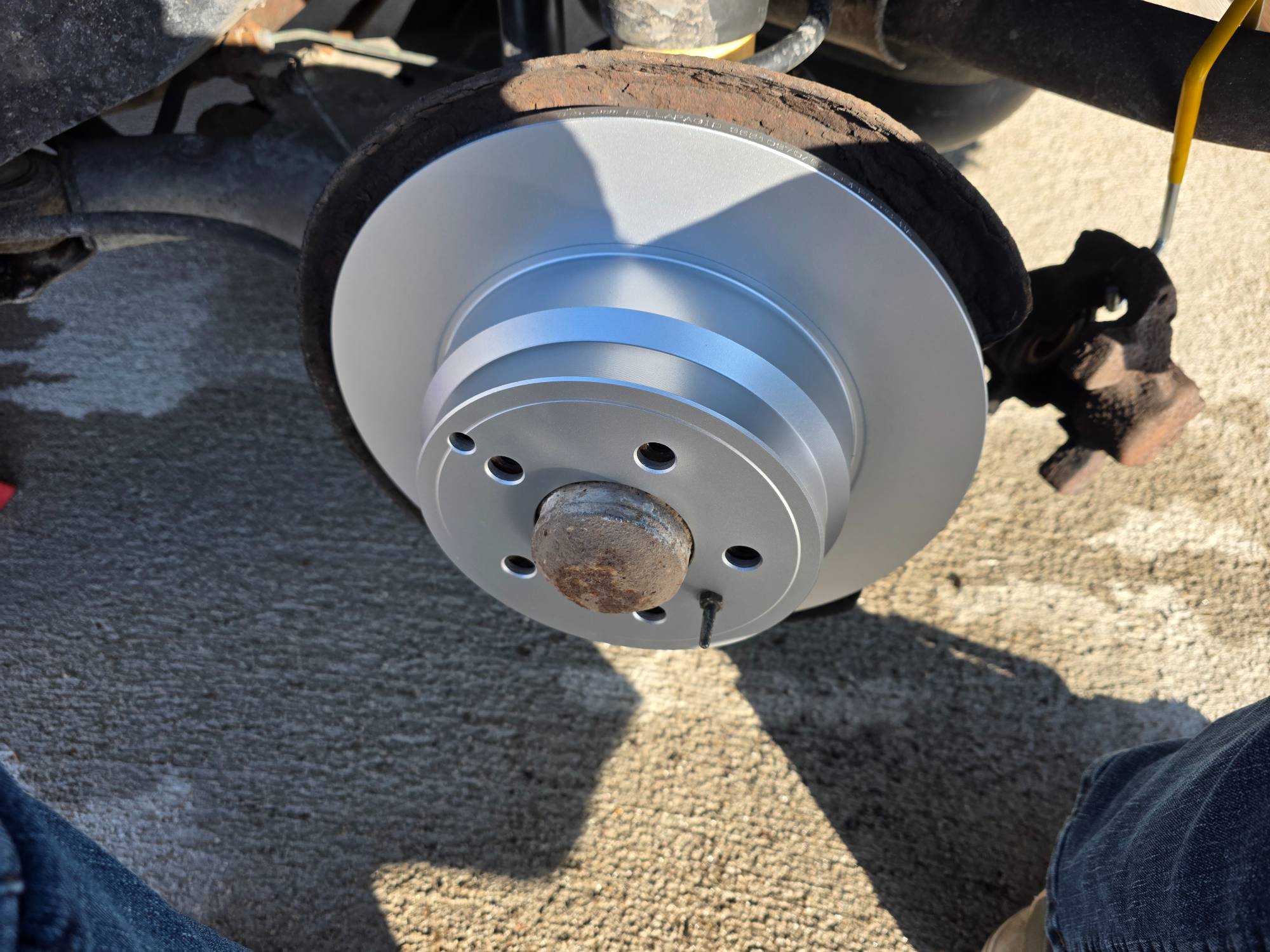

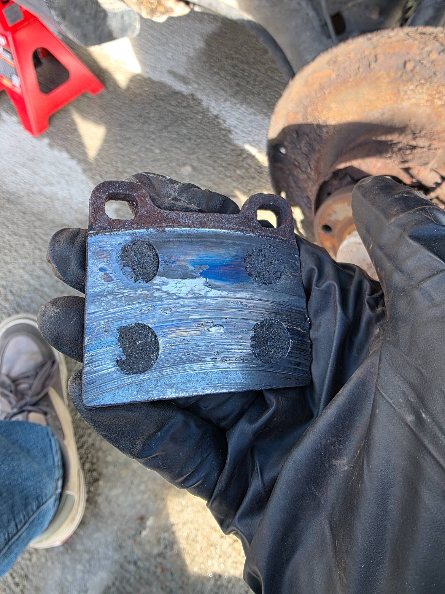

Also to add more context to my late night post, I dug into that rear left caliper on Thurday to inspect it and attempt to replace pads since that caliper, unbeknownst to me, has been lightly sticking for a while and actually depleted one of the pads down to metal (that's on me for not checking my pads). What I did on Thursday was replace the rotor since being metal on metal ruined the old rotor and put in one new brake pad. I put one of the old pads that still had some meat on it into the outer side of the caliper since I could not get the piston to retract far enough to fit the other new pad (hint hint). This was just for interim so I could still drive around the car a bit until the new calipers arrived.
In hindsight, trying to go on a long drive with a caliper I knew was failing was not a great idea
Thankfully it began to seize only a few minutes into the drive so I didn't significantly damage the new rotor before getting back home.
The parking brake hardware is also disintegrated, which came as no surprise really

Are you done with thst pad? Asking for a friend ….
