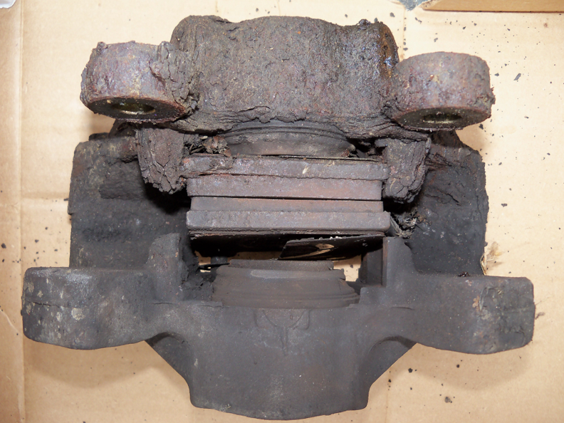

Post by PeteB »
Picture of the very rusty caliper, note how the rust is so much worse on the side that probably dragged more:

Post by jreed »
Wow. Great shot. That's the rustiest caliper I've seen in a while.
It does look like the stainless steel half-shims are present between the caliper and pads... that's a good thing.
