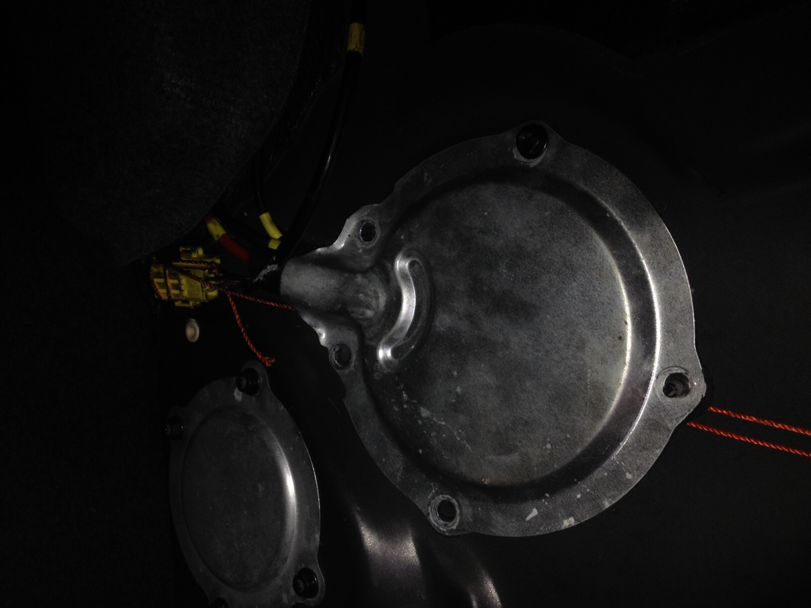

Found the connector for the rear sensor, it is behind the passenger truck side carpet thing and is yellow. Not easy to get to, I had to remove a lot of clips Checked the resistance at the connector and it is showing open, so at least the wiring to the trunk is okay.
I'm going to cut the wire, pull it out and see if I can find the problem. I tried to remove the sensor and yes they are stuck in there so hopefully it is just a wire problem. If it is the sensor, I will have to smash it out I guess, its stuck on like glue. Crossing fingers.................!

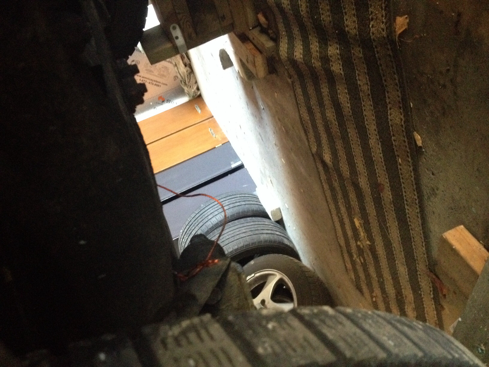

Update: the problem is the sensor itself even though it looks fine. I cut the wire and did a resistance test. The wire is very high quality. Something different from what you've experienced matty.
Phils: I know why you dropped your gas tank. The yellow connector gets stuck. I am only replacing one sensor, ( I will try the Chinese special) so I have cut the wire and fished a string. I will then attach the new sensor to the string, and pull it through. No need to drop the tank. For me I'd rather keep an oem sensor if it is working.
