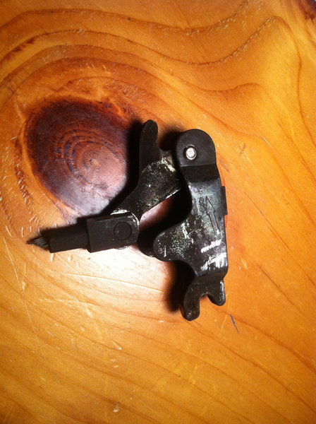

So the new pars I ordered were for a V70 not a V70XC.... Have to be more careful when I go through ebay again. I figured out the reason was the cables because once the cables were out I could fit the new pads in. The other question I had was it looks like the cable was clamped onto the mechanism to apply the parking brake. Is this possible? At the junkyard I saw how most cable slide into the mechanism, but mine doesnt have it. I will try to post a picture but is this just on the V70XC and how would I connect the new cable?

The new cable should have a piece on the end that looks like the lower left piece on the picture. You can see where the old cable was cut or wore out. You need to drive out the pin that holds the cable end to the actuator, then connect the new cable end. The pin should slide out and back in fairly easily. When it's in position, it is held together by being inside the larger part of the actuator. After connecting the new cable, check to make sure the actuator parts move together easily. The part of the actuator that connects to the cable should move through the other part until about 1/2 inch of it is sticking out thru the other part.

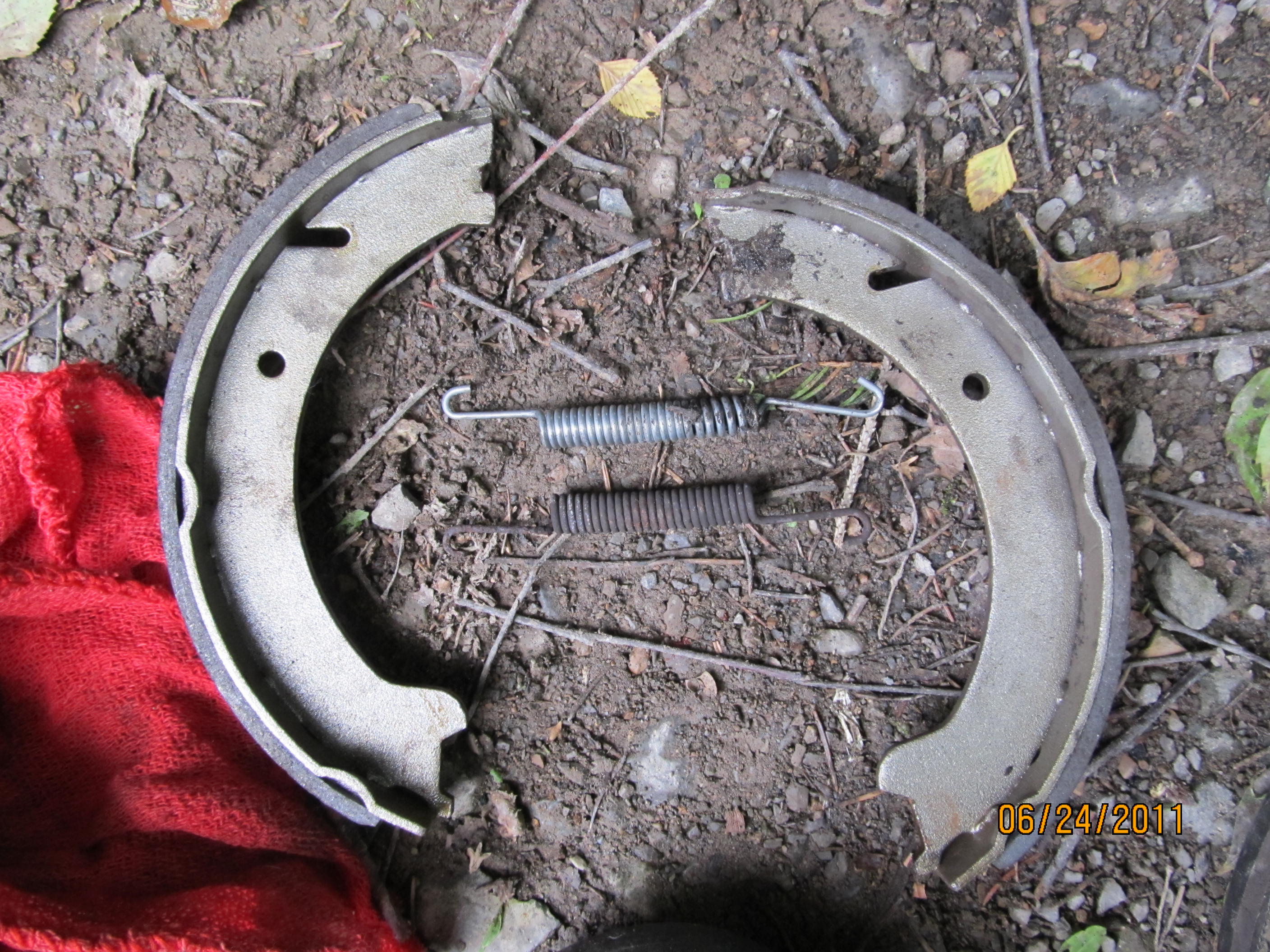

cn90 wrote:Thank you Lee for the detailed DIY. I have done many Parking Brakes in different cars before, but I have a question re hardware kit.
I want to replace the Parking Brake Shoes, and during that process want to change the hardware kit too.
From my research on different online vendors (FCP, eeuroparts etc.), they sell "Scan-Tech":
http://fcpeuro.com/products/volvo-parki ... 70-s70-v70
Normally I hate Scan-Tech but has anyone uses this hardware kit by Scan-Tech before?
I just replaced my ebrake shoes, and tried a set of Scan-Tech springs. In my opinion, the Scan-Tech springs are weaker than the originals. I stretched one beyond its elastic limit in just putting it on, and the spring ended up about 1/4 inch longer than it should have been. After that the spring wasn't strong enough to pull the shoes back into the proper position after pulling and releasing the ebrake. I went back to the original springs. Here's a picture showing the"stretch".
