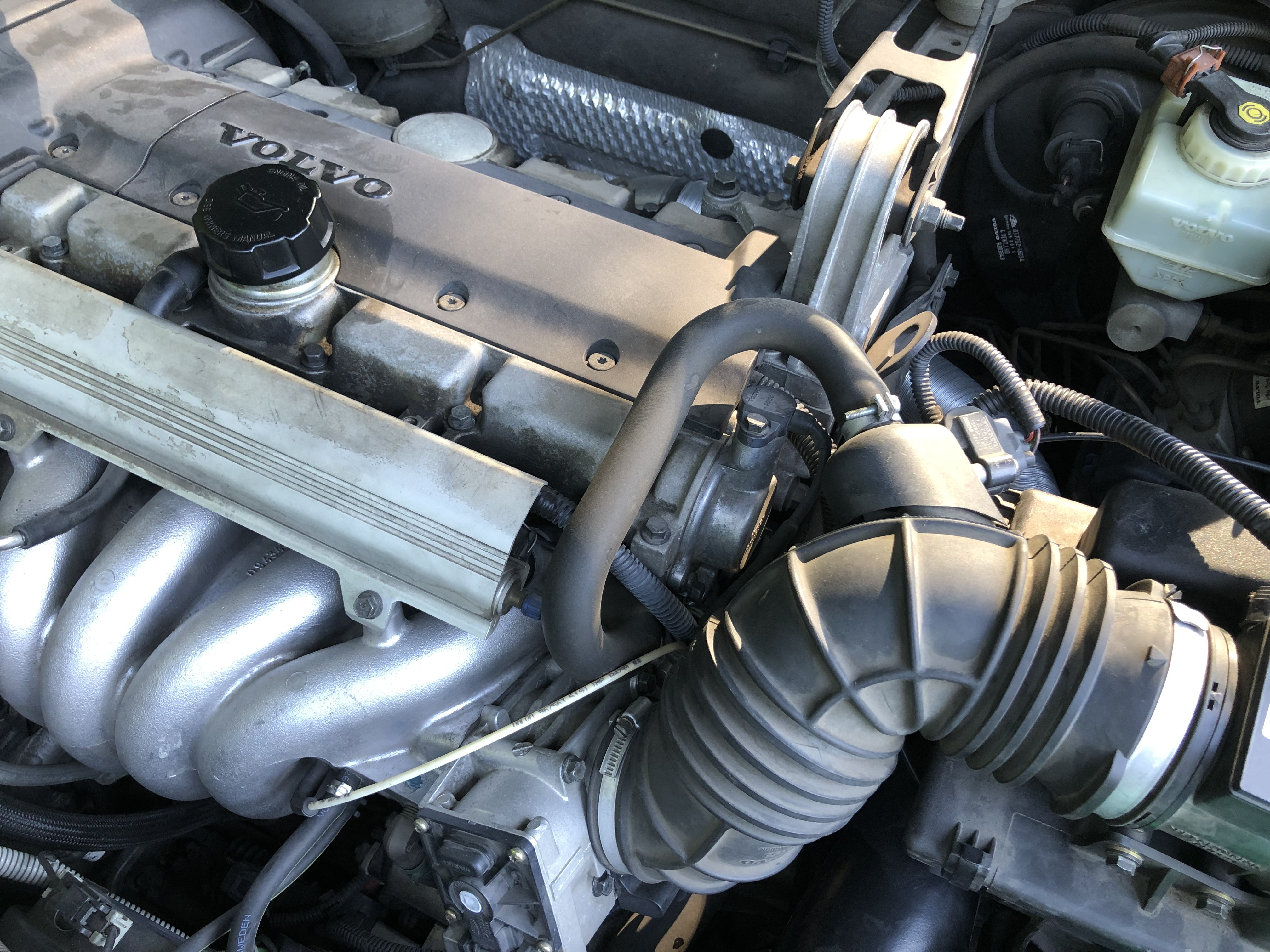

I've always assumed mine has VVT. My intake cam has a couple wires coming off the driver's side of the engine. My car was built in late 98 and I took delivery in March 99. See below:

Need to see the other end of the cams with the cover removed, to see if it has solenoids on the 'front' end of the engine (passenger side of car in the States)
Im going to guess you don't have that on the B5244S engine (?)
