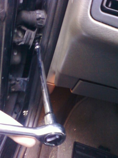

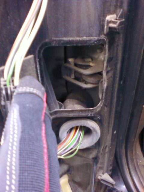

It is a VERY simple thing..
Take off your door panel, on the 850s its only a few screws,
some along the bottom, the ones in the speaker area, and the ones behind the chosen above the handle.
Anyways, just get I believe it is a T30.
heres some photos of what your looking for.

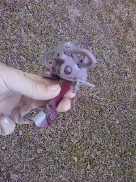

This is what my old one looked like it... fell apart soon as I unbolted it.
