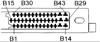

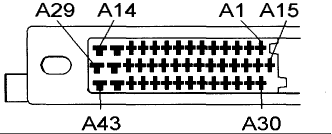

Here you are people I did some digging and found these diagrams for the ECU pin #'s. I'll let you know how this works out.
- Jesse
- Jesse
- Side A of of ECU pinout
- 2010-07-30_005730_Connector_A.gif (4.05 KiB) Viewed 5481 times
- Side B of ECU pinout
- 2010-07-30_005837_connector_B.gif (4.25 KiB) Viewed 5481 times
