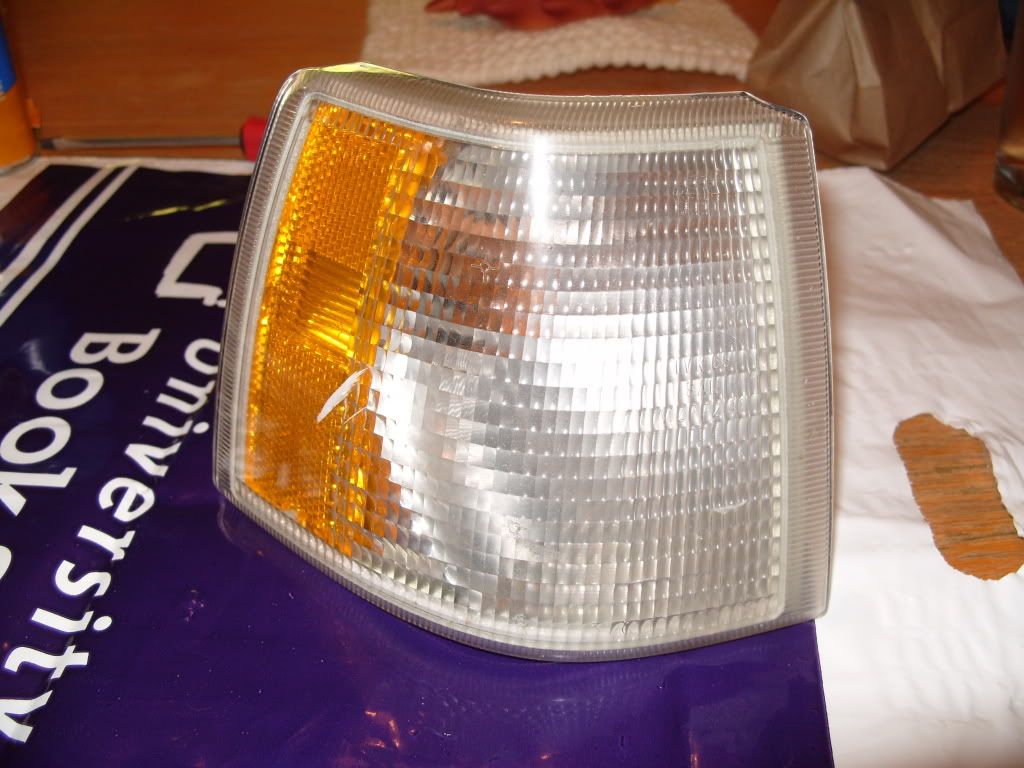

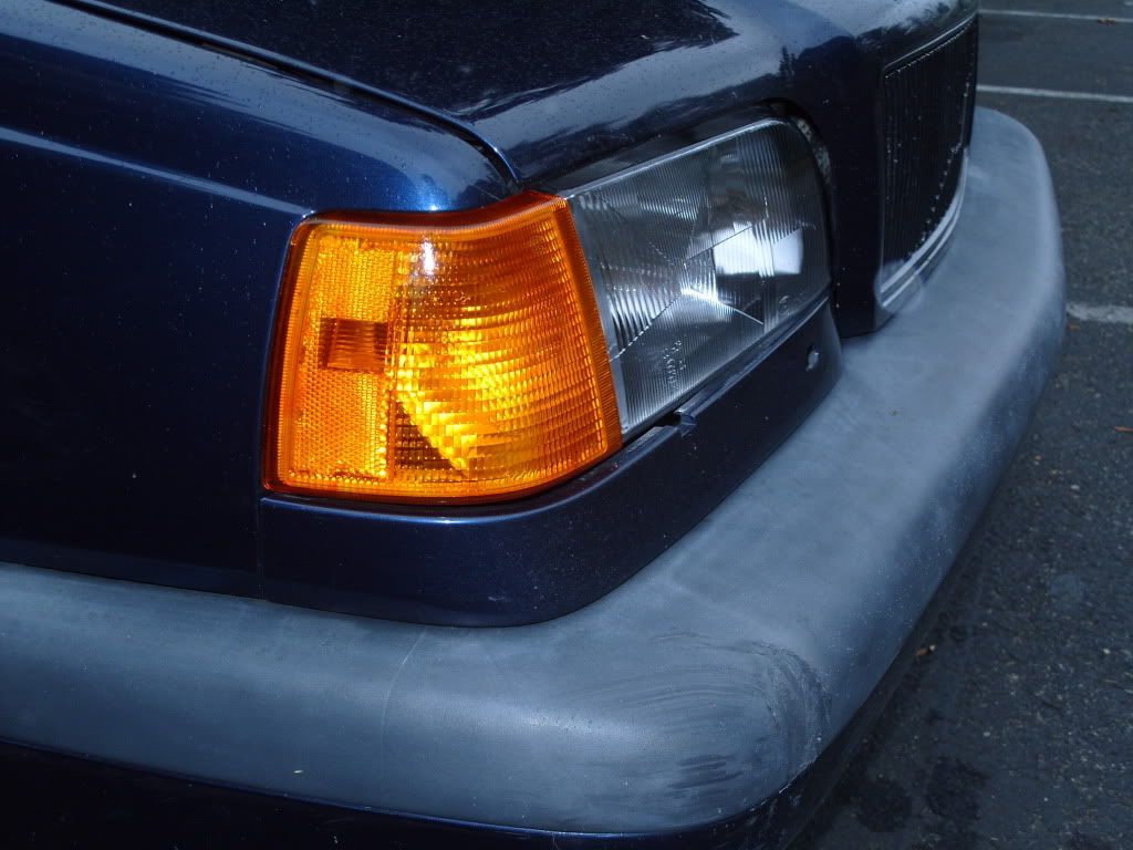

Wanted to try a different look for the front of my 850 and this is what I came up with.

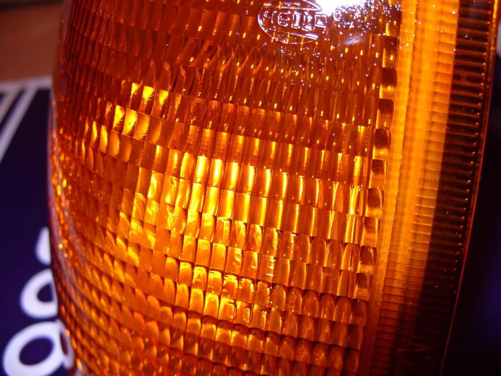

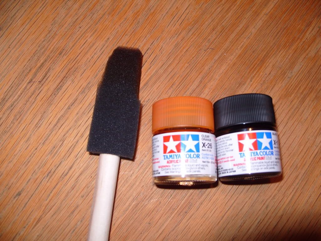

In case anyone else is interested in doing this, I started out by cleaning the turn signal lens really well with lacquer thinner.
I used a clear orange modeling paint on the turn signals with a foam brush for application. The paint was made by Tamiya and is x-26.

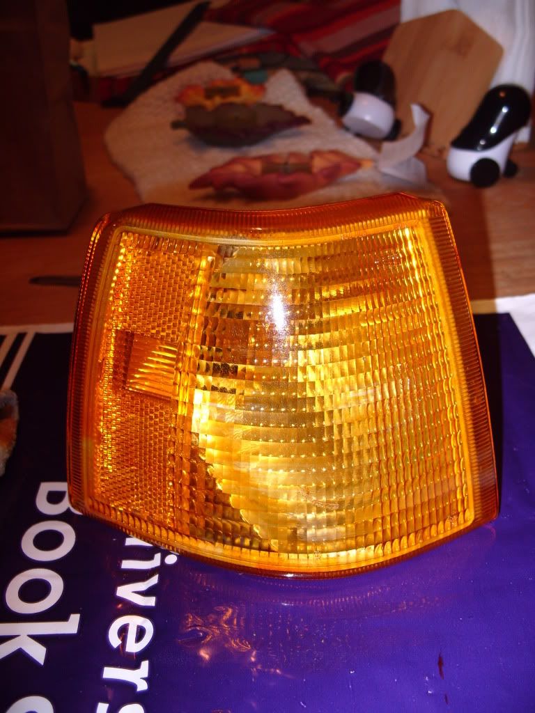

You need to work quickly with this paint as it dries very quickly. It is very thin and creates a fantastic finish. Here it is after the first coat.

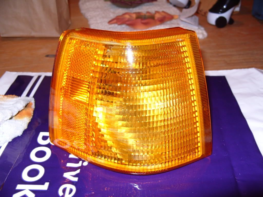

I did another coat about an hour later in the opposite direction. This really brought out the color.

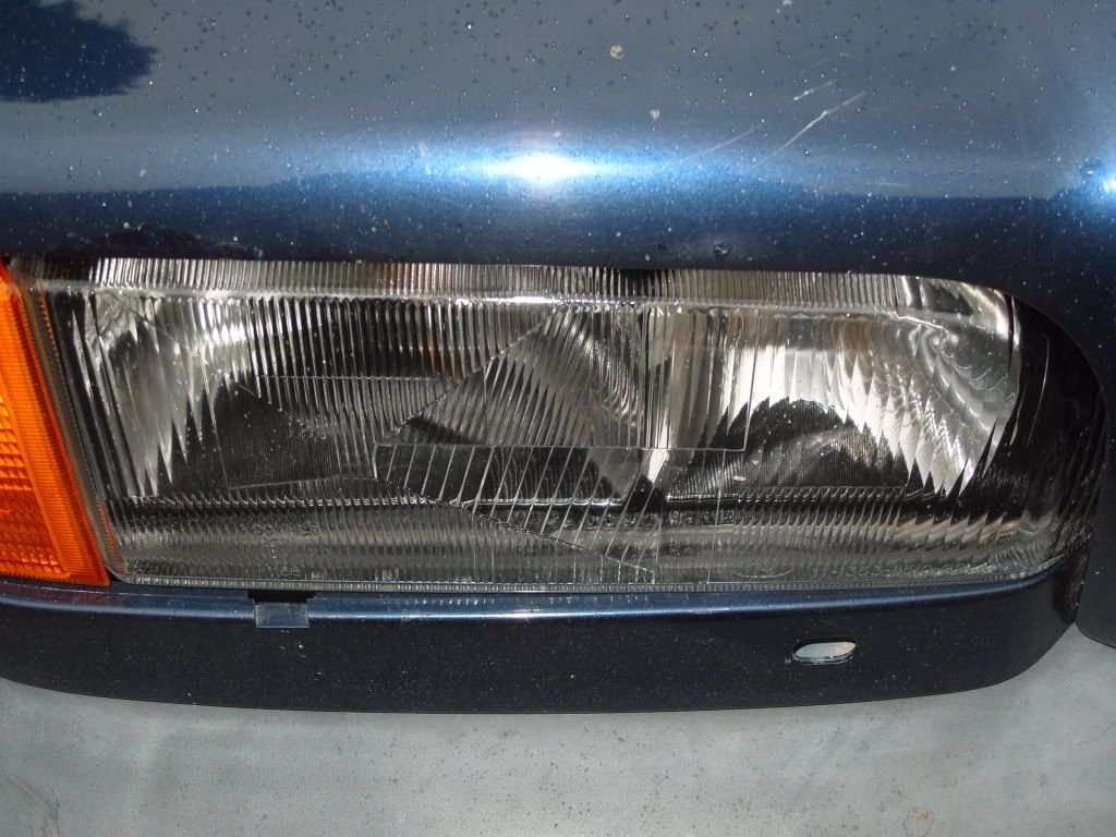

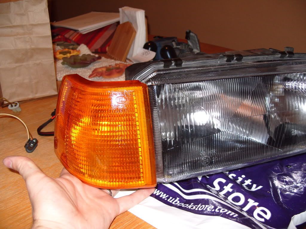

Next to the amber signals, I thought the chrome look of the headlights needed something to set it off. I removed the lens and painted the surround with Tamiya's gloss black.
Wanted to see what the lens would look like next to it.

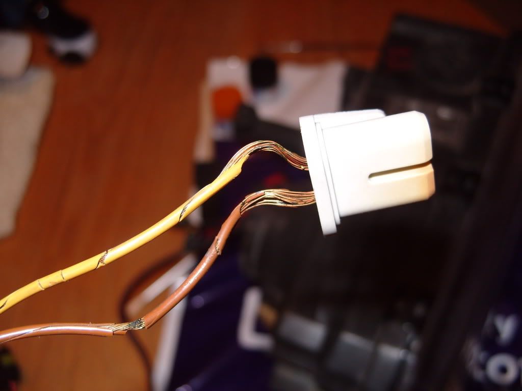

While I had the headlight apart, I noticed that the internal wires were in poor condition.
It's a wonder that I hadn't blown the fuse.

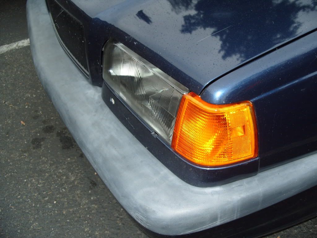

A few more pictures of the final product.

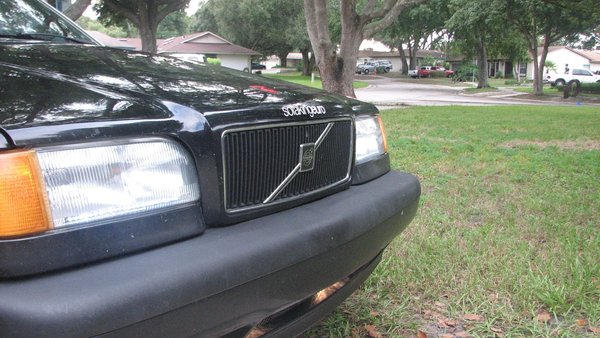

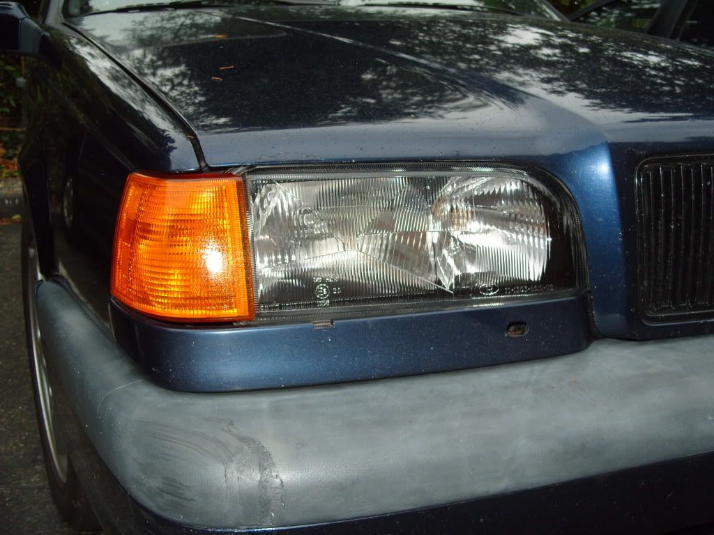

RobTheModd
Posts: 1104
Joined: 20 August 2009
Year and Model: 98 S70T5M
Location: Florida
Has thanked: 5 times
Been thanked: 7 times
Post by RobTheModd »
Well I guess.. Welcome to the family. lol.
heres a few more photos of other cars, to give someone a little more push to do it.
looks way better then stock, but after awhile, they WILL fade.
be prepared. lol. id put a little thicker orange coat on before you do the clear though to ensure long lasting amber.
lots have done this before, although its not everyones style, it does look great. :D
