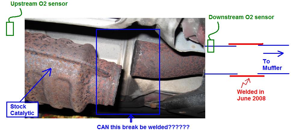

NEED an Update on Catalytic for 1998 V70 with 110K miles with stock Catalytic, exhaust and O2 sensors.
In June 2008, The union between catalytic and exhaust broke, so it was welded by a local shop. It still holds up 3 years later.

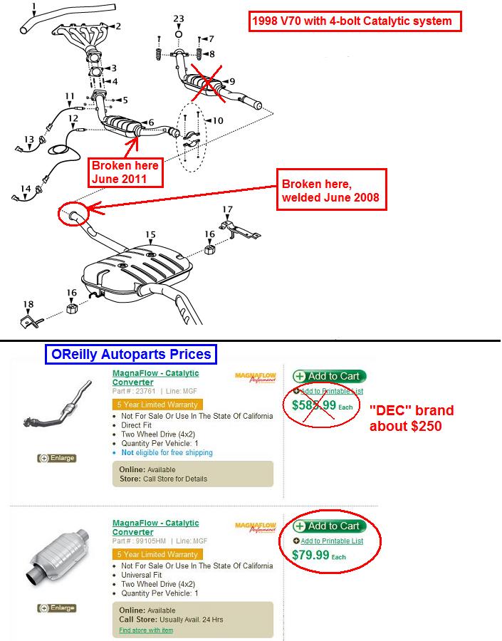

Now it leaks right after #6 (catalytic as shown). There is no more room to weld from my forum research.

Thanks in advances for all advices. Here is the pic that shows you what I refer to above:

Well,
The break is exactly as shown.
I was told that this cannot be welded because there is not much on the catalytic side for an exhaust metal sleeve to "bite on".
Any advices will be appreciated!

I have shown this to a highly experienced welder who said that he thought it would be possible. He would remove part of the 'fin' under the left side blue line as, in his opinion, it doesn't need to be that long and weld on a collar.

Actually, that picture looks very familiar! (it's the thread I started last year
.) The solution was to take it to Midas for a little $76 patch job. What the mechanic did was to weld a smaller pipe inside to give support, and then welded another one on the outside to seal it up. I'm on a business trip at the moment so I can't post a pic of the finished job but if you'd like, I'll do that when I get home this weekend.

Ive welded worse but its only going to last so long and most likely fail when you dont want, and depending on how soft that pipe is you may or may not be able to use a mig in that case it would need to be braze welded and it has to be sealed or the rear 02 is gonna get a bad reading and i dont recommend removing it as the front and rear 02 sensors need to see a difference or your Check engine light will come on, my '95 850 has 300000 kms on the original exhaust and just passed a test 3 months ago!
I've welded stuff like that before, and if it were my car I would probably grab my little lincoln mig and go for it. If the metal on both sides of that break is not rusted badly and it broke because of a bad seem you should be able to make it work. Welding a small sleeve or collar would probably give it more strength, but if its clean and in good shape it should weld up good.

The pipe looks to have thinned from rust but an inner sleeve made from a piece of pipe expanded to be a snug fit and then join and weld. After the splice is complete, if it were mine, I would add three ribs of steel 1/8 thick x 1/2 wide stood on edge for strength. That break screams stress to me and the ribs would mitigate the stress. If clearance prevents them bing on edge then flat would still be a huge reinforcement in that area. THEN you assure no stress by loosening any joints and then shaking exhaust and then secure all that was loosened.

As I mentioned above, I have owned many cars before and once the rust starts in the exuahst system, it just keeps going, so it is endless trips to the muffler shop, each time $100-150 easy.
I plan to keep this baby for another 8 years or so. So I am thinking the "best bang for the bucks" as the whole exhaust system is quite rusty (rear mount on tail pipe broke off etc.).
My thought now is to do it right and forget about this exhaust system for another 8 years LOL.
I did a little more research, so here it goes, any opinions will be welcome!
MUFFLER (PN 8631006)
- Starla muffler: $220 lasts about 3 years or so.
- Bosal muffler ($250): about 6 years.
- To my sweet surprise, I checked my favorite Volvo Waltrip in TN, the Volvo OEM muffler (which easily lasts 12-13 years) is ONLY $250!
---> So If I decide to get a muffler, then definitely go OEM.
CATALYTIC (PN 8602985)
- D.E.C. brand $500
- Bosal 099-6301 $330 from Amazon
- Volvo OEM $850.
So I kind of narrow down to:
---> OEM Muffler $250
---> Bosal Catalytic $330
Not sure yet, just pondering LOL.
- D.E.C. brand $500
- Volvo OEM $850.
