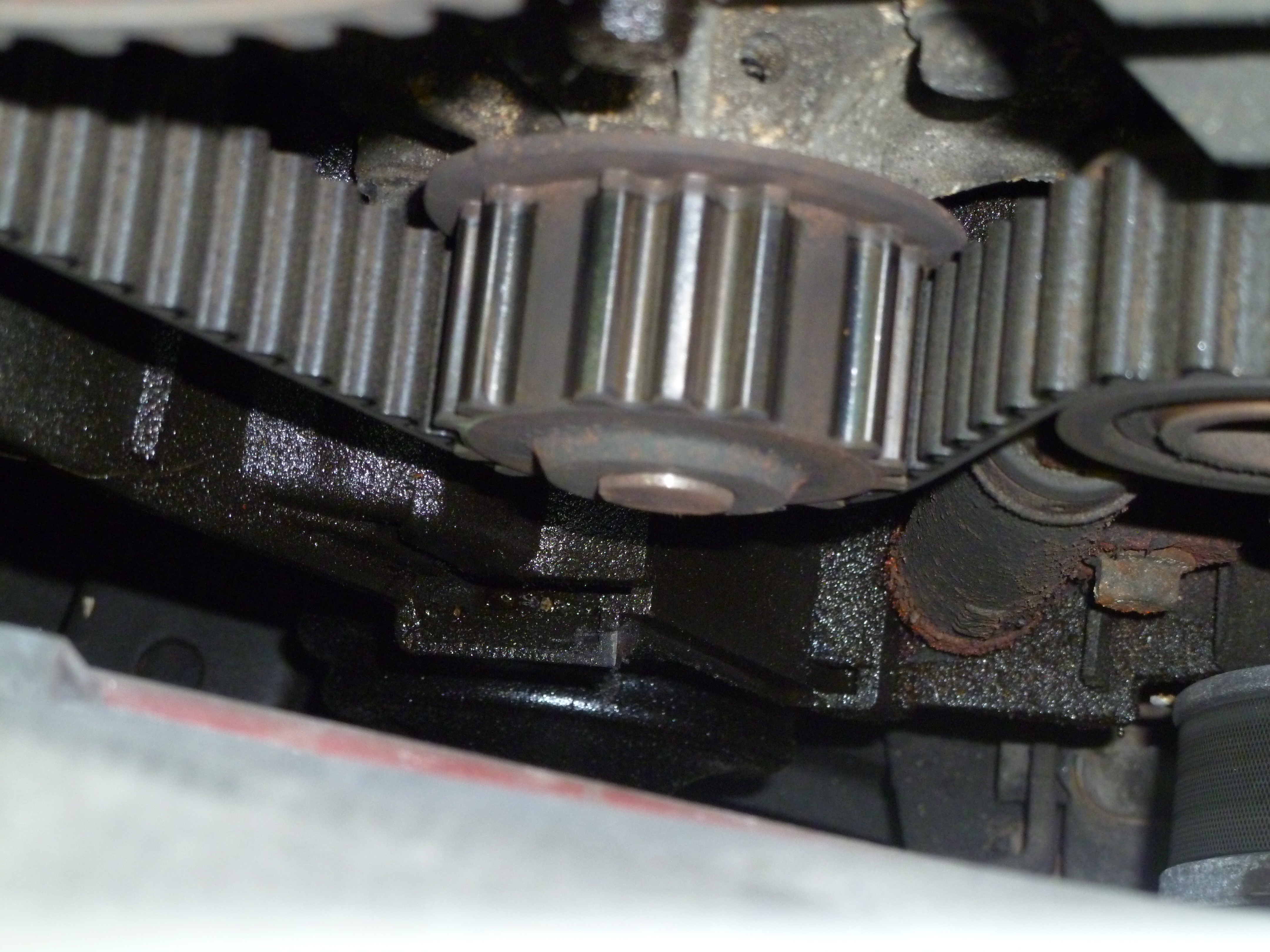

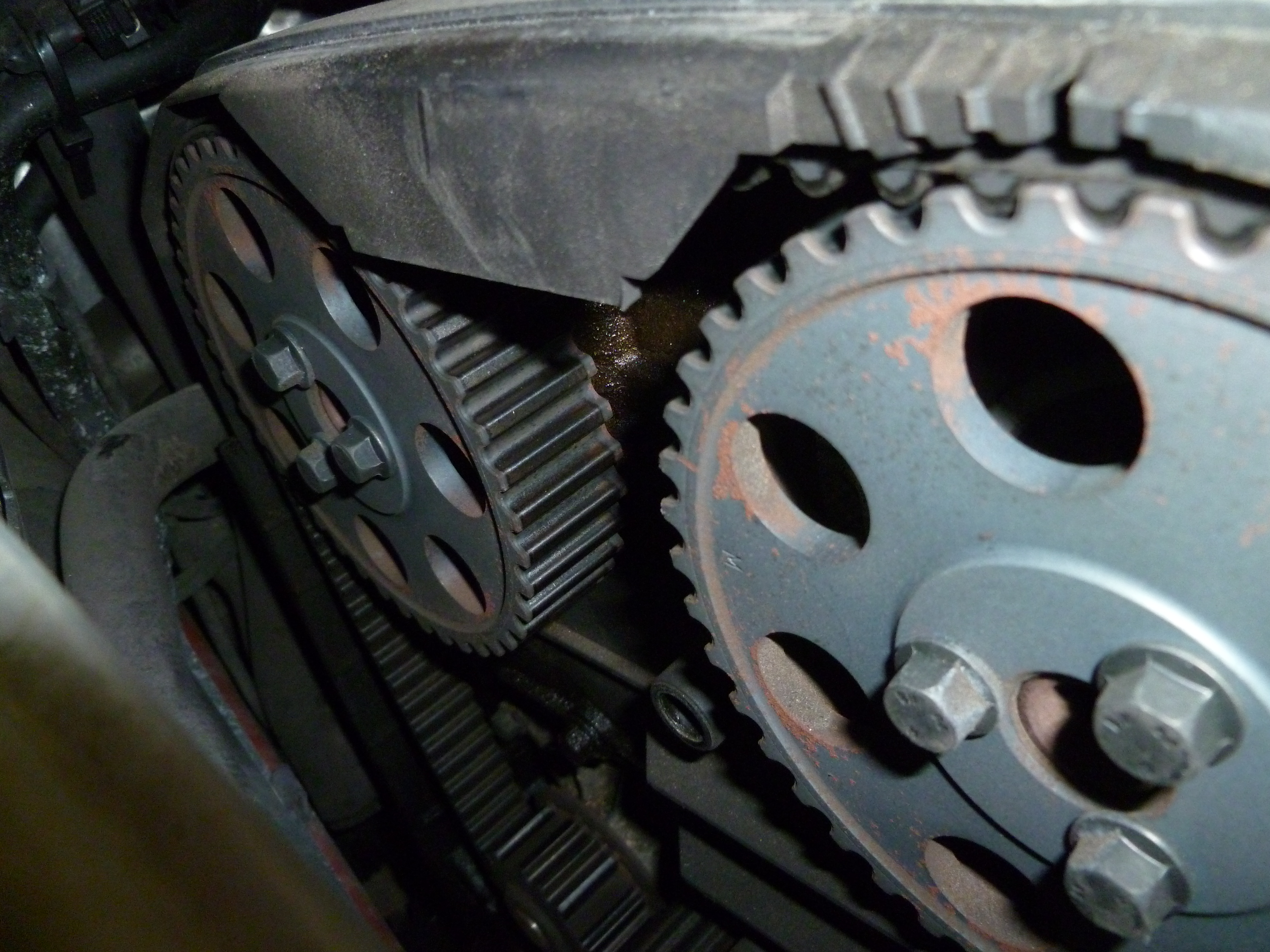

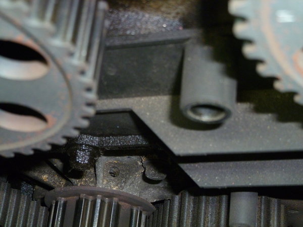

'96 855 that has been leaving ever growing spots in driveway for some time. I cleaned it up enough underneath to see where oil is coming from, and I could see some starting at the bottom of the timing belt cover.
Attached are some pics after removing the timing belt cover. I hope someone can identify the cause.
Thanks!

Front cam seals
- Posts: 11800
- Joined: 25 July 2009
- Has thanked: 292 times
- Been thanked: 765 times
Front cam seals is a good call but first check under the spark plug cover for oil. If the PCV hose (or the oil cap itself) is leaking oil under there, it often drains out the front side of the engine and down behind the cam pulleys.
If you have a leak up there fix it (change the cap gasket, do a PCV job) and see if that takes care of it. If it doesn't ... front cam seals.

When the cam seals went on my previous 855 the result looked very similar to your pics . Unfortunately for me some doughnut from the cars past had removed the seals before and apparently prised them out with a flat blade screwdriver : the damage was not pretty and the seal was never perfect . The leak was at the bottom of the seal and it was as though the effect of the cam spinning flung the oil straight down leaving no staining or drips on the front of the head .
