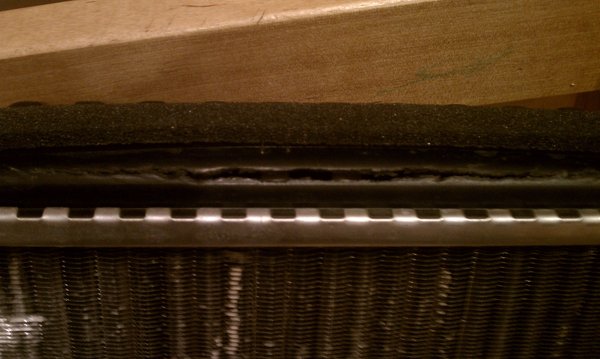

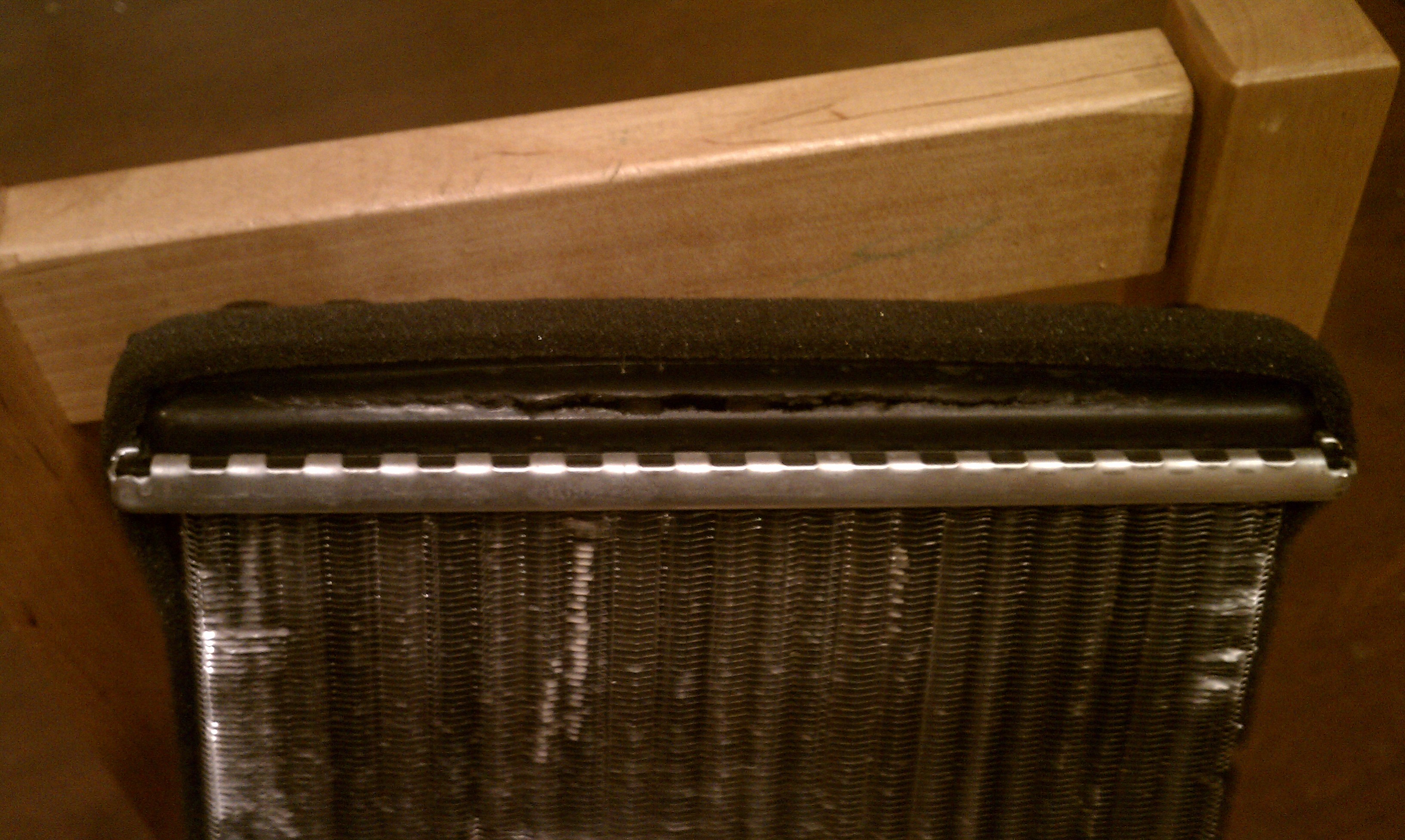

Yesterday, with my two little boys in the car, the windows rolled up and the A/C on full blast, the heater core literally blew its top. Suddenly, the vents were blowing hot steam throughout the car and directly in my face. Fortunately, I was in a parking lot when the core blew, not on the freeway. Last night, when tucking my son into bed, I asked him what he remembered most from the day. He said, "The part when the car blew up. That was scary."
When I pulled the core, I saw that the top of the plastic cover had just blown out, leaving a crack the entire length of the case.
Flat out, this thing is just plain garbage, not built for the extreme pressures of the system. Do yourself a favor, buy the OEM heater core...

Andrew,
I own a business myself. As such, I very much appreciate the swiftness with which you responded to this post and the concern you expressed. It's beginning to look, however, like the higher ups are wanting to make this an operator error type of situation. Which, again, I can understand. Some of my clients are so brain-dead it's a wonder they can tie their shoes in the morning. And these are very successful people!
Here are two pictures of the rupture, at the top of the core, at a corner (a notorious weak spot in casts). I encourage you to draw your own conclusions as to whether this was an operator error, or a manufacturing error.
