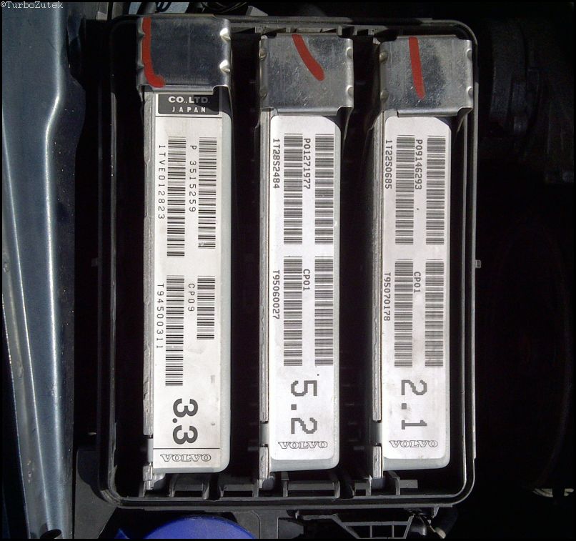

TCM Ver 3.3
TCM Ver 3.3
Auto Trans TCM.jpg (113.94 KiB) Viewed 7166 times
I have TCM Version 3.3; most of the cars I've seen in the scrappy around here have a higher version (5 something) in this slot. Anyone know the differences?

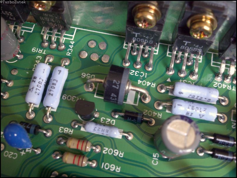

Anyways, I removed the unit to get at the connectors below and couldn't help but notice how simple it would be to open up and inspect... Almost like the designers wrote an invitation on the box!
Inside I found the capacitors to be in good condition visually, though I did find this:
Diode with dry joints.
Auto Trans TCM PCB - Diode.jpg (106.43 KiB) Viewed 7166 times
It may or may not be relevant to the problem, but these solder joints on this diode didn't look too clever and ready to cause all sorts of intermittent nastiness, if not now then soon! I scraped away the conformal coating with a fibreglass pencil and re-flowed both these joints with lead solder and flux.
Other than that, I could see no faults with the TCM itself - all the caps looked OK and the switching transistors were all within spec.
That out the way, I resumed the trouble shooting on the car side of the problem.
My solenoid resistances are as follows (I got these from the connector under the TCM, to give a better picture of any cable faults which might exist):
LPR Solenoid = 7.2 Ohm
S1 and S2 Solenoids = 15 ~ 16.8 Ohm (the fluctuation here is probably just my meter and the way the probe sits in the connector)
LCK Solenoid = 15 ~ 16.3 Ohm (as above for the fluctuation)
I measured all of these to the car chassis ground, except the LPR which has its own ground pin (I guess this is a PWM solenoid?).
So, do these values seems healthy or out of spec do we think? I recall reading that the factory spec of the solenoid should be about 15 Ohms for the S1 and 2 units but I can't find values for the others. At a guess I'd say they are probably all OK electrically?
Chris...
