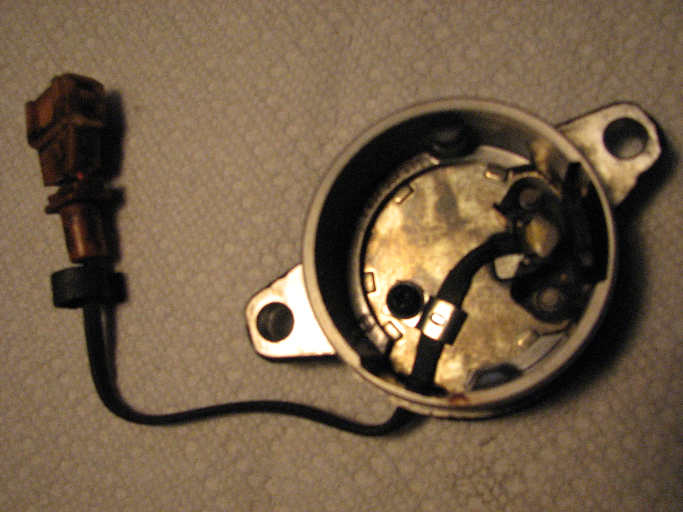

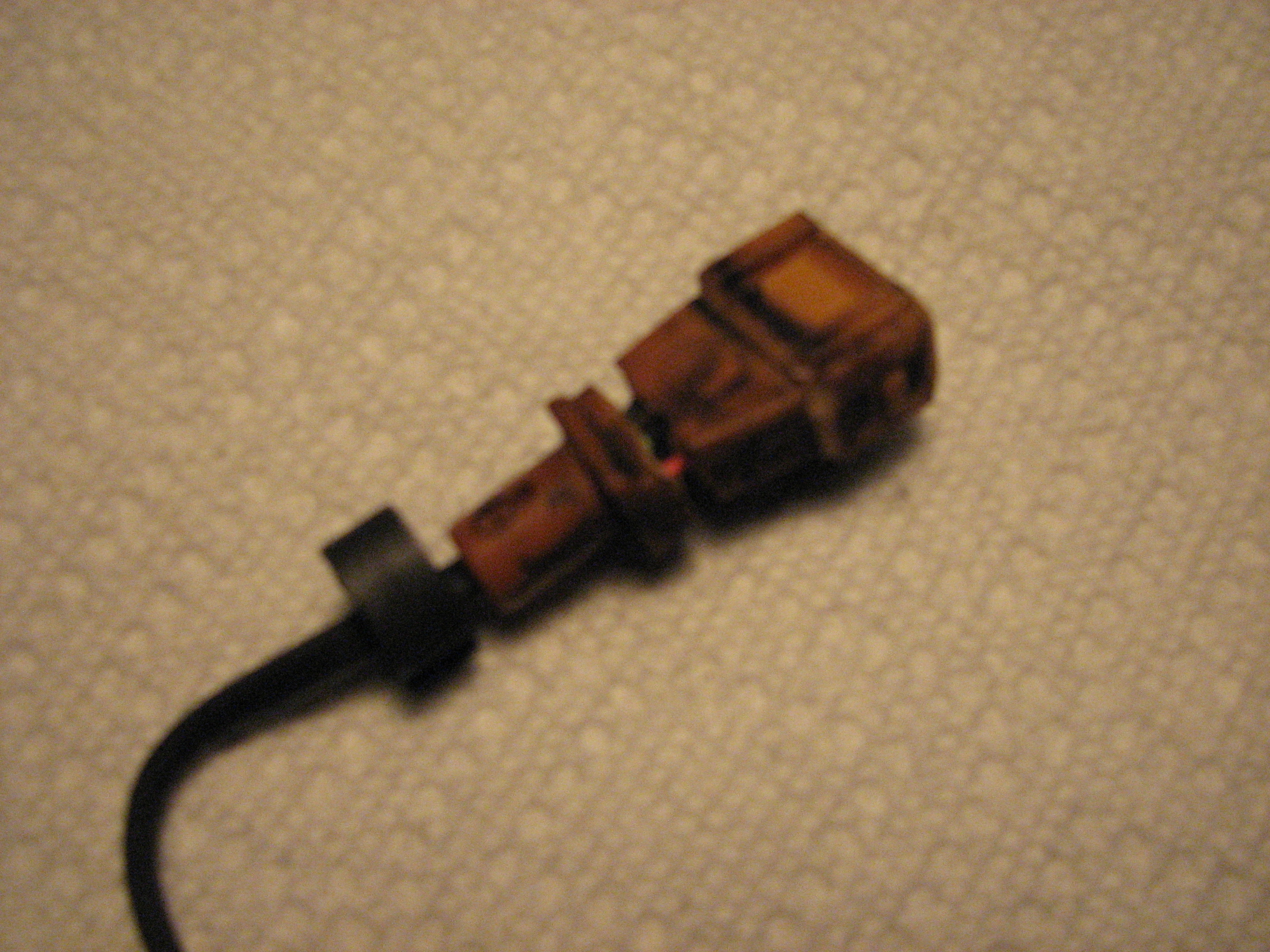

Unfortunately, I dealt with these issues earlier this year, and it was time for most of the items in the first list i.e. wires, rotor and cap.
All is well now, but I am glad I was working around the distributor area or there would still be another ghost.
What I did come across, was a cracked connector to the cam position sensor. This was the likely culprit in the wet weather issues. (Aside from 20 year old plug wires.)
