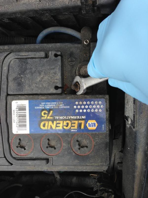

Remove Negative Battery terminal, after finding radio code.

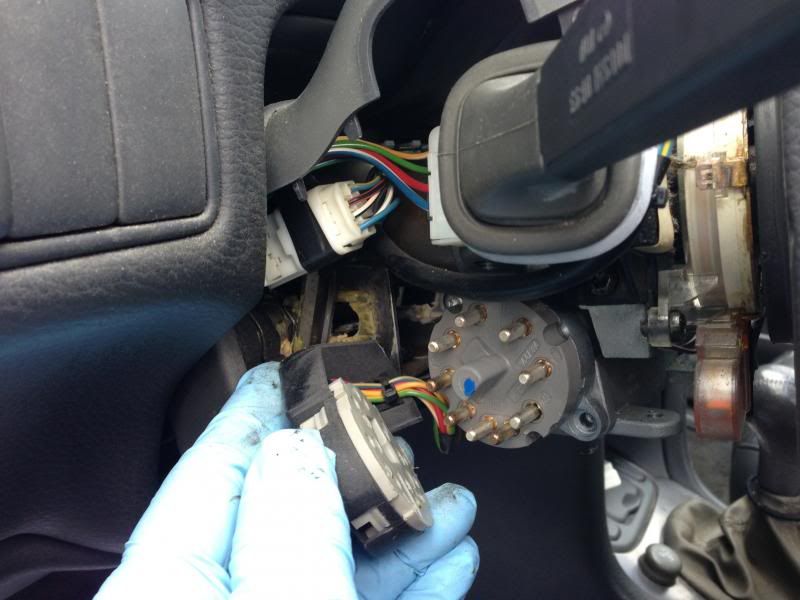

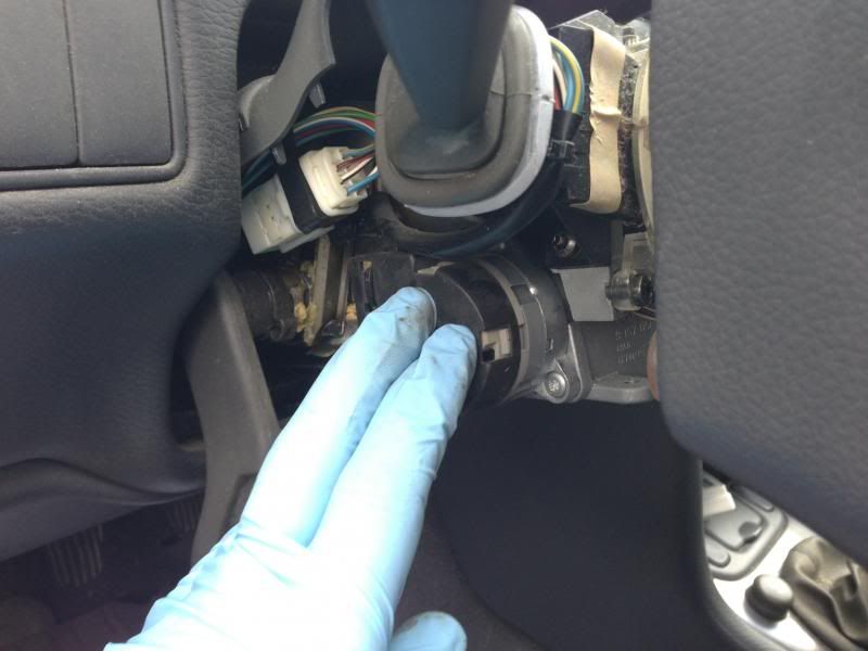

Now remove electrical connector, just pull firmly to left. Remove two Torx 25 screws holding in switch (forget to photograph this, sorry. You can see screw holes in the picture.
New switch will go on only one way - note lugs on switch that pick up lugs in casing
Push new switch on firmly, there should be no gap between electrical switch and mount, as shown. Replace 2x Torx 25 screws before reinstalling electrical connector.

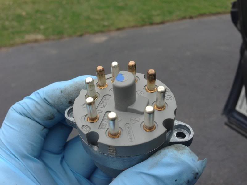

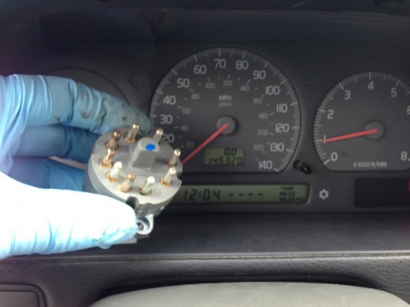

Inspection of old switch - source of intermittent electrical problems pretty clear here..
Hopefully to last another 145,000 miles
