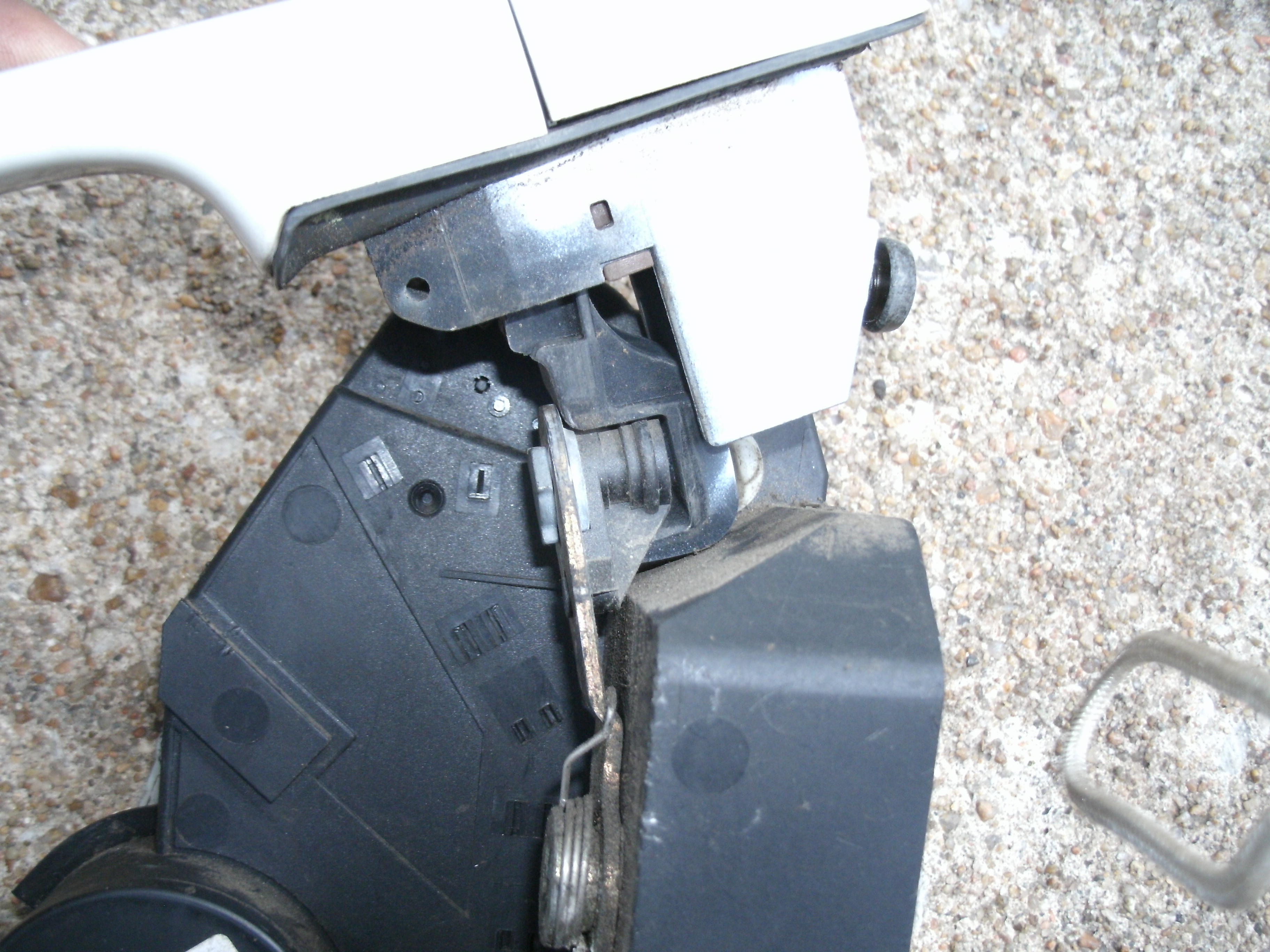

Here are the pictures.
This is the side of the latch that faces outward.
The circular white plastic area is the hole where the rod from the lock needs to engage.

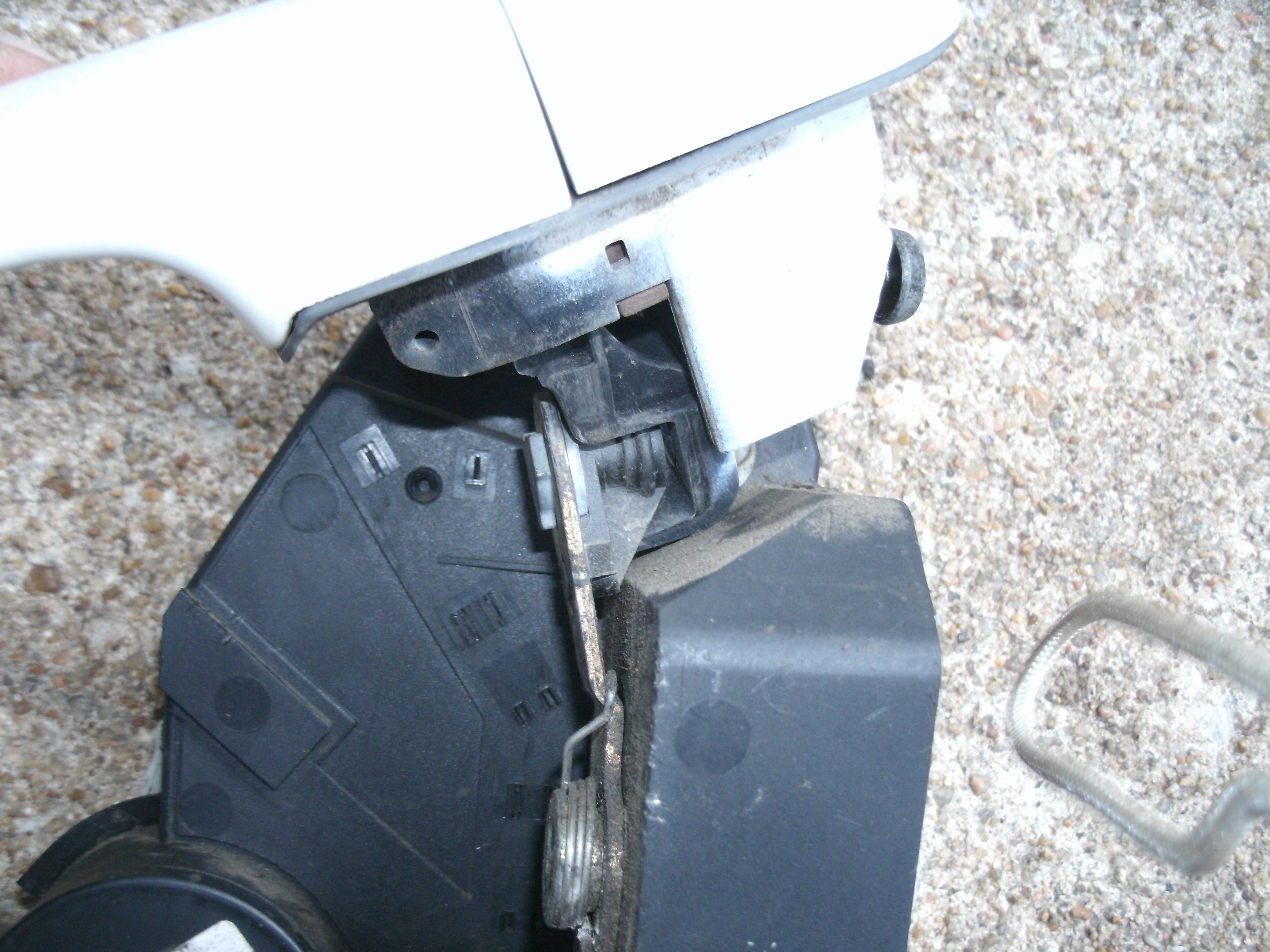

This picture is of a front door latch but a rear door handle. It is slightly different and doesn't have the key cylinder and rod but here is how it needs to engage the latch mechanism.
In this picture I turned the handle to give you a better view of how the handle and the latch mate up.
Hopefully this will help you along the way.

Lee, Thanks for your help on getting my door back together.
I spent a little bit of time this weekend, but was cut short as the rain set in. Finally, was able to get back to it today and spent about an hour or two this morning getting everything back together on my second attempt. The trick was to get the handle seated properly and to remove the lock cylinder before resetting the exterior handle. Everything back together and working. I wasn't sure what kind of shape I was in with a door that wouldn't work and an alarm-immobilized car.
