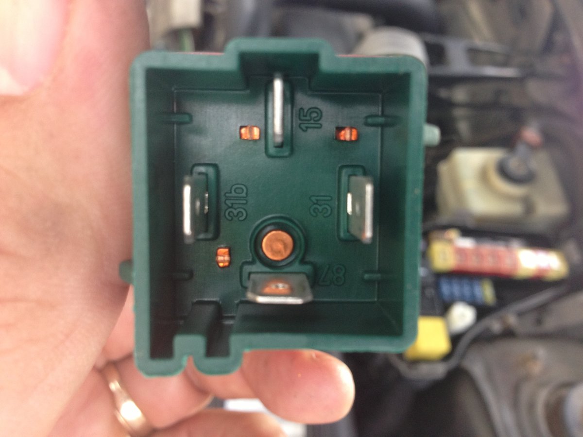

Amy - If you can find the fuel pump relay, pull it up and look carefully at the plastic around the connections - you will see the labels 15 and 87.
The safest way to jump is to make up a wire with the two spade lugs and a fuse so that you are sending the voltage direct from the 15 to the 87 terminal, instead of through the relay.

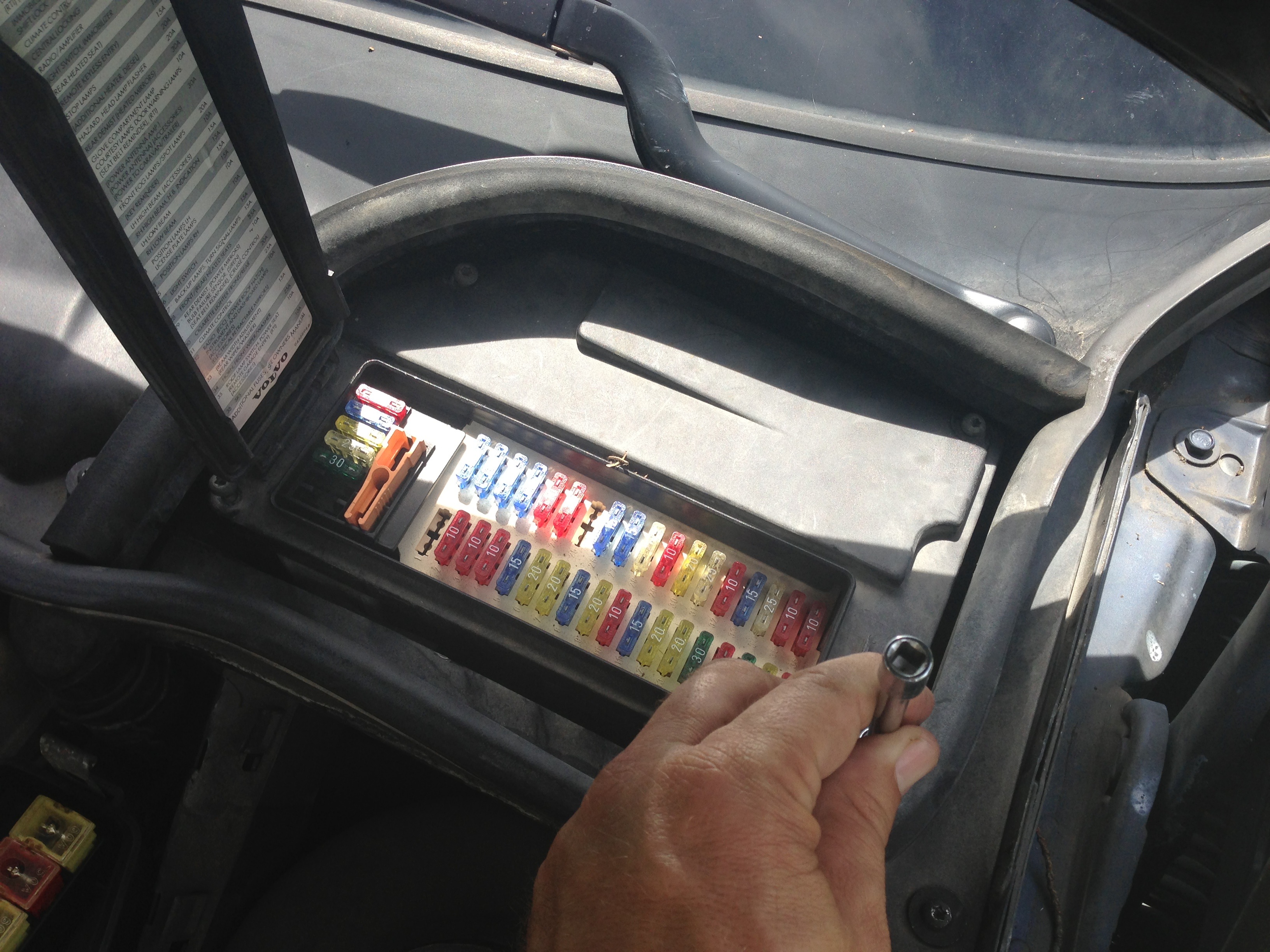

Open fuse panel directly in front of driver

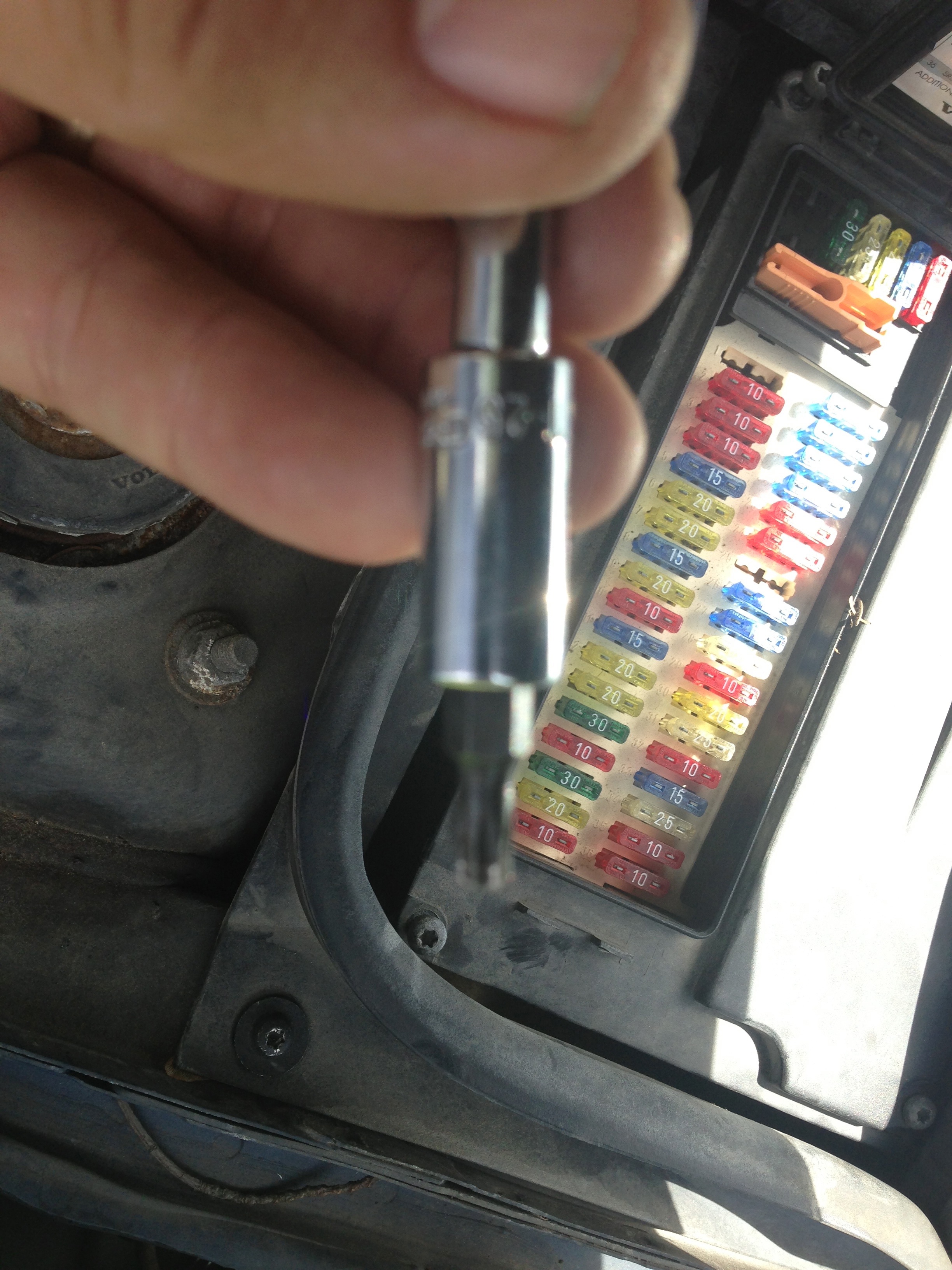

Remove four Torx T-25 screws from top of fusebox cover

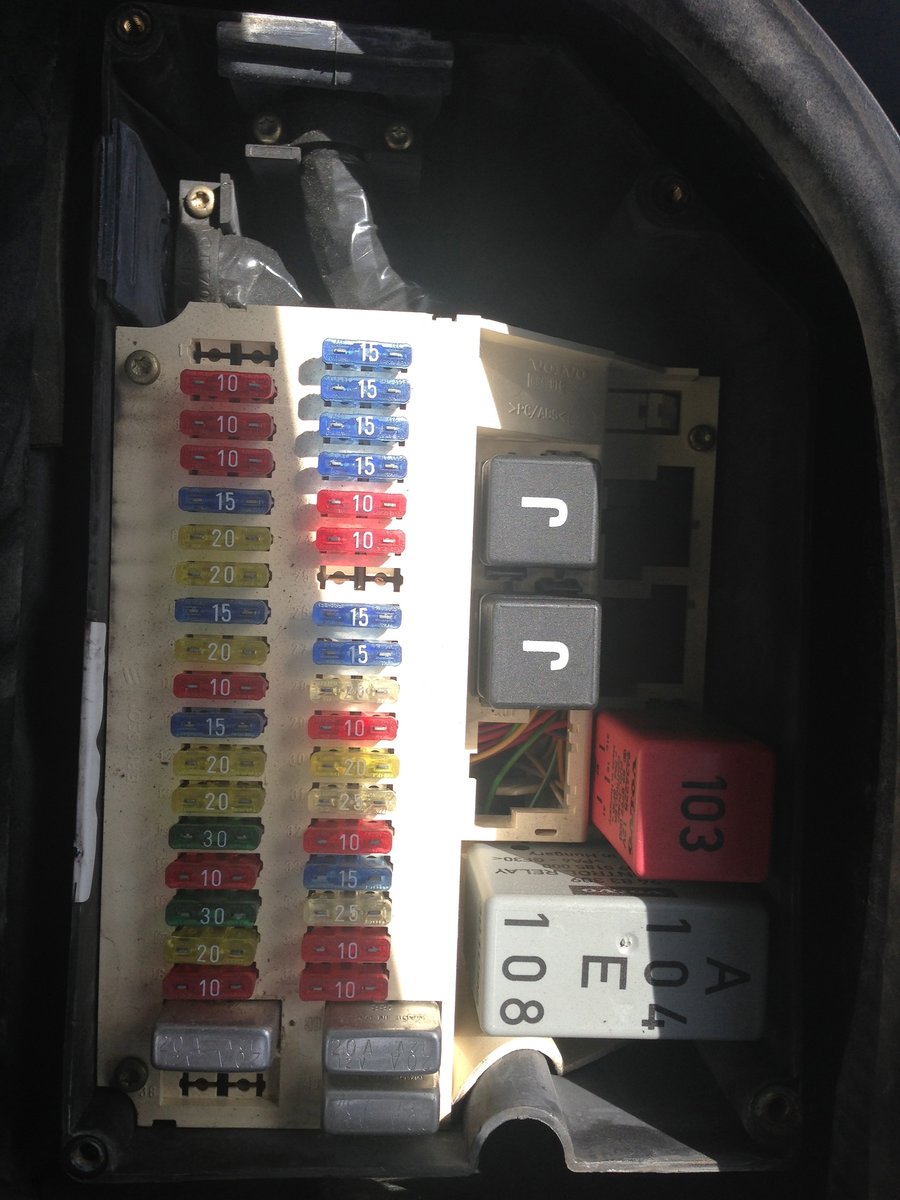

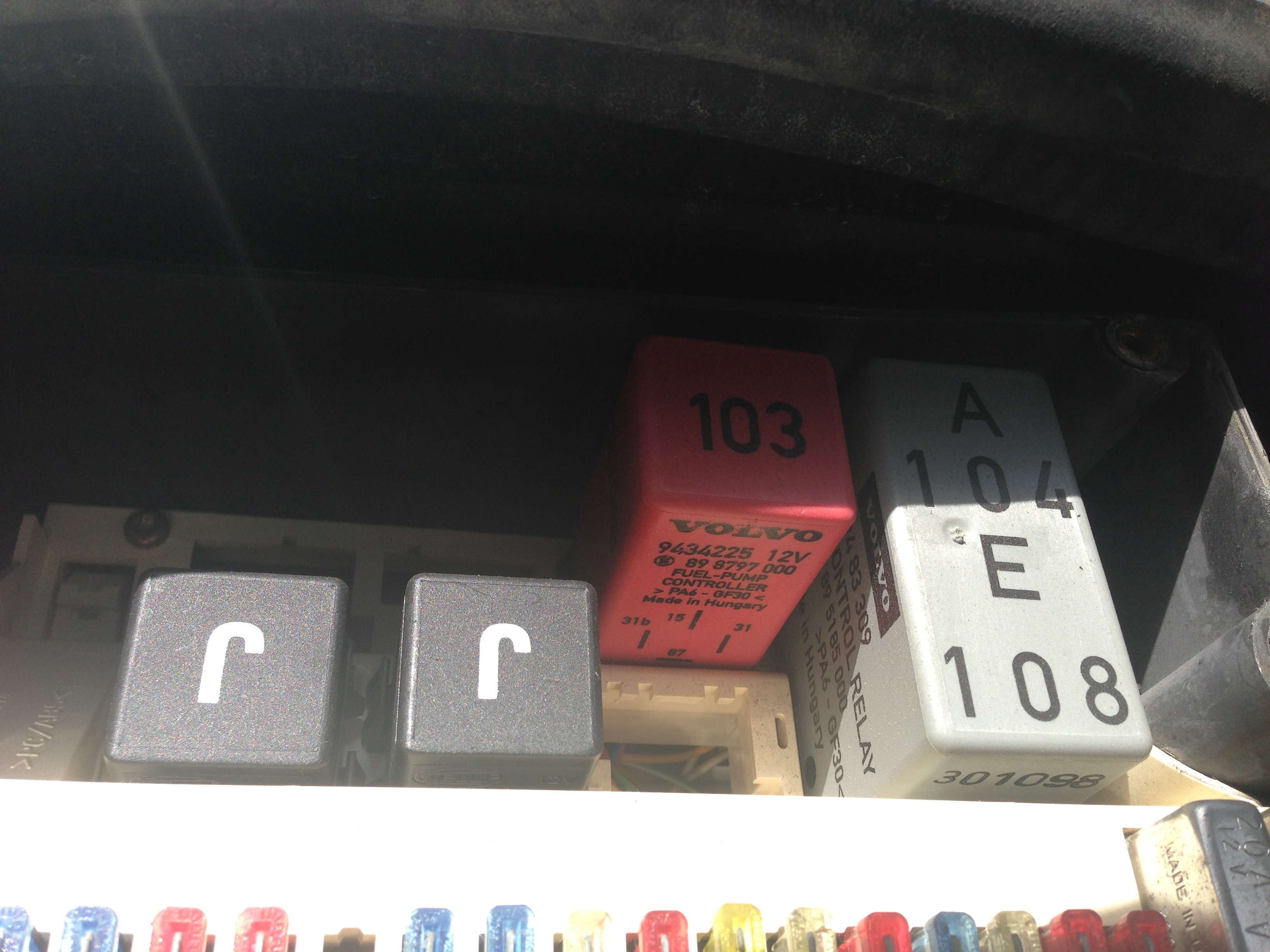

Find Pink Fuel Pump relay, labelled "fuel pump relay"
Pull up to remove. It will only go in one way.
Look at bottom for terminal connections - remember to turn them in your head to ID them in the relay holder. You can use a paper clip to carefully connect the 15 and 87 terminals in the fuse box. Watch out as the paper clip can get hot from the current going through it - use pliers to pull it out when done. Put the clip in with the ignition OFF. Turn OFF before removing.
