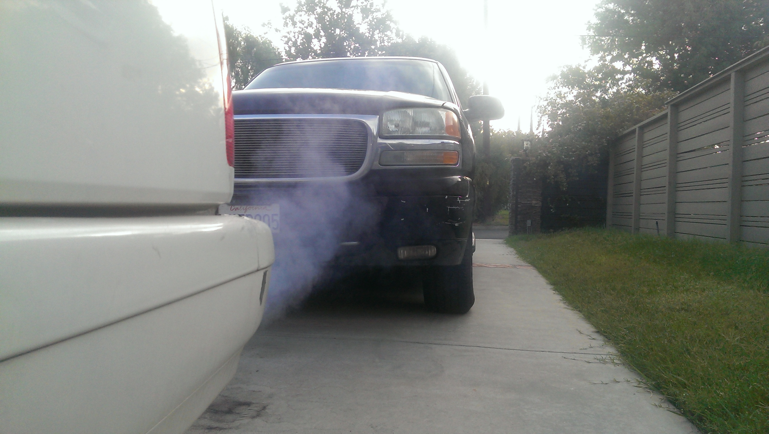

Hello all, I have a 97 850R wagon and am trying to diagnose blue white smoke clouds from exhaust.
Car was run low on oil (where it went? My daughter doesn't know), no puddles in driveway, slight loss of coolant (reservoir down to min. from max.)
Did compression test, psi results as follows,
Dry, 155-162-165-167-162
Wet, 181-185-181-190-185
Really hoping valve stem seals were the culprit as I was planning on replacing the head gasket anyhow, but these (substantial?) increases in compression concern me. Would prefer to leave the lower end alone...
That being said, what's the next step in diagnosing if it's an upper/lower problem?
Thanks in advance

Thanks for the quick response JD, smoke output is like comparing a cigarette burning in an ashtray to a mosquito fogger...
Will try to capture some vid.

I look forward to the pics/video
I think you are saying it gets worse as rpm increases.
